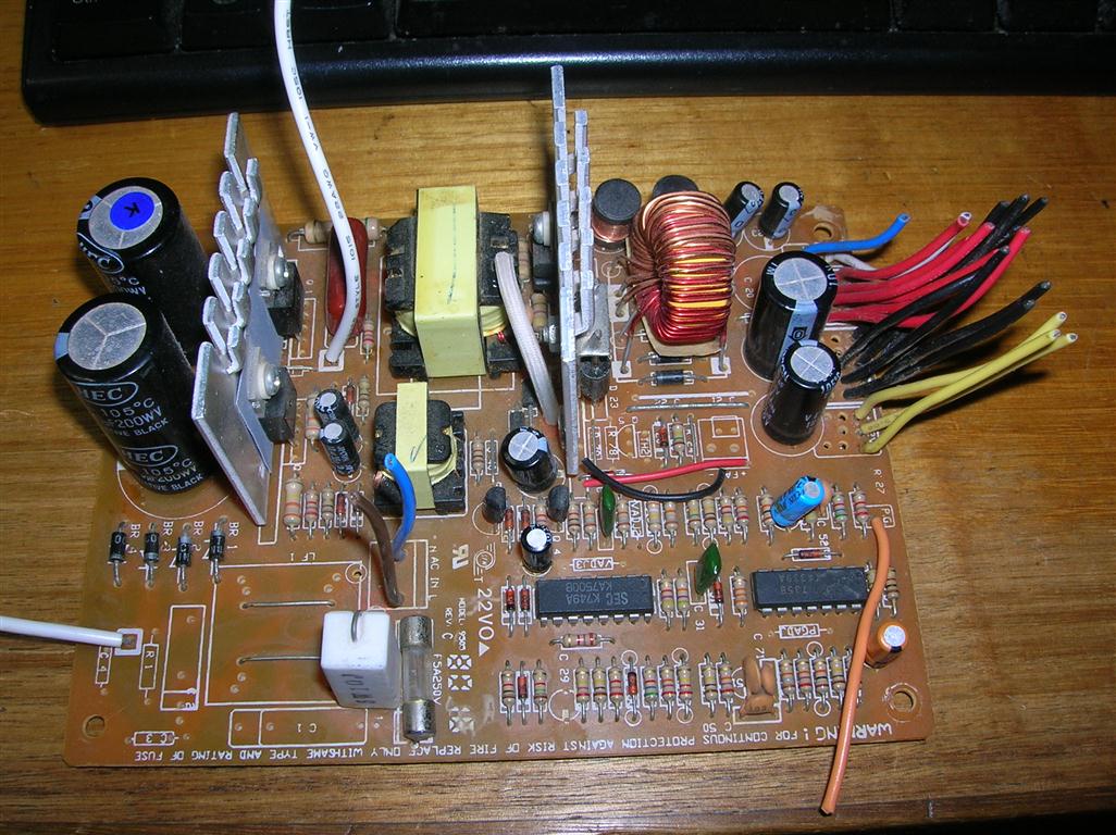

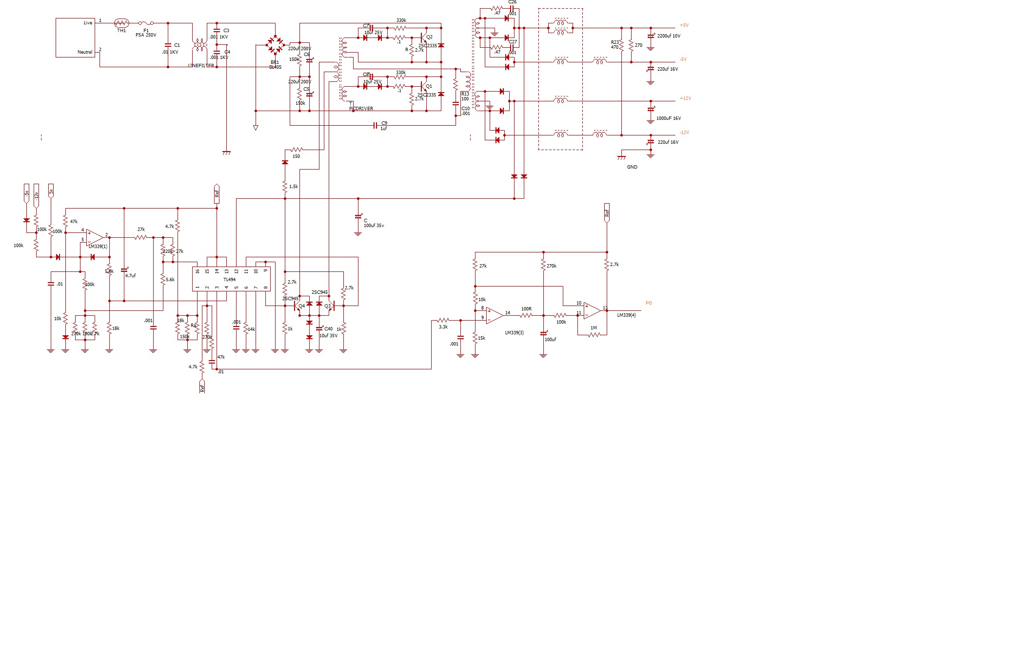

    This is an interesting project TH3, I want to do something similar, with about the same quality supply. Please keep us up to date.
    Tom and PeteS, I have to say that I'm a bit surprised to see the 220k from the mains live go to the startup cct for the supply. That breaches the "cold" zone by a mains lead into it. I don't think I've seen that before with the driver control in the "cold" zone.
    I wouldn't be surprised if that wire from the 220K was supposed to take a right turn to the collector of Q1. It has after all, got a winding on the driver transformer, that should provide the required startup pulse.
    I can see the 330uf that you refer to, I wonder if that would charge quickly enough to power the 494 rail for start up, I somehow doubt it.
    What are you going to do for current limiting? The supply that you are using has, like mine, no current limiting. I'd be interested to see.
    Cheers
    Greg
      Re: AT PSU mod - take two!
      Dunno where you read that it goes to the cold side. The 220k is between base and collector of Q1, which is on the high side of the primary DC bus.
      For current limiting i will be using a shunt and an opamp to amplify the small voltage drop of the shunt to something the 494 can read. Something like this oughta do for the shunt resistor. I will be using 10mOhm. For the opamp, i believe i'll be using the MC33078.
        I don't think I explained that very well. I was looking at the start up resistor R2 on the Seven Team power supply. It goes from the non-isolated side to the switching transistors, which I thought were in the isolated section, but of course they are not.

            Regarding current limiting, it is typical to use either the spare amplifier on the TL494 or the DTC pin (4). You can always add a primary current limit with a current transformer. The not-so-crappy AT PSU have one. They usually are configured as latching, to DTC pin.
            For sensing I have been looking at the ACS712 modules. Affordable ($3.20), isolated and very low resistance (it can even be ignored) makes it a pretty interesting candidate
