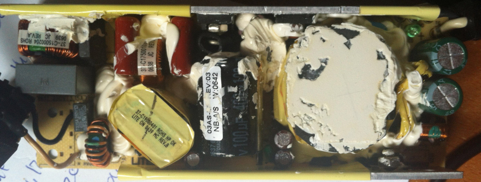

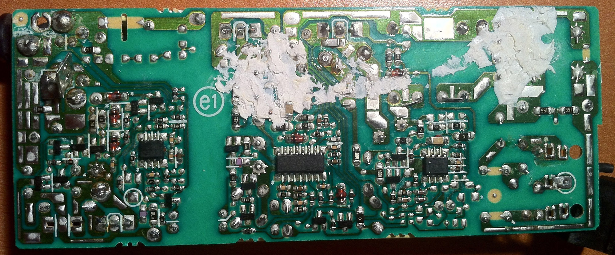

    hi fellas,
    I've recently been given a supposedly faulty laptop by a friend. In fact it was the PSU that was malfunctioning.
    It's the first time I crack open one of those "power brick" and I was amazed by how "packed" everything was. Furthermore, the added isolant/glue whitish thing really doesn't help figuring out the PCB's layout.
    LITEON 19V - 4.74A
    MODEL: PA-1900-03
    It makes a weird beeping sound when connected to AC.
    - Main cap reads 320V,
    - the 3 tiny ones near the main cap read 10V
    - the 2 green caps on the right, i got 0 on my DMM, I think that the current isn't even going up to there (they seem to charge with current when I set my DMM to diode tester and then quickly set it to 20 DC to read voltage)
    - the fuse near the power plug is ok (0.5Ω)
    - secondary (or is it "primary"?) winding keeps changing value from 0 to 0.3V
    Here is a youtube video of the said noise: http://www.youtube.com/watch?v=CMyPDSPI20k
    Could you please tell me what I should do next?

    I have the innards of a very similar HP laptop charger. I would check for shorted diodes on the secondary and replace the startup cap. These things bake their caps alive so it might not be a bad idea to replace the Taicons too.

      The taicons gotta go... No two ways about that.
      Once that is done, see if the noise is still there... if so, then it is more than a simple cap issue.
