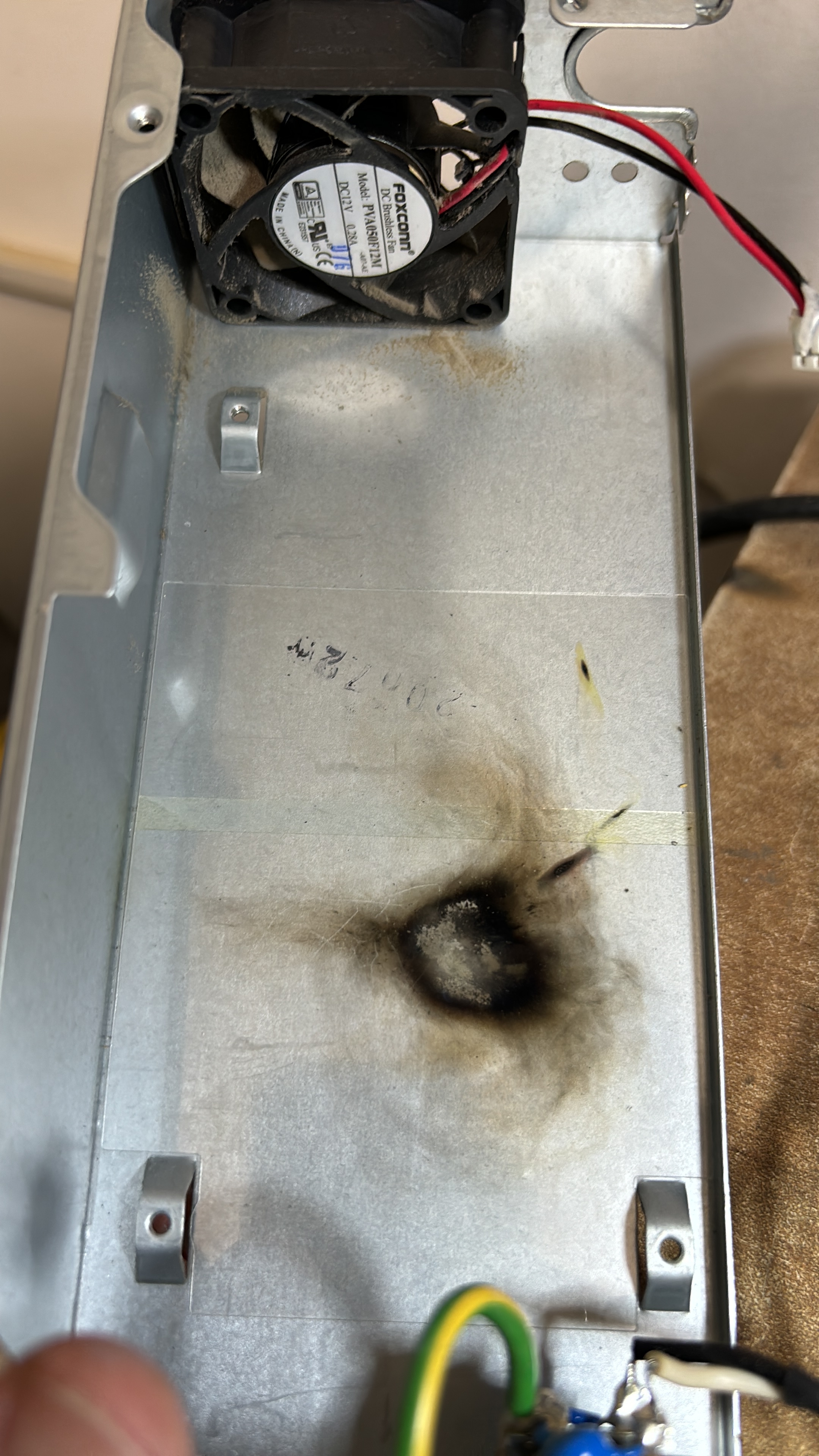

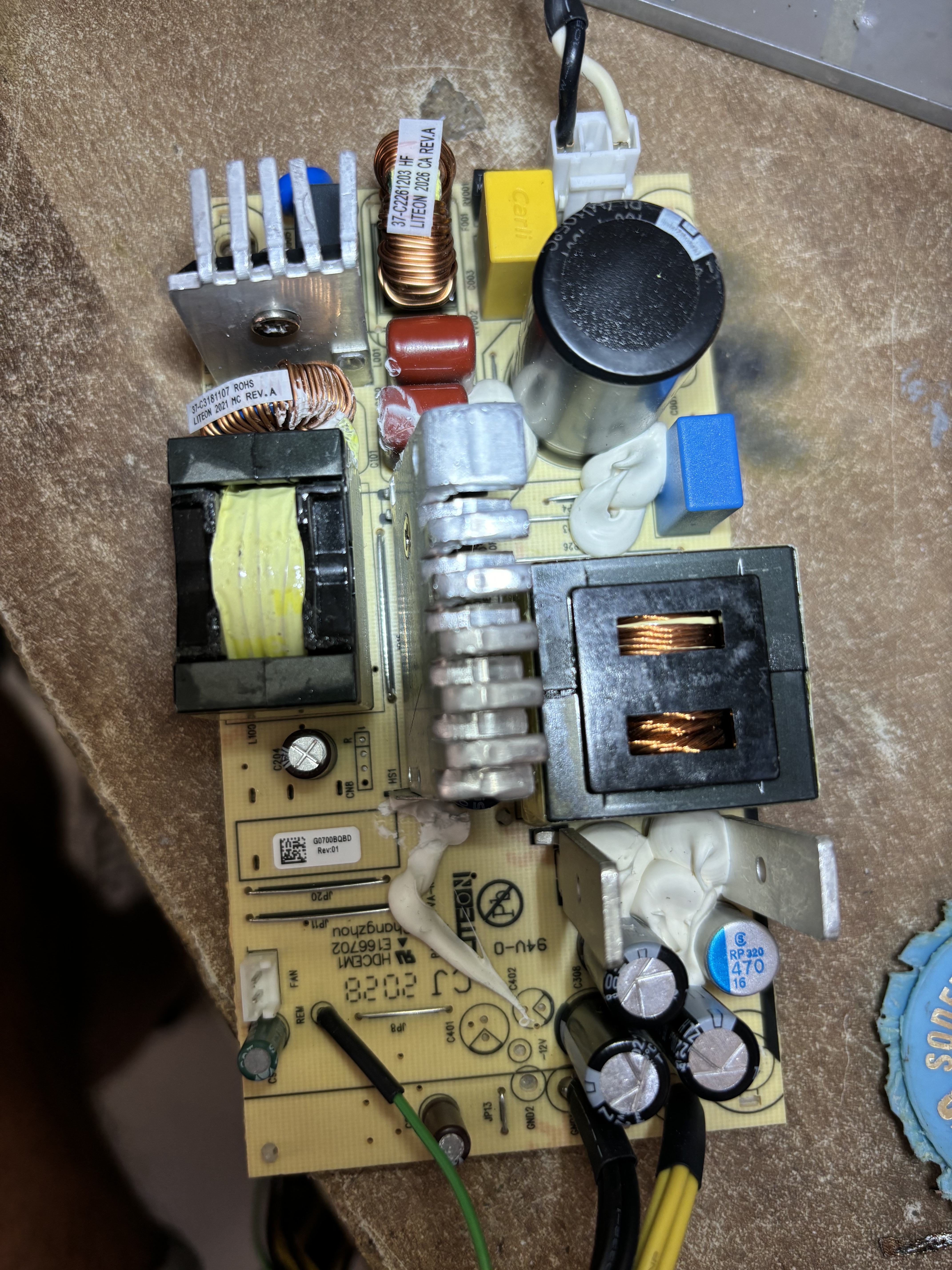

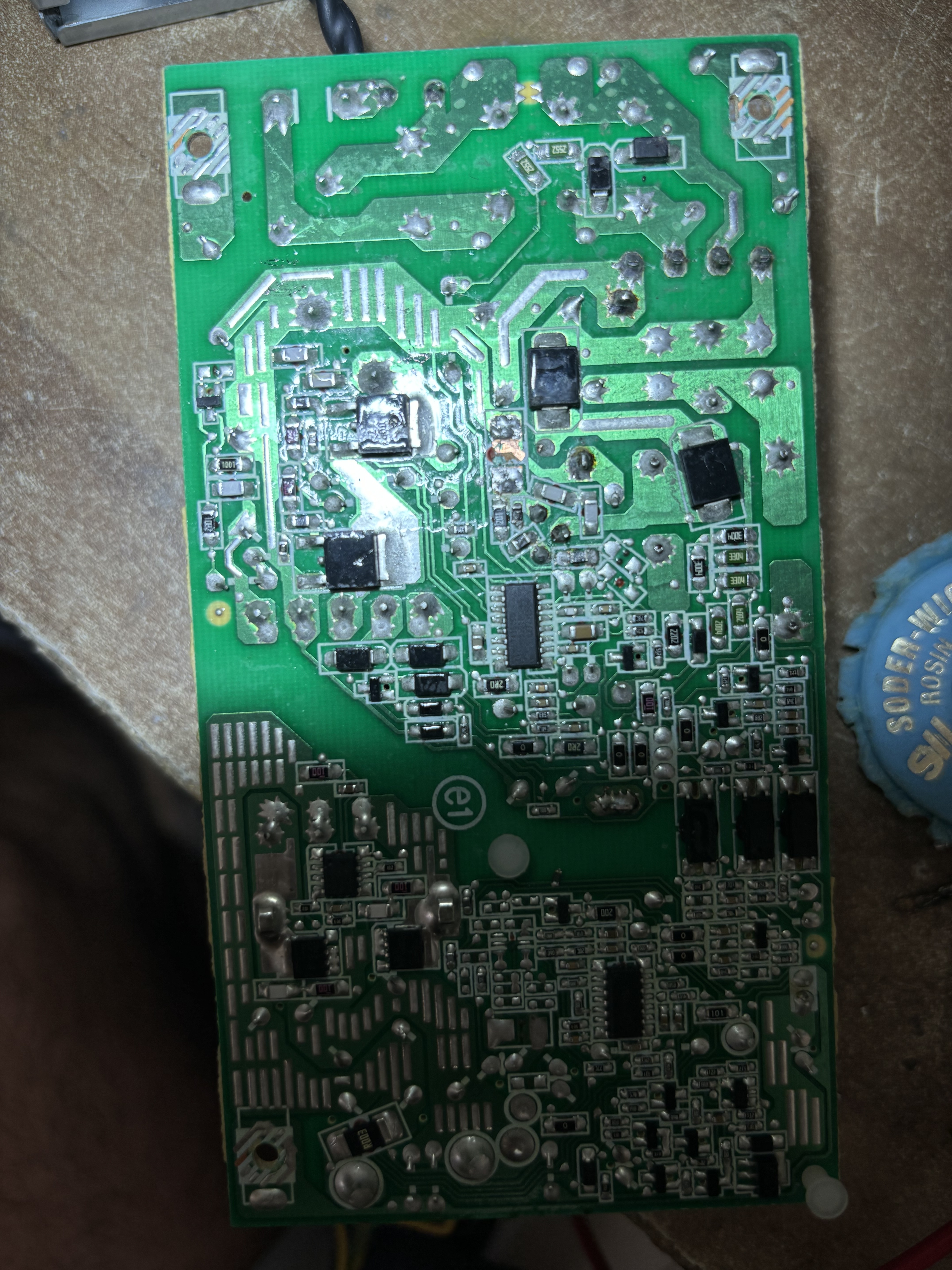

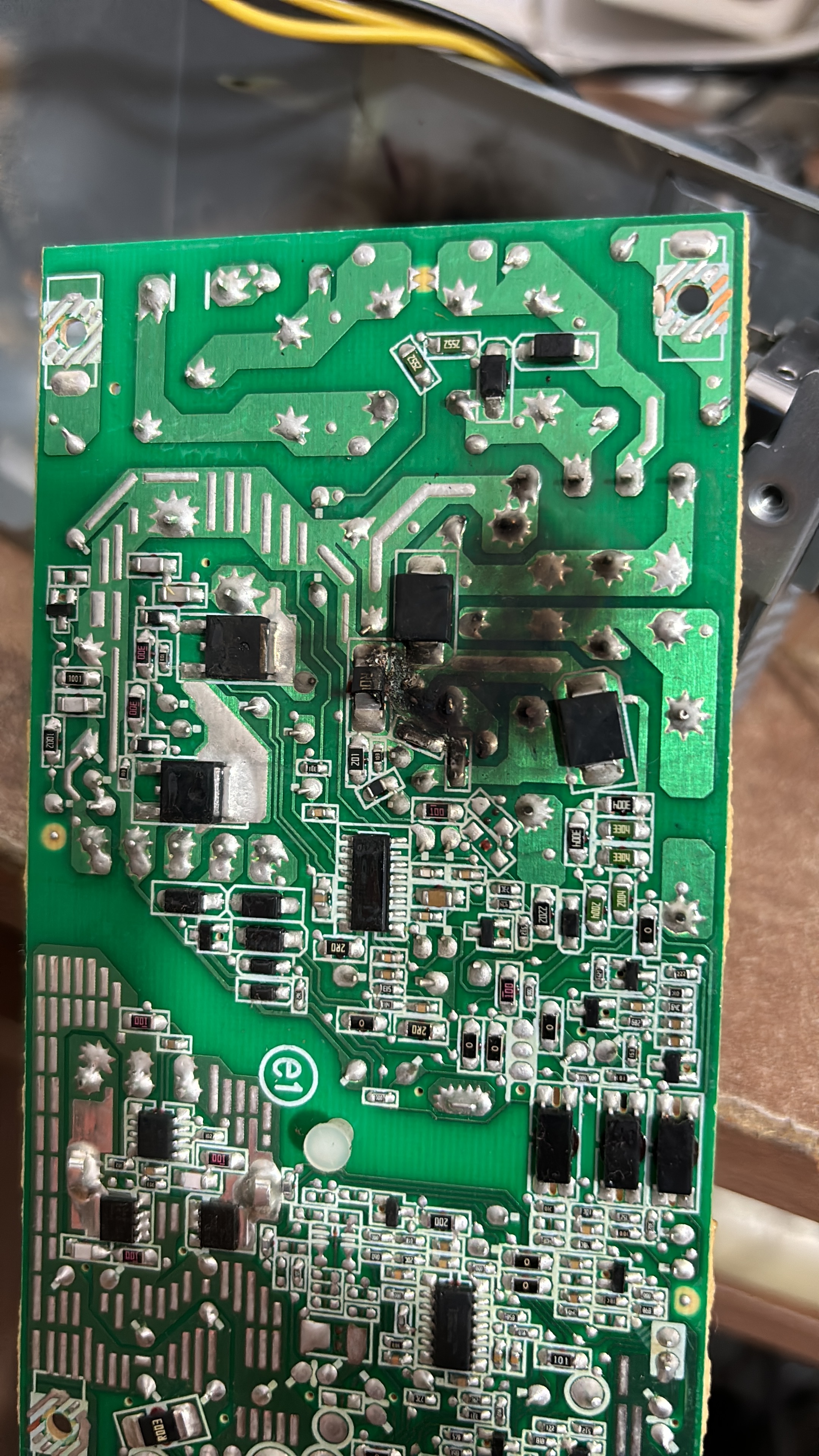

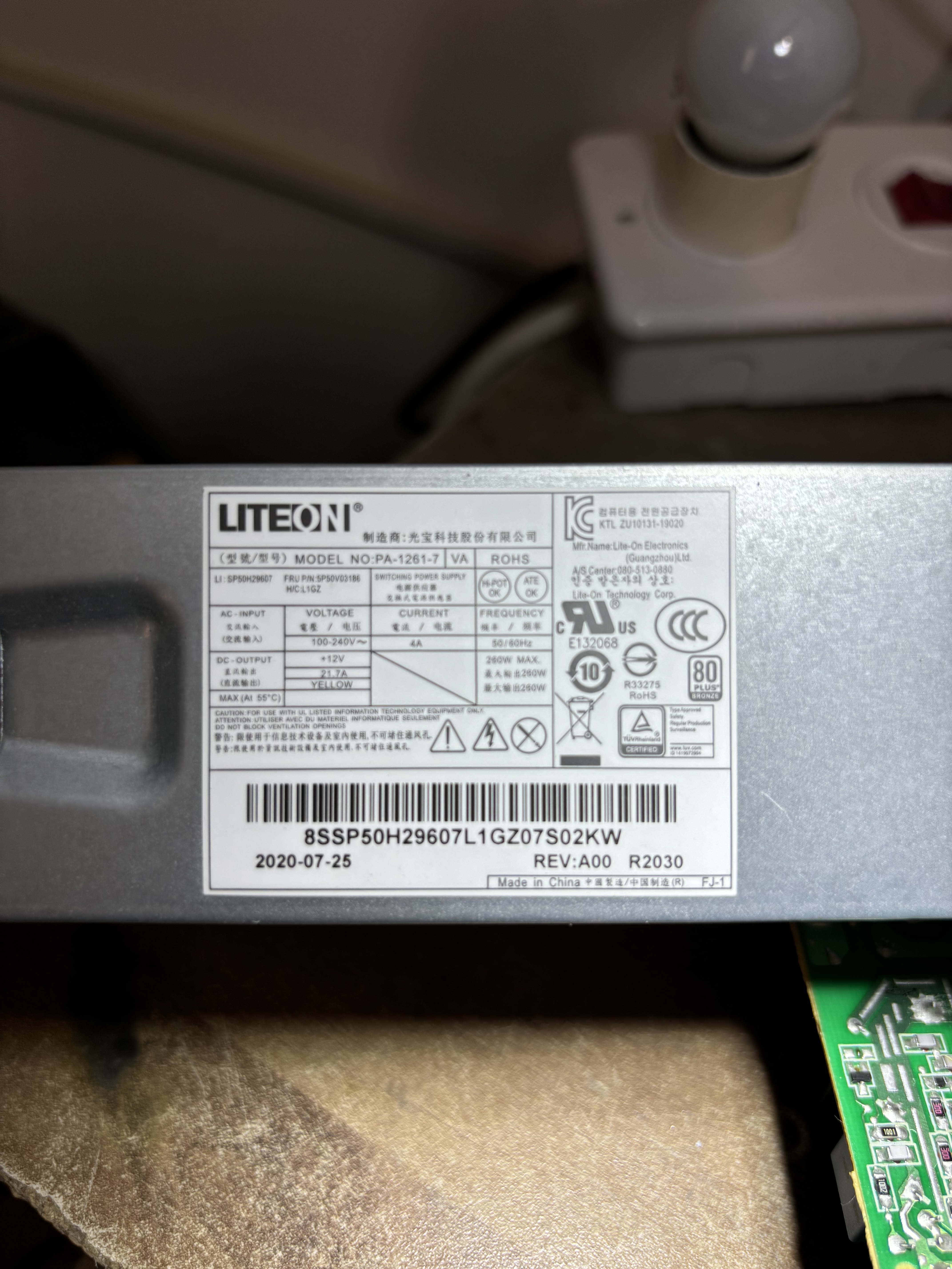

    Hi Guys,
    Trying to save this PSU from going to the bin.
    PSU was found dead:
    1.. Main fuse blown
    2. Main switching transistor shortes
    3. rectifier bridge shorted
    4. low ohm resistor blown
    replaced all of the above (resistor was replaced with a. Thin wire since i don't know what was the original value)

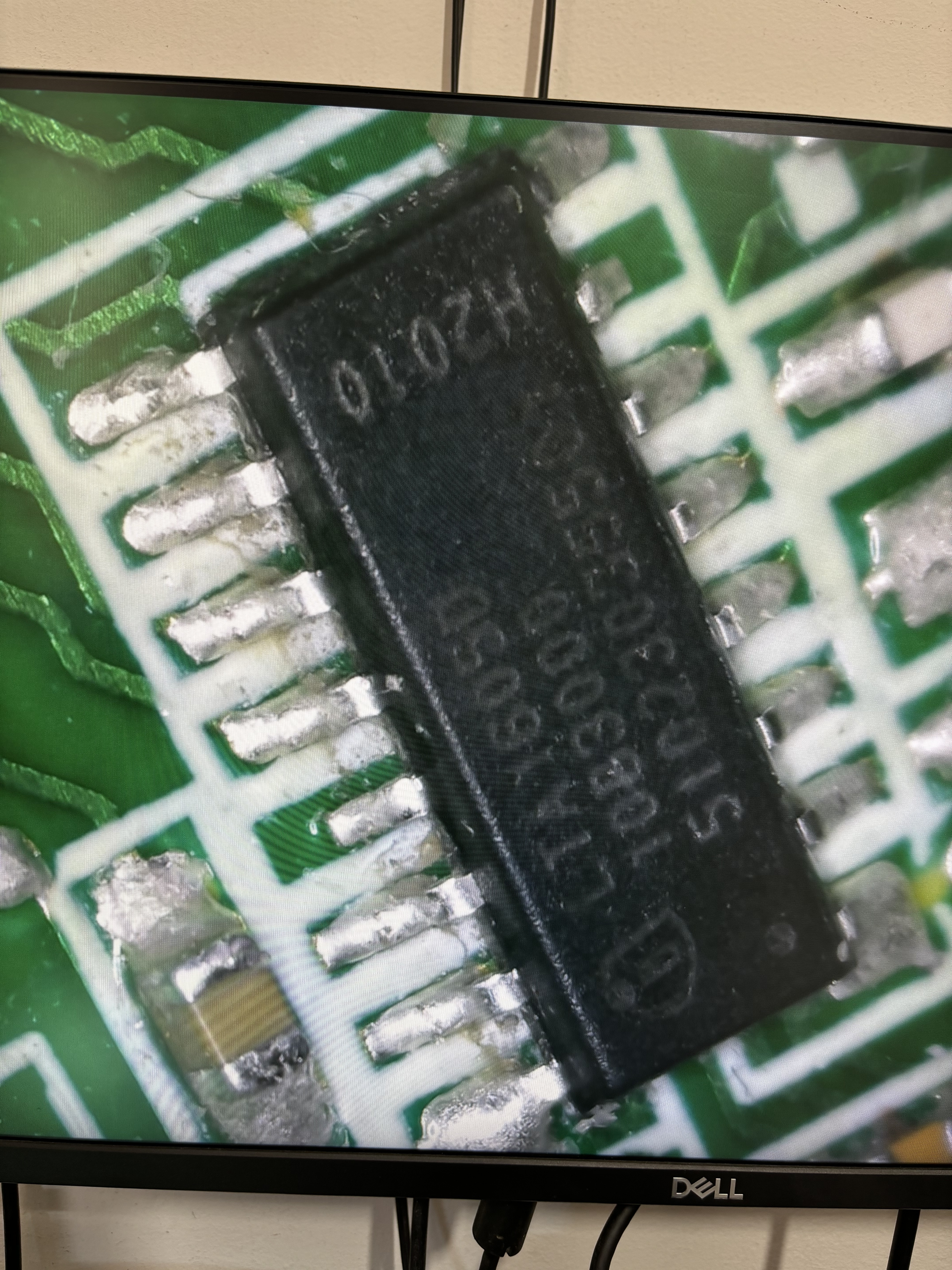

    Have 330v on main cap. But standby is still not right.
    maybe the driver chip died?
  • CapLeaker
    Leaking Member
    • Dec 2014
    • 8352
    Could very well be. After all the gate drive of the MOSFET got full power once it shorted out all 3 pins.
