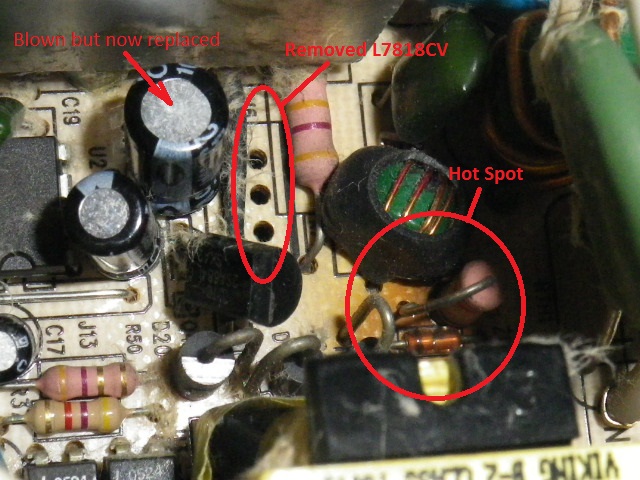

    Hi all, I have an Antec Truepower 2.0 550W PSU which wouldn't start up. Took the cover off and found some erupting caps, so decided to replace the lot.
    All went well until I tried powering up again...... Turned on the power and all is well. Applied the PSU tester and nothing, and then POP..!!! C44 exploded.
    I have no idea why it went, I can only imagine I had the polarity wrong. Can't really tell though, as there is nothing left of it. So I replaced it and tried again. This time the PSU fired up ok, but I have no 5V.
    I've obviously damaged something but not sure what. Would anyone have any experience with Antec's that could offer some advice?
    It looks like C44 is directly connected to transistor/voltage regulator (TO- packaged), I might fish that out and check it next.

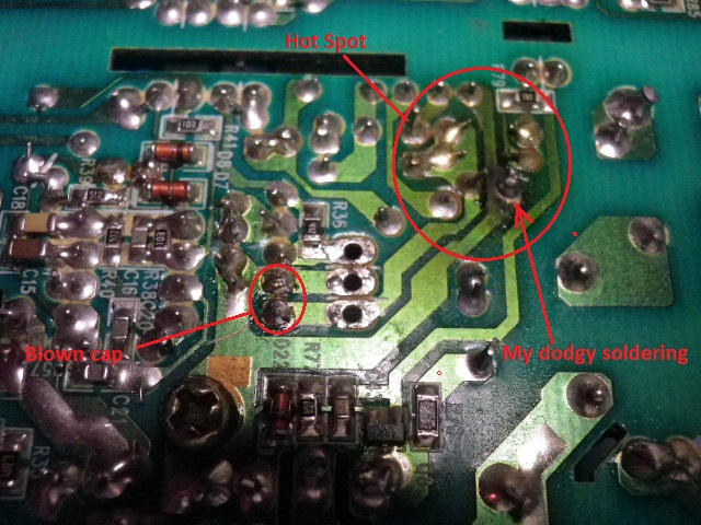

            Not sure exactly what you want to see, but here's the offending area. I followed a post elsewhere where someone had pictures of the same hot spot. And the concensus of opinion was the above resistor was the cause it but all was well. I have resoldered said resistor as the joint looked a bit sad.
            You can see from the top picture some of the debris of exploded cap (I must have had the polarity wrong...!!!). Needless to say this picture shows the replacement in position.
            I have taken the L7818CV out in these pic's. And for £0.99 it might be worth a try at replacing it.
            I've noticed that most of the pictures of this power supply have 2 medium size caps on the input. But mine has only one large one. Maybe it's the UK 240V as opposed to the states 110V...???

                  Your PSU probably doesn´t have a -5V line. Does it have a white wire in the ATX connector ?
                  Take a look at that transistor near the cap you replaced . Also look for solder bridges under the PCB.

                    I've unsoldered the transistor and run it through a simple DMM test and it seems ok And I've even checked the signal diode in the hot spot, again ok. All the pcb tracks look ok too, I've had it under a big magnifier.

                      That doesn't look good. It was probably regulating badly when those Fuhjyyu's went bad, and died after the second failure. It's an old PSU, just get a new one.

                        You could have soldered the cap backwards. It happens. Clean that points you call dodgy soldering, and test continuity from them to another point in the same trace. There could be some bad / intermitent contact there.
                        Also, measure the green wire. You may need to trace back the circuit from it and the PG wire.

                          I think I must have soldered the cap that went bang wrong. Which started me on this journey...
                          I'll check all the joints in question and near by caps. Good idea tracing back from the green, I'll have a look. But this circuit seems to be on the mains primary side, so not sure it's going to be that obvious.

                            Ok... Checked all cap and there all the right way around. Stumbled on a dry joint and sorted that out. Fired it up and all lights come on and fan is now spinning. But after a couple of seconds the PG light goes out.... Have checked the voltages and all seem good. Traced the green wire back and it comes to a small daughter board. On which was a dodgy looking transistor and resistor, which checked out ok. But next to it was a TN431 Shunt regulator. That seems suspect (if you can believe http://www.jestineyong.com/how-to-te...gulator-tl431/). So I've ordered a replacement and we'll see.
