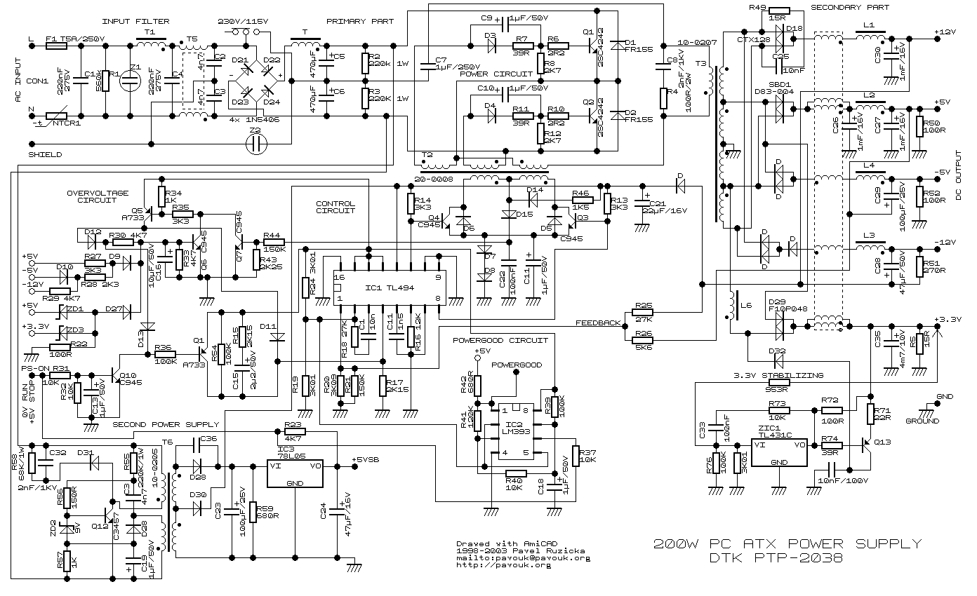

      It looks like a pretty common UC3844-based design with a few rails (and an odd +38V one.) The primary including switchers is on the lower half while the main transformer and secondary is on the upper half. From the pictures it looks like the 3 thick wires go to the primary winding on the transformer in the upper half.

          If you mean LF2, that may just be a common mode choke. The AC line should pass right through it. Trace it if you want.
          Originally posted by pentium
          One of the two large transformers on the other board (you called that the PWM board, right?) however will give off a rather angry buzz when the PSU is connected to the tape drive and under load.
          T1 is the main transformer, L3 is the output inductor.
          I made a mistake- I ASSumed there was a PFC booster. Clearly, there is not. Sorry for the confusion. Looks like that first board is the AC input/filtering, PWM/forward converter commutation, and control. Second board is TX/output inductor, secondary rectifiers, filter caps/chokes, maybe some 78xx regulators, dummy loads, and part of the feedback.

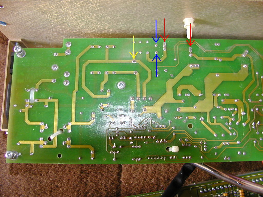

                            I felt like I was missing something. All along, R19 (lower left corner) has blown and R43/R44, maybe R45, look like they were running hot. Check that the 5W 3.6K wirewound is good, and check Q5 for shorts.
                            Also check that big red R5 (upper left corner) for resistance. Check any components above hotspots on the back of the board.
                            I know that sounds a bit vague, but if you took some macro pix of the areas of interest, we could see the color codes better. R19 is (was) a yellow-purple-something- a 47x.
                            Check any of those diodes near that opamp. Is that an LM356 or 358? Just use continuity check- if the diodes have shorted, they're shorted.
                            If it's just a single opamp (LM356), it may sense the voltage on the caps and drive a small TO-92 transistor to pull that relay in. IOW, if that opamp ckt does not work properly due to bad parts, the relay will never close and fail to set the recto up as a doubler. Hence your low bus voltage. First determine if it's a 356 or 358, then get its pinout/datasheet and make sure none of the inputs or outputs are 'stuck' at its supply voltage. If they are, the opamp is bad and also needs to be replaced.
                            In the attached image, check the following:
                            If both red points have continuity to each other
                            and
                            The yellow point to either of the blue ones also has continuity, then the relay takes place of the 120/240 switch; ultimately pulled in by way of the opamp/comparator.
                            In your OP, you said that any suspect parts checked ok and were put back. Just be aware of any carbon residue under those hot resistors- any leakage will upset the bias on, and change the setpoint of, that comparator. And if the element is exposed on R19 and touching nearby traces, components, or leads, then fix that, before banging your head in frustration.

                                      I have not yet contacted Tectrol regarding schematics.
                                      What voltage ratings are the main caps? If they are 200V, then they must be in series, so the PSU can work on higher mains voltages. Then, with 120VAC input, you'd see about 80V on each capacitor
                                      Muh-soggy-knee
                                      • pentium
                                        • Mar 2006
                                        • 2778
                                        Re: Super unreliable tape drive PSU
                                        Yeah, they're both rated for 200v.
                                        So if you say 80v each then we are in the neighborhood.
