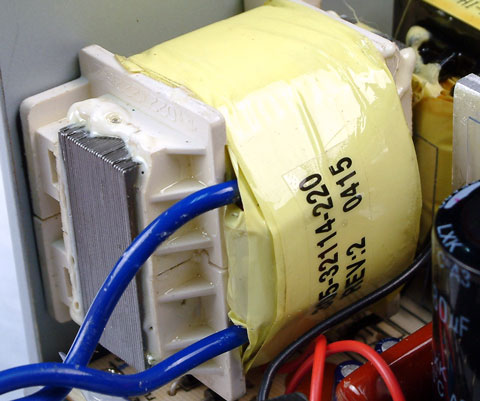

    I have 2 820uF 200v teapo caps in my Tt 480W.
    I wish to add more on the I/P caps &
    (1) Pls advice me on the max. value of the caps
    I can installed.
    (2) Are there any differences ( especially the inrush current )
    to replace the old caps to larger caps or just to solder the new
    in parallel to the old ? and also, if the news are different brand.

      Re: Is it safe to double the bulky caps ?
      Yet, because I removed the huge
      passive PFC inductor. It just like the
      one in the attached pic.
      There is some room left now.
      I done it before on old psu by soldering wires.
      Also, I done transferring my Hedy 350W PSU
      to a larger old psu case. Then, I added it with larger
      heatsink & replaced the 680uF caps to 820uF,
      replaced the fans to LED ball bearing fans.
      The caps values you mentioned are their original values.
      It is of course safe. For the same circuit, to what value
      can I added to ? In my case, the Tt 480W come with 820uf.
      Can I make it to 1200uf or even 2000uf ?
        Hi hkivan
        You're in Hong Kong, I believe - so your PSU will be rated for 230vac - ie. those two 200v, 820uF will be in series, giving you a total capacitance of 400v, 410uF.
        410uF isn't extremely low, although it is a little less than what one would normally see in a passive PFC PSU rated for 480W. The Enermax 470W "noisetaker" unit, for example, has two 1000uF caps, giving 500uF in total.
        Originally posted by hkivan
        In my case, the Tt 480W come with 820uf. Can I make it to 1200uf or even 2000uf ?
        I guess 1000 or 1200uf caps shouldn't be a problem, although I wouldn't overdo it - what exactly would you like to achieve, though? Is there a lot of 100Hz ripple on the output you want to eliminate?

          Can't the current peaks go really high and possibly damage the diode bridge if the capacitance is too large?
