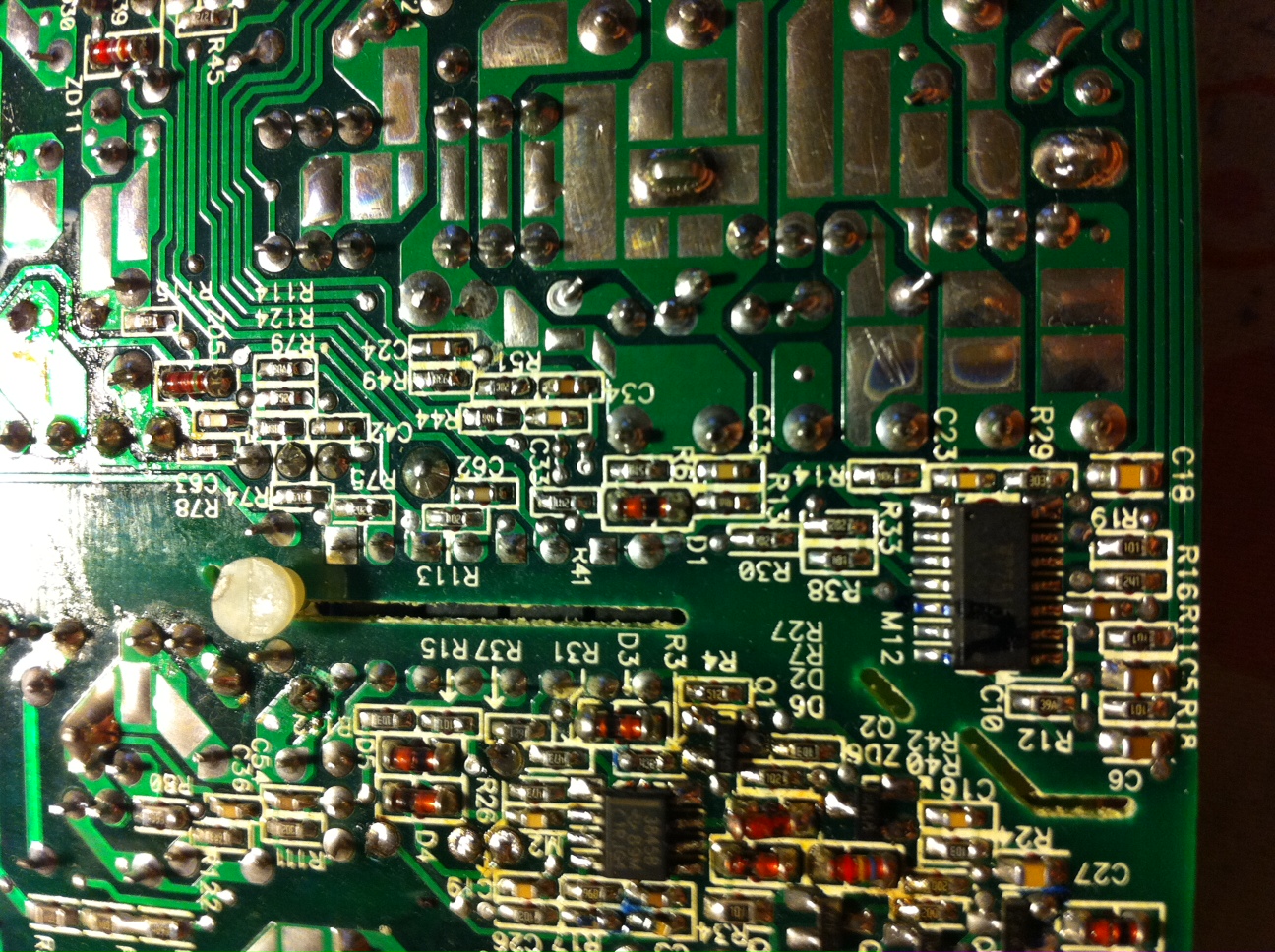

    I have a few of the above mentioned power supplies with Pin 8 showing no voltage when jumpered. The correct voltage should be 5v and comes from the WT7515 chip. I've replaced that chip along with the 3845B and W1P (Q1) chip and still can not get voltage to show up. I know that Q1 is typically a culprit, and this supplies power to the 3845B chip, is it possible that the other surrounding 1P or W1P chips or it's counter parts the 2F are bad as well? I'm not sure how to test if these are bad or where to go from here. By the way all other voltages on all other pins are correct on my unit according to the voltages listed below except for pin 8.
    Voltages measured from ground are as follows:
    3, 5, 7, 11, 14, 16, 17, 18 - Ground (-)
    1, 2, 12 - 3.3v
    4, 6, 20, 21 - 5.1v
    8 - (Power Good) - 5v
    9* - (Standby) - 5v
    10, 13, 19 - 12v
    15 - On/Off - jumper to ground (14 or 16) to run supply
    22* - 24v (may read about 21v until switched on)
    * Always present when unit is plugged in but not switched on.

    Voltages with respect to Common negative output ? :
    Pin 1 - WT7515
    Cathode - D1
    veritas odium parit
    • torgeson5kqs
      • Mar 2011
      • 116
      Re: iMAC G5 Power Supply API4PC46-290 REV.A pin 8 no voltage
      unjumpered the voltage on pin of wt7515 is .8v and cathode of D1 is 9.6v
      jumpered the voltage on pin of wt7515 is .8v and cathode of D1 is 10.3v
      both from common ground.
        Re-Do post - site was down and it didn't get in...
        Only time that should show voltage is when its turned (jumpered) on.
        Check D1, R6, R13, R14
          voltages listed below while unit was jumpered
          D1 - 10.2
          R6 - 0
          R13 - 9.3
          R14 - .8
          voltages listed below while unit was unjumpered (same)
          D1 - 10.2
          R6 - 0
          R13 - 9.3
          R14 - .8
          • Toasty
            • Jul 2007
            • 4171
            No. Check the 4 components for -values-. Dig up your SMD resistor code book.
            Voltages should -not- be present on PGI/PGO when not on(in standby).
            Voltage comes from the outputs to the WT7515 chip. So, there is another problem if you have readings when in standby.
            In standby, you should only have:
            FPOB = ~4.5v
            PSONB = ~5.2v
            VCC = ~5.2v
            ...and those all come from the 5vsb

              Ok the resistor values are below but I don't know about the diode.
              D1 - ? shows black cathode band and then just a red strip looks l D14, D17, D13 ( I think they are all the same)
              R6 - 51 ohms code is 510
              R13 - 94 Mohms (seems rather high) code is 946
              R14 - 845 ohms +/- 1% code is 90A
              R13 - I looked up another power supply and it appears to be 9.31 kΩ (≤1%) code shows 94b
              • Toasty
                • Jul 2007
                • 4171
                I know what they are, are they good?
                veritas odium parit
                • torgeson5kqs
                  • Mar 2011
                  • 116
                  Uhhh very sorry. All of these were measured in circuit with Extech RC200 tweezer multimeter.
                  D1 - 1.88 volts (not sure how to measure this) or reads 772 ohms on diode setting
                  R6 - 50.4
                  R13 - 9.23 Kohms
                  R14 - 840 ohms
                  I checked a couple of bad supplies and they all read about the same values for these. So they appear to be good, yes?
                  • Toasty
                    • Jul 2007
                    • 4171
                    D1 should conduct one way and be infinite the other on diode test.
                    Others match their markings so no problems.
                    Something is wrong in that you are getting voltage on PGI/PGO in standby mode.
                      The D1 does show infinate one way and conducts the other, I have a total of 4 of these power supplies and they all show voltages on standby very close to the values I mentioned in post #5. The reistors and diodes also show values within spec with regard to ohms. Again these were all tested in circuit, should I pull a couple out and test?
                      • Toasty
                        • Jul 2007
                        • 4171
                        No need to pull out and test values.
                        There is another problem if you have voltages here in standby.
                        No. Wait. I have a better one...
                              here is what I have on the WT7515 in standby
                              1 - .8
                              2 - 0
                              3 - 4.6
                              4 - 5.2
                              5 - 5.8
                              6 - 1.1
                              7 - 2.9
                              8 - 3.3
                              9 - 5.8
                              10 - 5.8
                              11 - 3.3
                              12 - 3.0
                              13 - 5.1
                              14 - 0
                              FPOB = ~4.5v PIN 3
                              PSONB = ~5.2v PIN 4
                              VCC = ~5.2v PIN 13
                              When jumpered I have
                              1 - .8
                              2 - 0
                              3 - 0
                              4 - .4
                              5 - 12
                              6 - 0
                              7 - 5.1
                              8 - 3.3
                              9 - 12.1
                              10 - 12.1
                              11 - 3.3
                              12 - 5.2
                              13 - 5.1
                              14 - 0
                              All I can think of is that there is a short or their is an overage of voltage that is spilling over from a component for lack of a better phrase. I've checked for shorts on many of the SMD's with no luck.

                                Looks like a leaky opto in some way. Like the supply is getting bits of a signal to run, when it shouldn't.
                                In standby, what voltage do you have across the main caps?
                                veritas odium parit
                                • torgeson5kqs
                                  • Mar 2011
                                  • 116
                                  I get anywhere from 167 to 170 volts on the main caps depending on which power supply I check.
                                  • Toasty
                                    • Jul 2007
                                    • 4171
                                    That's correct. So this means the main side is not being turned on. PFC is not on.
                                    On you should get ~384 volts.
