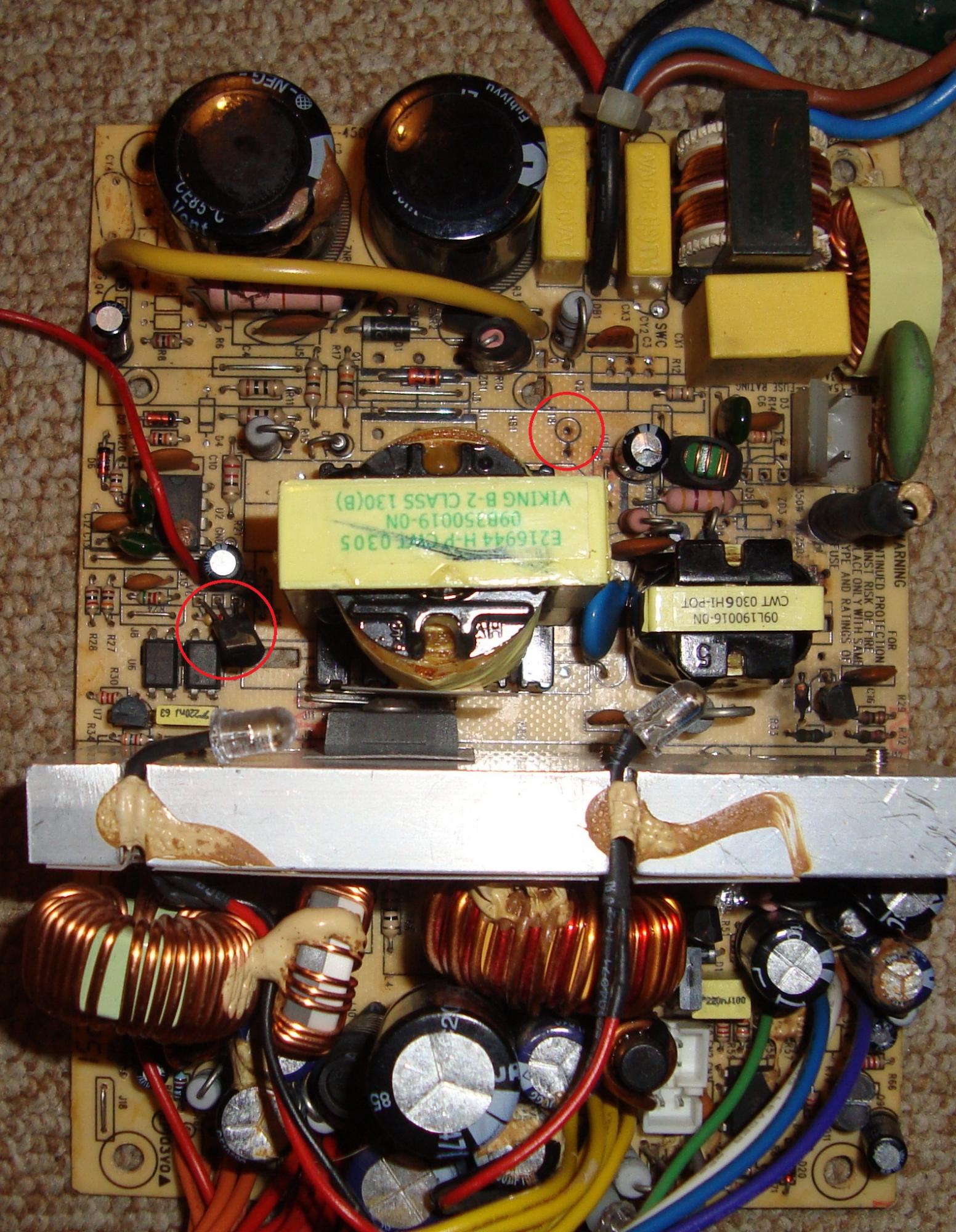

      Hi everell, thanks for your reply. Attached you'll find a picture of the supply (I stripped out most of the broken components plus the heatsink).
      I'm looking for the transistor on the left, and the resistor (that's already removed) next to the bulging capacitor on the right.

        R18 is 470 ohms. Q6 is UTC (brand) 2SA684.

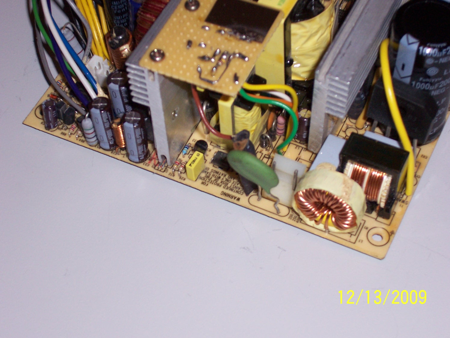

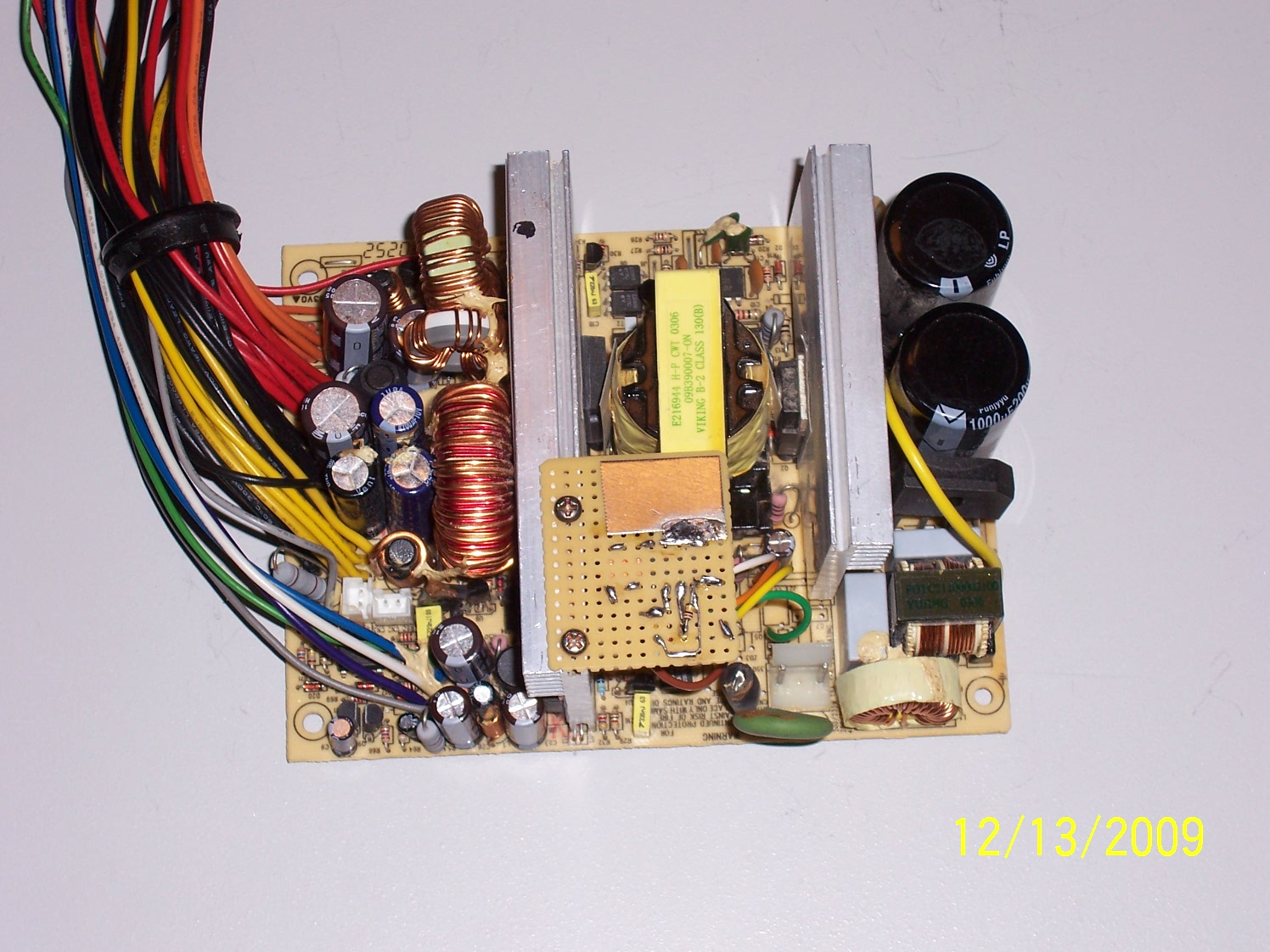

          I added the DM311 mod to an Antec SL400 two years ago. Here are a couple of pictures and some drawings.
          The drawings show the original 5vsb circuit, a drawing showing which components needed to be removed (by using white out and removing them from the original drawing!), and a drawing showing how the final modified circuit should look.
          Old proverb say.........If you shoot at nothing, you will hit nothing (George Henry 10-14-11)

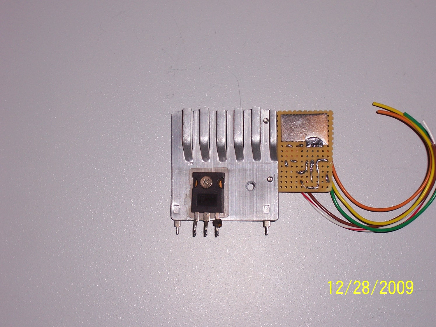

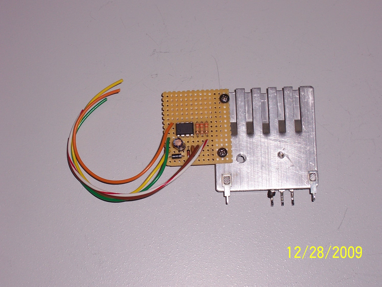

              For further reference, here are two pictures showing the board layout of the DM311 mod. The heat sink is a piece of tin cut out from a mixed nuts can. The mixed nuts were great. Isn't it nice when even the can is used instead of being total trash! Please note that all tin cans will NOT take solder, but the solder will bubble up and not stick. The ones to use will easily take solder, and you will see the solder flow.
              This board is attached to the heat sink on a Bestec power supply, but it is the same board layout I use on all power supplies I put this mod on. Just a matter of where and how it is attached.
