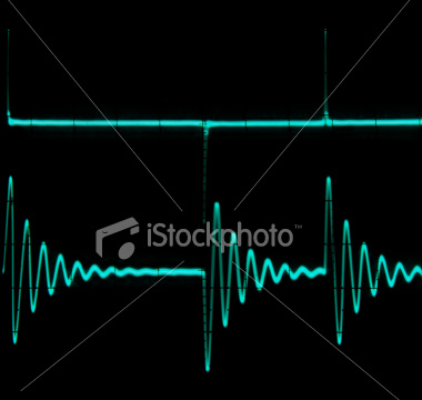

                                    Scope the transformer input and outputs. You should have very clean sweeps as in the lower part of the attached image.
                                    Remember to use a 10X probe on the primary. Your peaks can be 350-400v coming off that TOP.

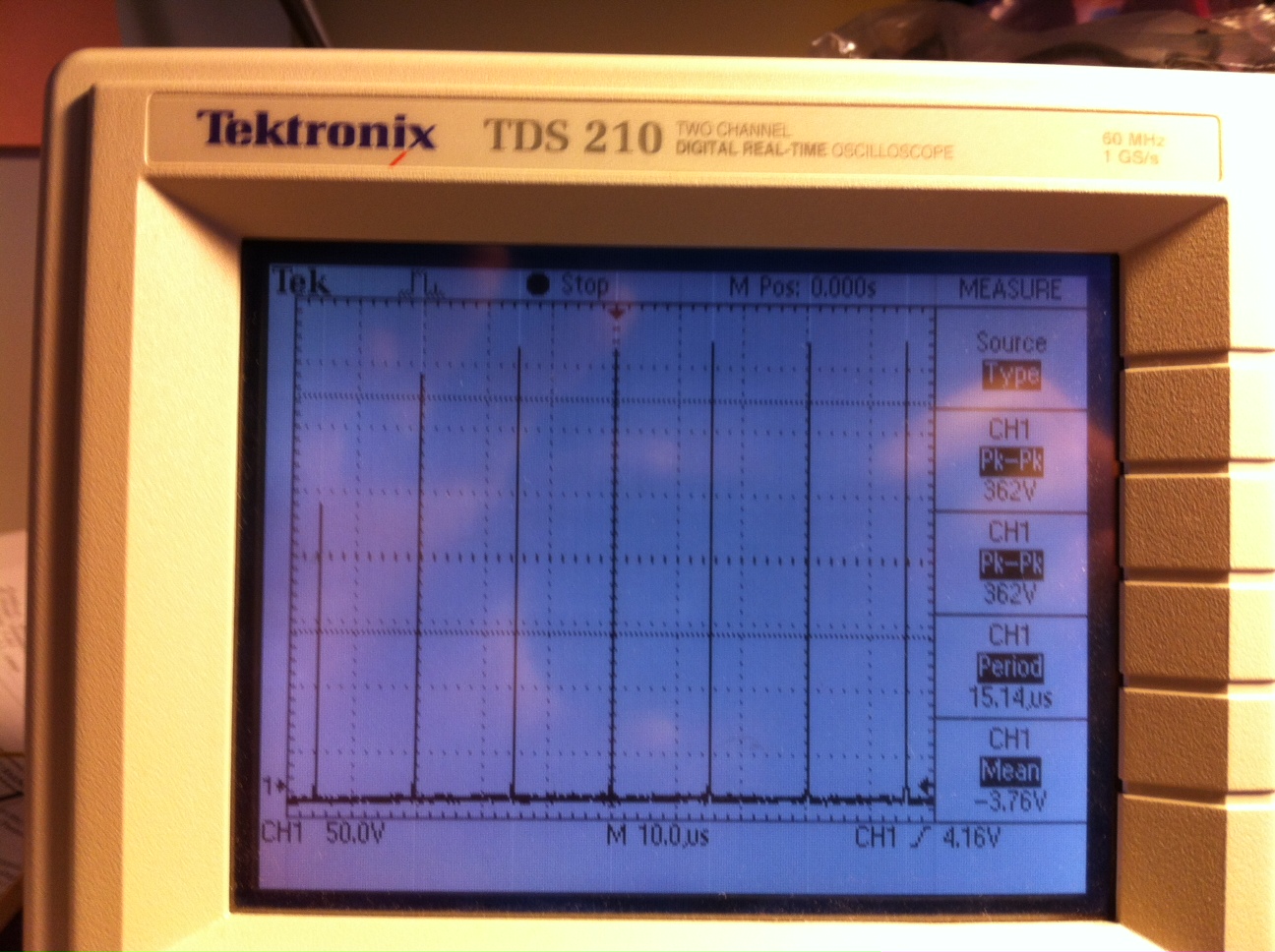

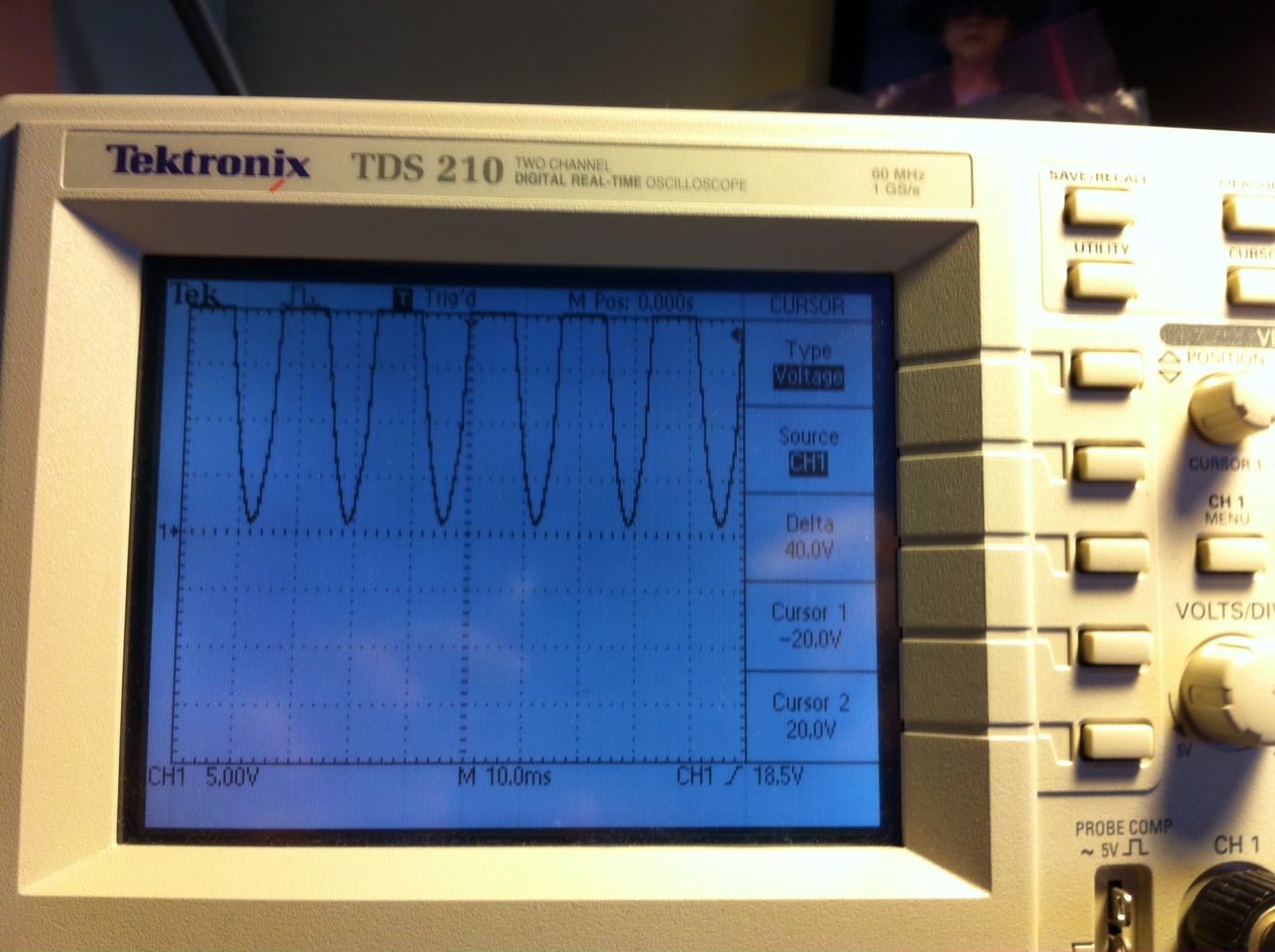

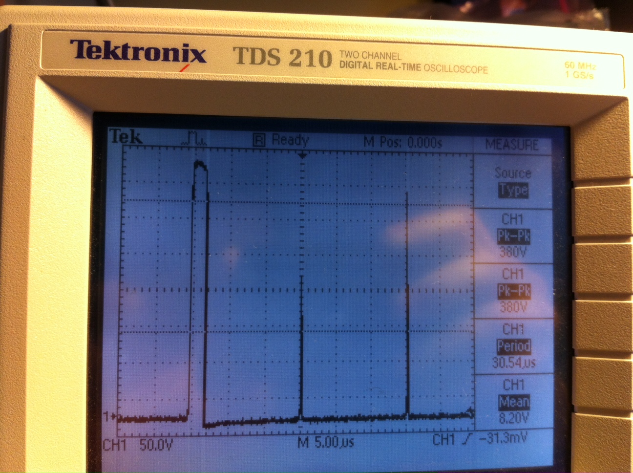

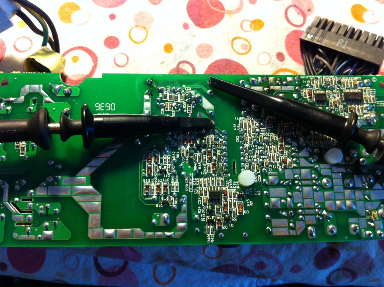

                                      #58
                                      Re: iMac G5 AcBel 17" API3PC94-290 no voltages
                                      here is a couple of pics of the setup and what I get on the scope

                                        #59
                                        You have both probes attached. That's not correct.
                                        Remove the left probe and attach the ground clip (supplied with probes) to the right probe at the exposed silver barrel section. Where you have the right hand probe is okay. You want the ground clip to the pin just below it.
                                        The Upper Left 2 pins are the TOP output and the primary of T2.
                                        This transformer has a primary and 3 secondaries. The HOT side secondary is 16v and comes from the 2 pins on the Lower Left.
                                        The isolated secondary is the 2 on the Upper Right and the 2 on the Lower Right. Their common is the 2 tied together in the middle. Upper Right is 5v, Lower Right is 30v.
                                        You should have 400v+ P-P on the Upper Left pins.
                                        Corresponding lower readings on each of the other 3 pairs.

                                          #60
                                          I both pics should show what your looking for however the Pk - Pk tops out at about 370 volts on the two upper left pins when.
