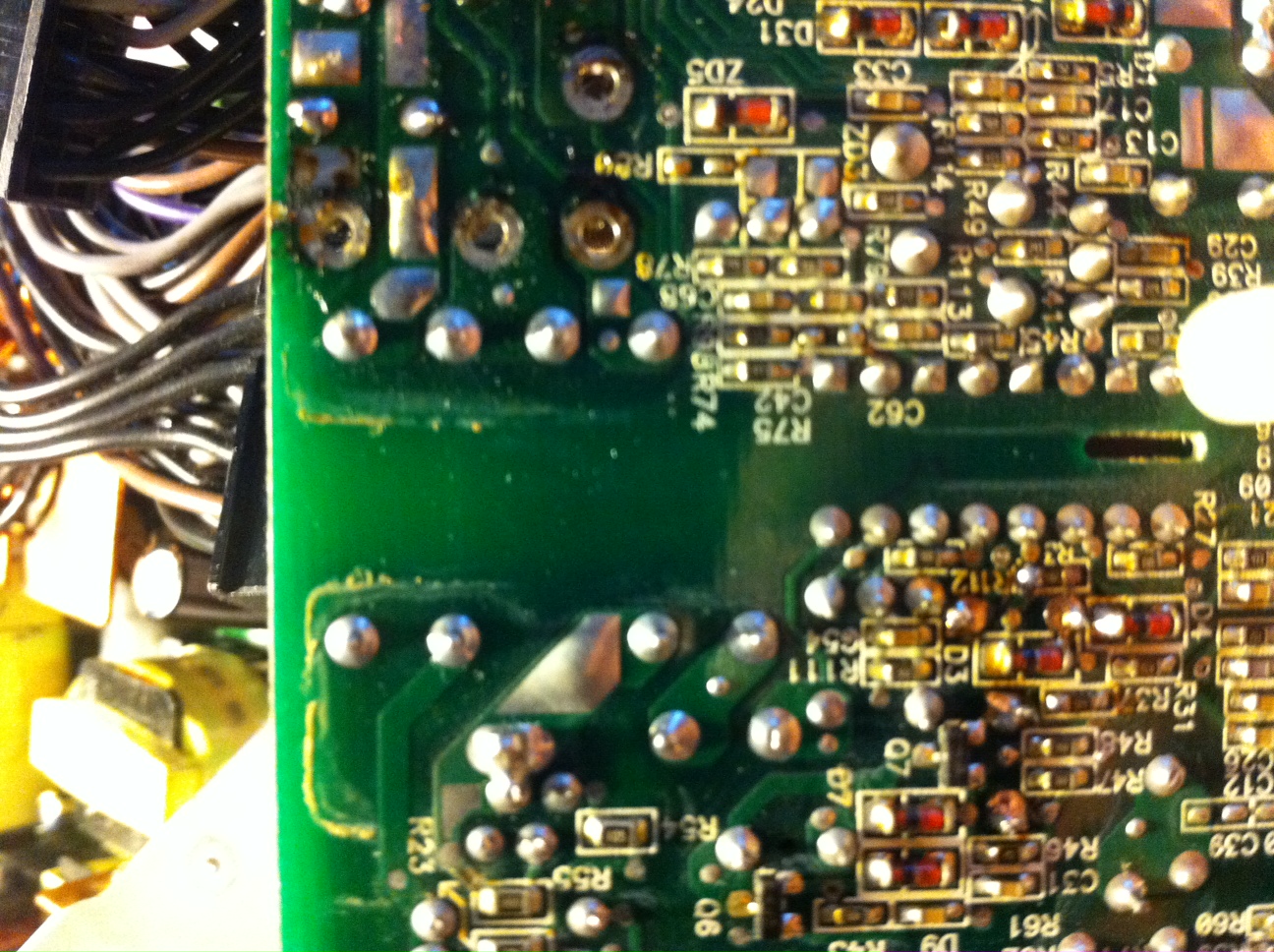

                                  I'm sorry on the good one I had the diodes in. Once I took out the diodes on the bad power supply I tested them with a transistor/diode tester and the larger one D20 was bad so I replaced it, but that doesn't matter at this point because power isn't even getting to the diodes.
                                  • torgeson5kqs
                                    • Mar 2011
                                    • 116
                                    Re: iMac G5 AcBel 17" API3PC94-290 no voltages
                                    I've attached a picture of the transformer pins and removed diodes from a working power supply and also have an identical one next to it with the diodes removed as well. On the good one I also get erratic AC readings (not sure if i'm doing this correctly) when I test the output side of the transformer. All the legs on the right no matter what comination I attach the probes give me an erratic reading. I'm obviously doing something wroong here. Testing with DC gets 0v.
                                    The picture needs to be oriented 90 degrees clockwise.
                                    • Toasty
                                      • Jul 2007
                                      • 4171
                                      Nope. Nothing you're doing wrong. The TOP is not getting any feedback so it's jumping around trying to do something. Without the feedback, it will "bounce", trying to start.
                                      Since both supplies provide the same results, the problem is -not- in the transformer.
                                      Since those diodes are out of circuit, try some ohmmeter (diode test too) readings with from their cathode foil to ground. Remember you're on the COLD side now.
                                      Try with one diode back in, then the other. Does anything come back?
                                      Check the 3 caps at that edge you replaced. Make sure to reflow their connections as I've seen these grab the foil side of the via, but not the component side. Try to wiggle the caps a bit as you reflow. Flux on the topside too.
                                      Check the 24v regulator. Make sure it's not shorted.
                                      A scope would be real handy right about now.
