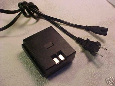

    My bother call me one day last week saying hey my printer dose not work any more so I said OK let take a look and see what up
    Power supply DEAD no power output........ 30 volt power supply
    Open the little power supply and found that it has a mosfet and three caps that on the hit list of BAD brands to have in a power supply
    330 uf @ 35 volts 1.4 ESR reading
    10 uf @ 50 volts 13 ESR reading
    Mosfet was a question mark to where or not it was working or not
    I first put in the Mosfet and then there was power of 29.98 volts DC
    but would turn on the printer
    so I put a motor that is 12 volts on this power supply the motor ran slow on the power supply
    then I changed the two caps now the printer come on and works like it did when it was new
    Took about 1.5 hours to fix this power supply
    Mosfet $1.00
    330 cap $1.00
    10 cap $0.20
    Shipping $7.00 there was other parts ordered

      UpDate
      This power supply still going strong after being repaired
      So I am sure that is a good fix
      I had to fix a Radio Shack power supply today [which they no longer sell] .....> [it is not switching] because of a very bad cap
      4500 uf @ 25 volts ESR reading of 3.1 which has pop it's top the replaced cap has a ESR reading of .02
