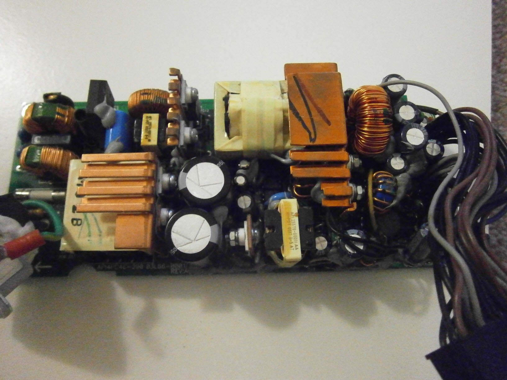

    Hello all,
    I need some help to troubleshoot my iMac G5 Power Supply. I followed this post (https://www.badcaps.net/forum/showpo...1&postcount=37) to measure the voltages. I can read numbers from 2 pins only: 20v in Pin 22, and 5v in Pin 9. The meter shows the same voltage when power supper is in Off or On position. The rest of pin have 0 volt.
    My iMac G5 model is API4PC46 Rev A. Part numbers is 614-0366.
    Please help

    It needs to be recapped, to begin with. Everything except the 2 mains filters.

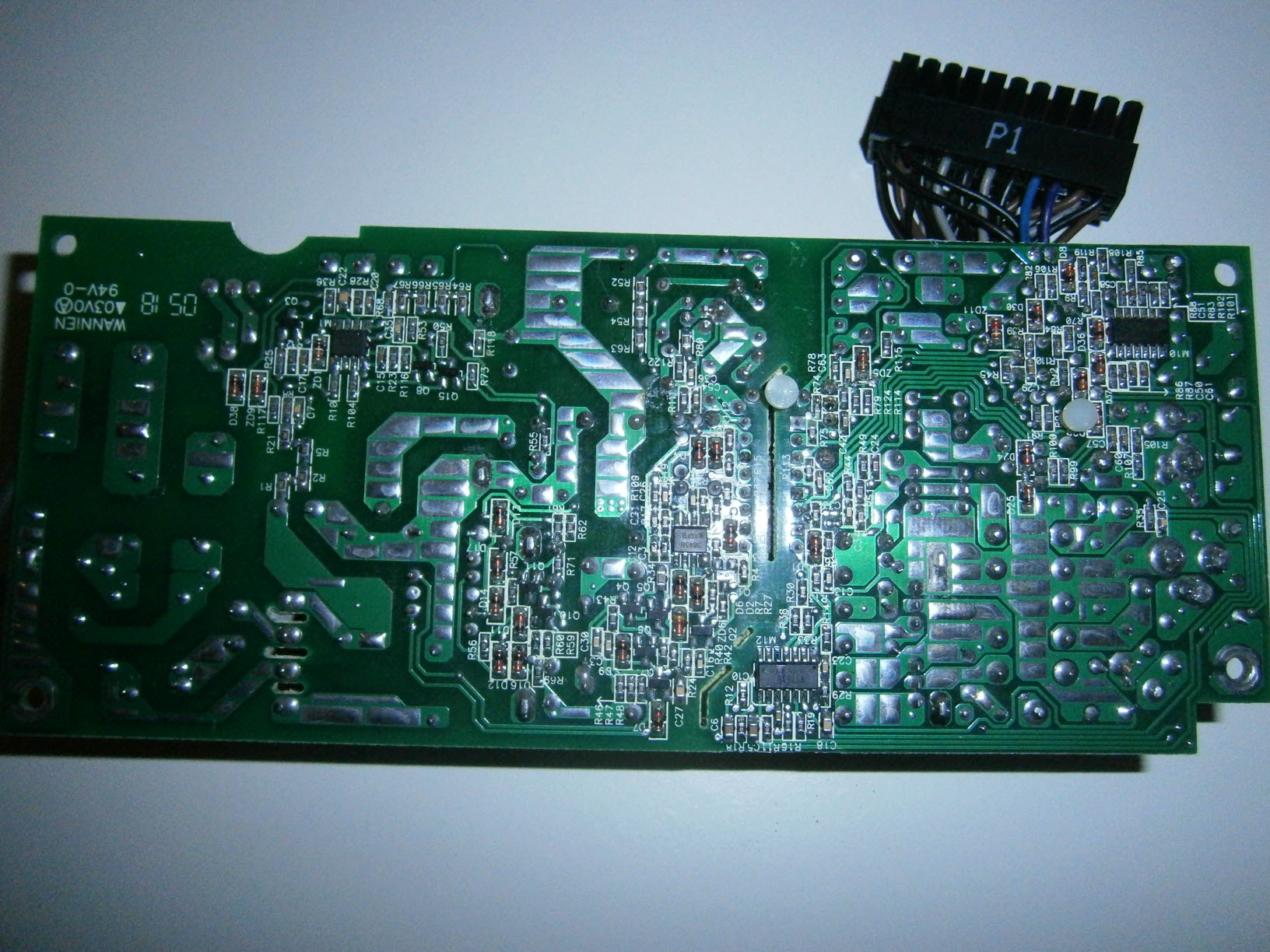

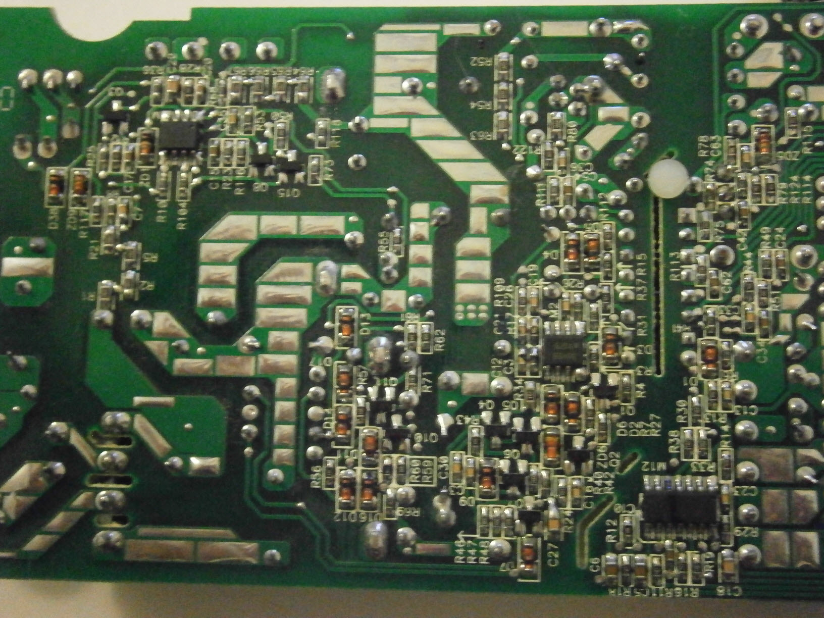

    Clear, well lit photos of the unit. In particular the underside near the middle of the board.

      Thank for the reply. I took few pictures for my power supply, please take a look on it.
      All capacitors looks good. No bulging or leak.
        Re: iMac G5 Power Supply Voltages
        Looks good. I see none of the usual symptoms.
        Re-cap it 100% (except for 2 Rubycon mains caps) and it should be fine.

          Thank Toasty. I will recap it and test it again
            Like Toasty say, recap it 100% ,even if caps looks good(no leaking,or bulging), in time will be,"cooked" by heat and loose capacity. I've seen this in many situation.
              Thank you Toasty and Marius.moise. The power supply is in action after I recapped it.
              Thank a lot
