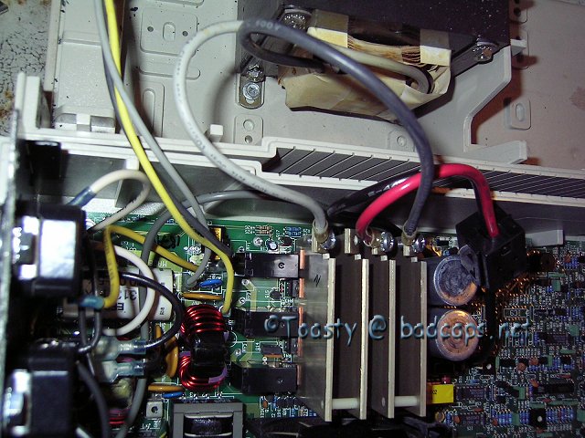

          This your 1250?

            • Toasty
              • Jul 2007
              • 4171
              Re: Smart-UPS MOV replacement
              Sorry. Question was directed at Maxxarcade.

                Originally posted by Toasty
                This your 1250?
                Yep, looks like that.
                I just got in a shipment of 20mm 130v MOV's made by Littlefuse. Hope to start the repairs this weekend.
                    Okay, which caps? I'm assuming the 6 yellow-orange MOV's, yes? Or, the 5 blue one's? Or both/all?
                    Large white cap?
                      Large white cap?
                      Not sure which MOV's I need to change yet. I hope to have a look this weekend.
                      If I recall, there is a handful of 22uf caps that need to be changed. There might be a couple others, but I don't remember which ones without looking at it.
                      • Toasty
                        • Jul 2007
                        • 4171
                        LMK. It's a back-up unit (no pun intended), so I can pull the board out of it and have a good look for you.

                                  I apologize for bringing this thread back from the dead but the circuit board shown by Toasty looks like my own APC UPS.
                                  I am looking to replace the yellow cap to the right of the picture: https://www.badcaps.net/forum/attach...6&d=1177069821
                                  Would appreciate if you guys could have a look here: https://www.badcaps.net/forum/showthread.php?t=21758
