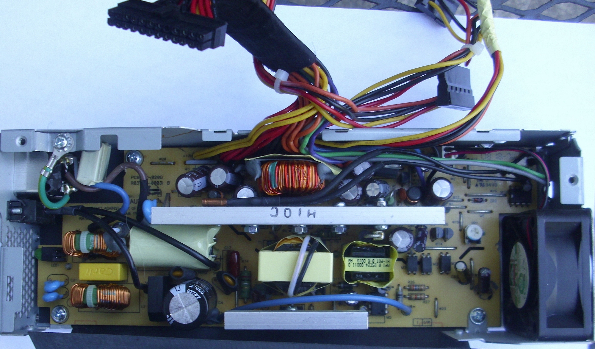

    HP 5188-7520 testing
    This power supply had several bad caps in it.

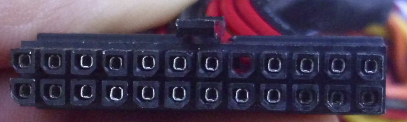

    I have replaced all the capacitors,What do i have to do to get this to turn on.
    I am testing it on the bench,So do i need to tickle a pin to ground or tickle a pin to a voltage?If so dose any one know witch pins?

    Re: HP 5188-7520 testing
    It seems an ATX supply, so you would connect the Green wire to some GND( black wire ) near it.
      Thanks the fan spins,I now will check the output voltages
        It' up and running.
        This about a $60 power supply so 8 capacitors to get it going, is Worth it.
