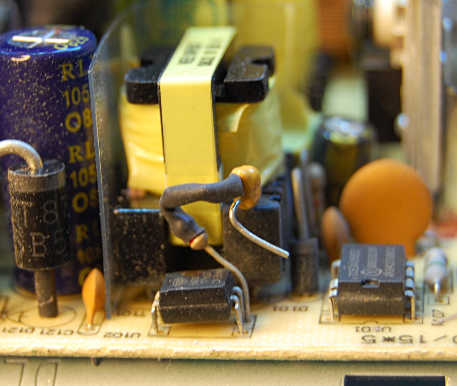

    This supply has been in use since 2009, no problems. I'd read lately about this series using cheap capacitors. So I swapped it out, planning to replace the caps and maybe the fan.
    Now, I'm not sure it's worth it. First:
    Yes, that's a resistor and capacitor hanging by one leg. The IC is crooked, so probably the unattached leg should also be stuffed in with the chip but slipped out before soldering. Probably.

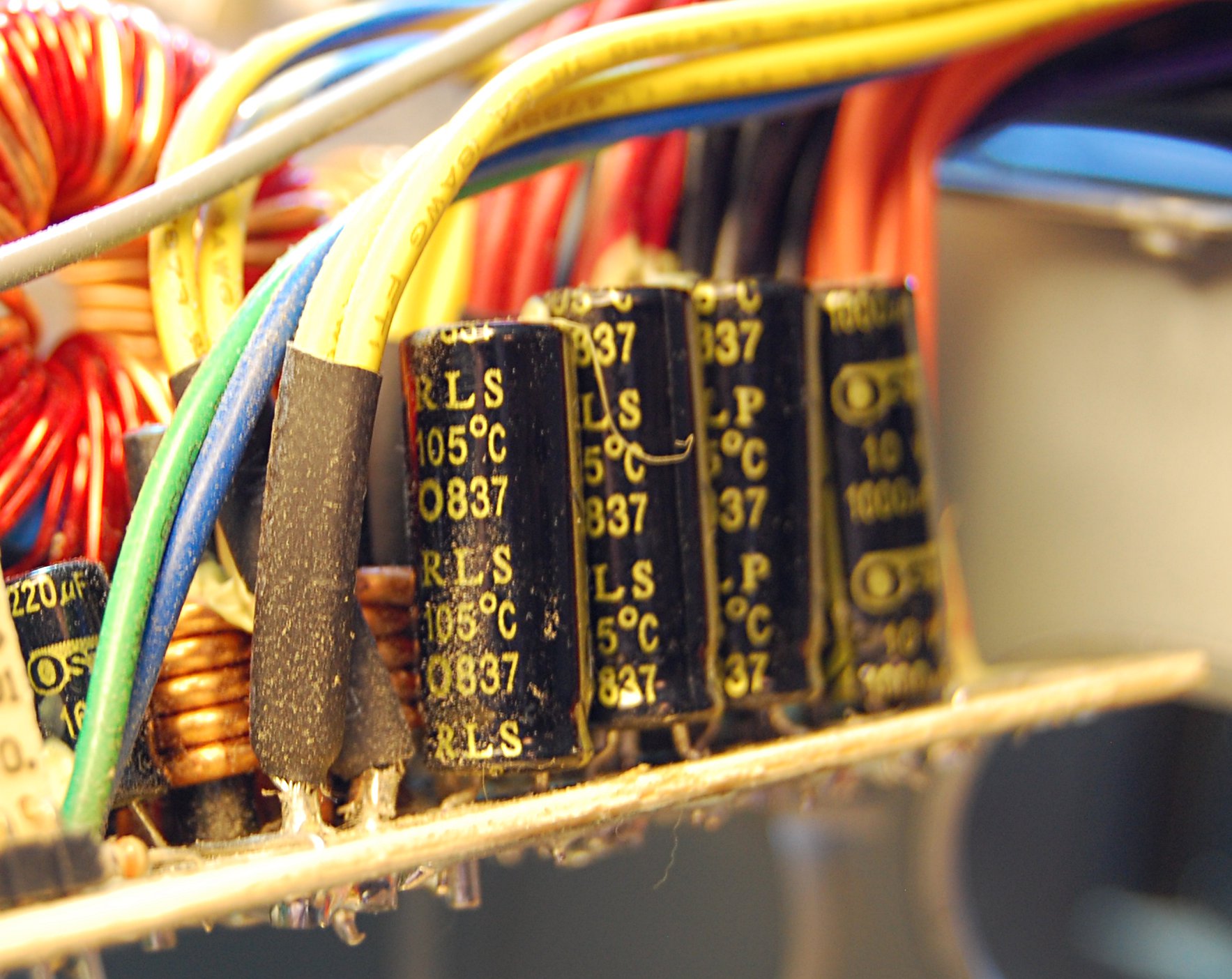

    One largish cap of unknown brand, marked CE(M), UQ 85 deg C, 180 uF, 400V, 8306K. Thirteen OST capacitors, many in hard-to-reach places or glued down with that brown glue, or both:
    RLX, LP, RLS series. No idea what to use for replacements.

    That's a compensation network on that optocoupler there, i guess they wanted to install that but changed their mind on the way. Probably a slip on the production line.

      OST's web site is broken in places, but I think I found replacements. The ripple rating is really high on the larger OST caps, higher than Panasonic FM. Can you recommend replacements for these bigger ones (maybe poly?):
      2200uF 16V RLX, 10x25, ESR 0.21, ripple 3000mA
      2200uF 10V RLX, 10x20, ESR 0.21, ripple 3000mA
      3300uF 10V RLX, 10x25, ESR 0.014, ripple 2780mA

                  Is there any reason I shouldn't reconnect the loose RC lead? That strikes me as a manufacturing error. The bending of the capacitor leg makes it fit to pin 3 of that optoisolator, although I'd like to see another one to be sure.
                  The chip is a NEC 2561. The resistor in heatshrink is 3.3K, the capacitor 0.47uF, and pins 3 and 4 of the optoisolator are the output/phototransistor side. Filtering out high-frequency noise?

                    That is a compensation network. If the power supply does not squeal or anything (you don't have an oscilloscope don't you?), remove it. It may cause other problems if it's not the right compensation.

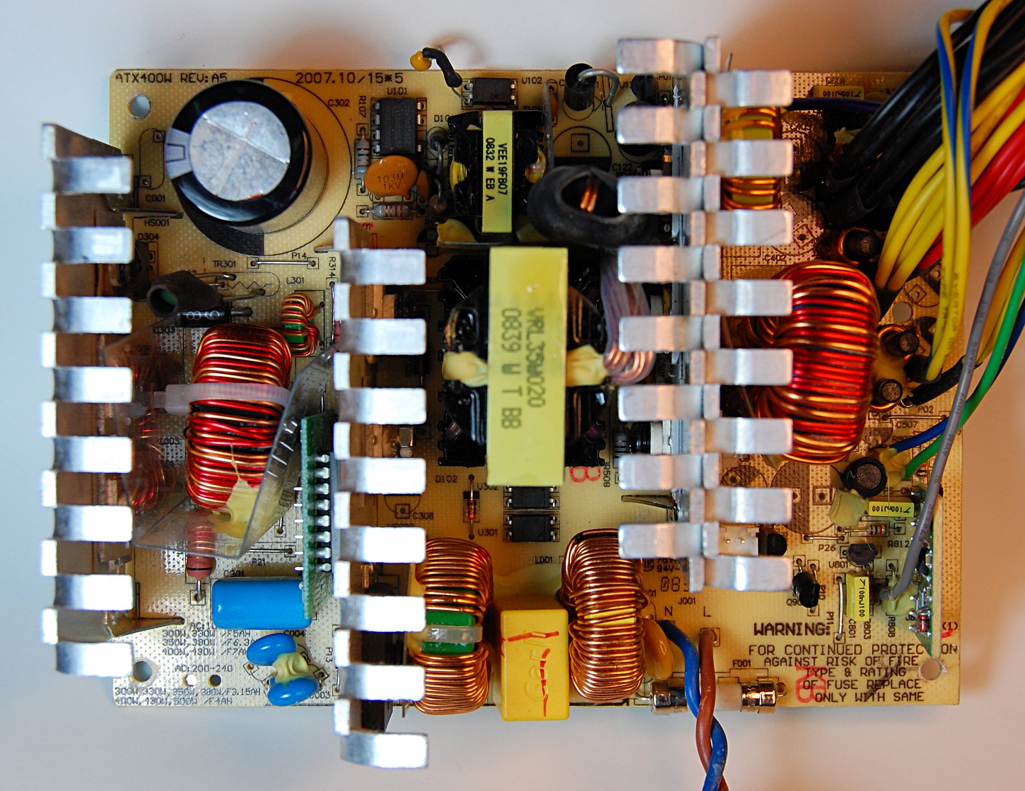

                      Can we get a full top down picture? I'm thinking it looks to be the same layout as my Seasonic S12-II & Antec EA380.

                          Full board, without the OST capacitors removed earlier today. Hanging cap/resistor is top center.
                          Hadn't noticed the "ATX400W" until now. Evidently a generic board.

                            I wouldn't call it generic. There are Corsair labels on the transformers and the layout isn't typical. And i'm quite sure someone DID test this at the factory and decided the RC combo isn't needed, maybe they got a batch of optos with wide tolerances, and some of them needed it, some didn't. The sloppy mounting of the opto is a good evidence of that.
