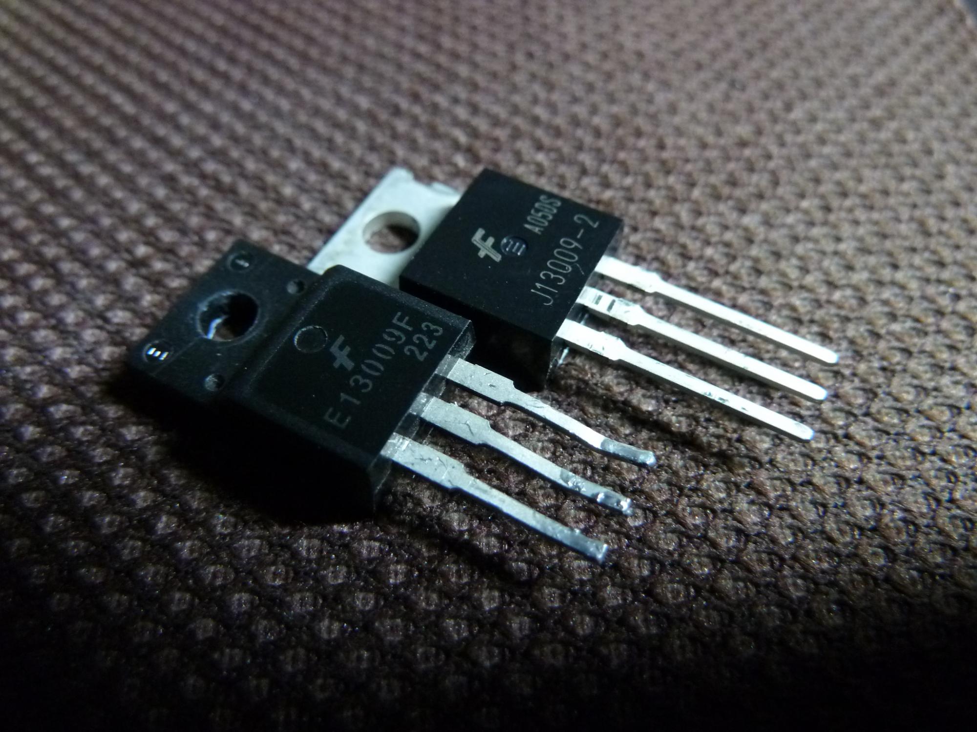

    E13009F and J13009-2
    Are the two the same?
  • joshnz
    • Feb 2011
    • 969
    • New Zealand
    Re: E13009F and J13009-2
    No.
    The new one is not insulated.
    There are two types one insulated and one that is not.
    the one with the metal tab requires what is shown in the pic.
      Ah thanks! Looks like I wasted $3 then.
      But they're essentially the same component?
        You didn't waste $3, just get some insulating washers and you should be fine.
          It isn't of use anymore, I just blew the fuse on the power supply and tripped the circuit breaker in my home when the power supply I was attempting to repair fell and landed on metal... and as luck would have it, the other transistor got shorted.
          I suppose that transistor is unusable now.
