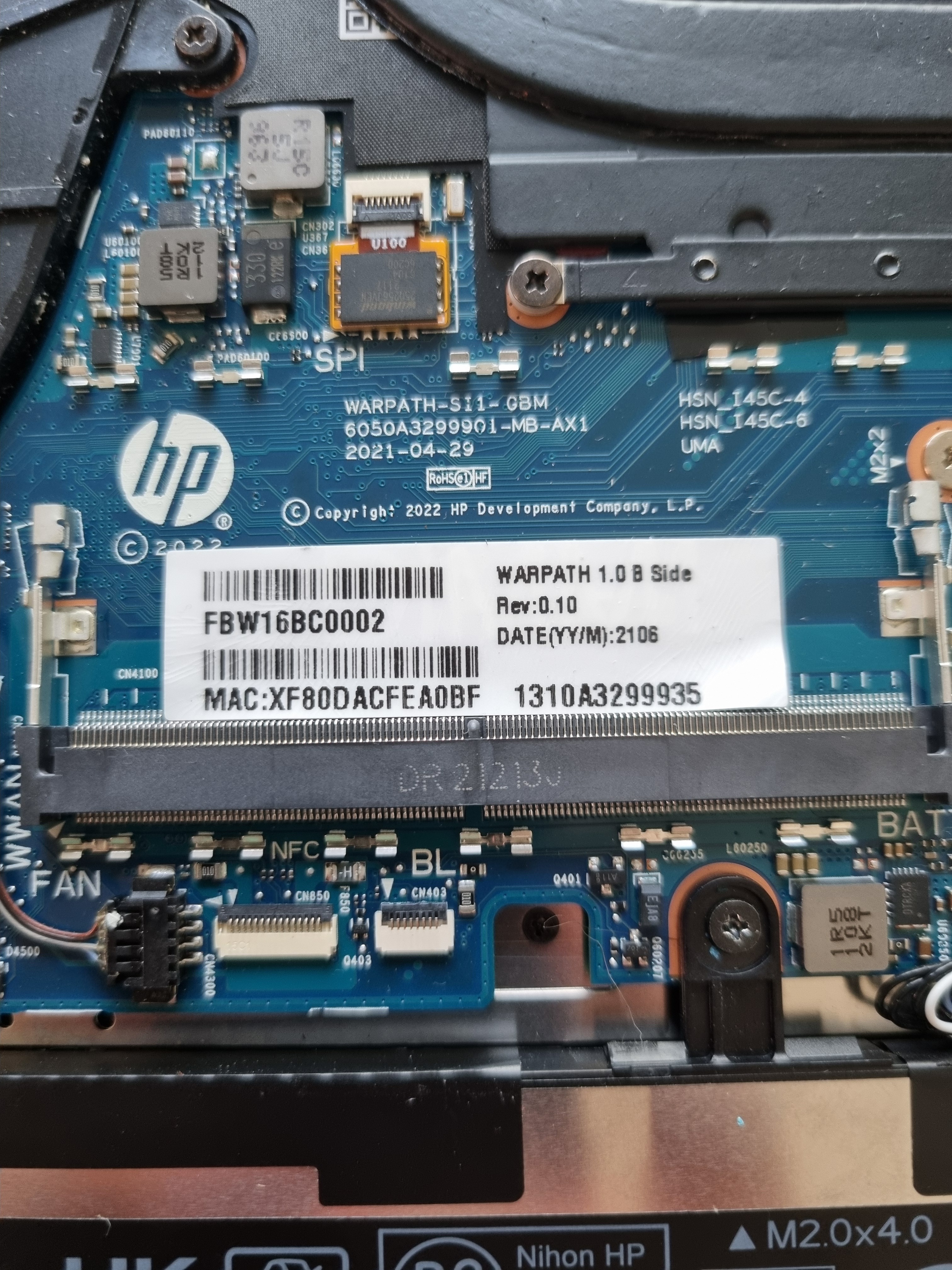

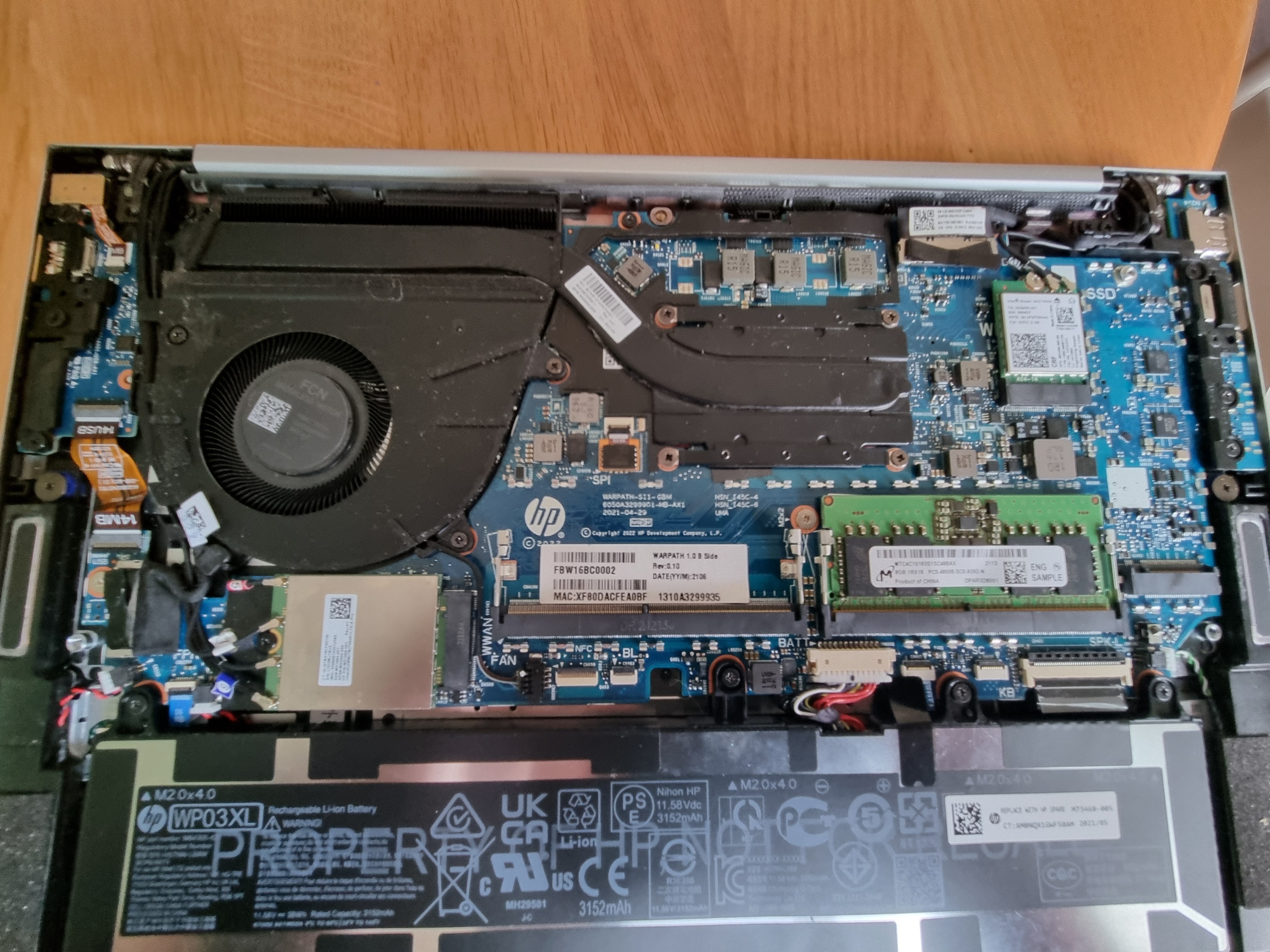

    I recently bought a faulty Elitebook from ebay, and that was exactly how it was listed just "HP Elitebook", no details.
    It has two issues, the first being in manufacturing mode for the bios, which from my understanding essentially means a bios has been flashed that does not have any of the laptops details, model, serial number etc.
    The second issue is it does not charge which I'm sure I'll be ok with once i get into it.
    The bios issue is a problem though as the laptop is missing all of the details on the bottom case, it's completely blank, it's not like they were rubbed off, it's as if they were never there, so I have no details to enter into the bios.
    The motherboard is a 6050A3299901-MB-AX1, which after some searching is almost identical to the HP Elitebook 840 G9 motherboard part number, the only difference being that a G9 is A01 not AX1, from studying images of a G9 MB, the bios chip on the board is mounted differently on my machine, on a sub board attached via a ribbon cable, while on the G9 it is mounted directly on the motherboard.
    Has anyone encountered this motherboard model number before? does anyone know what this machine is?
    I'm going to call HP Support, I'm hoping they can give me the machines details based on the MB serial number but I don't have much hope they will be helpful.

    At the bottom of your second picture it says PROPERTY OF HP NOT FOR ???? ,can`t see the last word but i think it`s LOAN .I`d guess it`s probably for HP`s engineers only and prior to the review units

      It appears to be "NOT FOR RESALE" actually, but yes. You're probably supposed to fill it with values of a similar device or just with fantasy numbers...
      The MPM can be deactivated anyway afaik.

        Yes. We have similar units from HP and Intel for design work we did for them. They supplied us with early versions of the chassis for validation of our PCIe host adapters and OEM integration. Each is marked the same 'Not for resale'. While they were not connected to the internet, they still function from last time power up.

          Thanks, honestly didn't see the "resale" text, couldn't see the wood for the trees I guess, and yes just got off a chat with HP support, they understandably can't/won't help as it seems it fell off a lorry, I might keep it for parts or try to return it, it was only £40 so the screen/battery cover that anyway.
