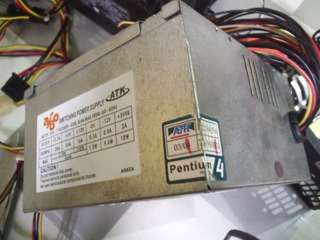

          This PSU, on secondary side, has components mounted on the heatsink:
          • MOSPEC S16C40C V6D
          • MOSPEC S20C40C ======> replaced with MBR3045CT
          • BYQ28E 200 PMv 8423 A7 =====> i don't know what this is for.
          Primary:
          • D13007K 400II
          • TT2146 M4F4 =====> x2 ; i gues they are the push pull switching transistor.
          days are so short when you actually do something..
          • yanz
            • Nov 2004
            • 910
            Re: Recapping my PSU (non PFC) & a little modification
            Reina was right. The original schottky for 5V is only rated for 20A (MOSPEC 20C40C). How dare they rated its +5V at 35A? This PSu was never been designed to push that much amperage.
            Loking at the datasheet there: http://www.deer-group.com/switch-12cm.htm , even the 400W is only 30A at 5V. i don't care if this PSU is originally a 300W, 350W, or 400W from the OEM, but with under rated secondary rectifier scottky diode, the label/sticker on this PSu was a total bullshit.
            I think the 12V scottchky diode (MOSPEC S16C20C) should be upgraded too. I replaced it with a MBR2045CT, so the voltage drop would be lower, cmiiw. In anyway, this PSu is stil ATX v1.3, and i use them for socketA and p3. The +5V rail is the most important for me.
            • yanz
              • Nov 2004
              • 910
              Log:
              upgraded the +5V schottky diodes (MOSPEC 20C40C) to MBR3045.
              replaced the bridge rectifier (4 x CT 2A05) with RS405 (4A 600V rated).
              upgraded the o/p filter caps:
              +5v = (Panasonic fc 2700uf 6.3v) + (UCC LXZ 4700uF 10v)
              +3.3v = (UCC LXJ 4700uF 6.3v) + (UCC LXZ 3300uF 10v)
              +12v = (Nichicon HE 3300uF 16v)
              Testing PSU at idle and full load, result is ok.
              all rails are good, except for the 3.3v = 3.5v (steady). WTH?
              could it be that the 3.3 vsense wire broken?
              also, i noticed the discolored pcb under +5v resistor (10ohm 5w). replaced it with 10ohm 15w ceramic one, and glued it to the secondary heatsink.
              before the resistor replacement, two caps near it (they were UCC KY 1000uF 25v) was boling hot.
              without this tweaking, i wonder how the normal unmoded/untweaked psu will survive it's first 1 year?
                Hmm - the forward drop on one of the replacement rectifiers is probably lower than the original. That's normally a good thing, except in those cases where they've designed specifically for the higher forward drop, and the feedback loop is unable to regulate it down to spec.
                This is a Deer/L&C specialty - they've dispensed with the linear regulator for +3.3v, and use a magamp or saturating inductor instead. I've found that replacing both the rectifiers (for +5v and +3.3v) with identical types usually keeps the voltages in spec, but YMMV.
