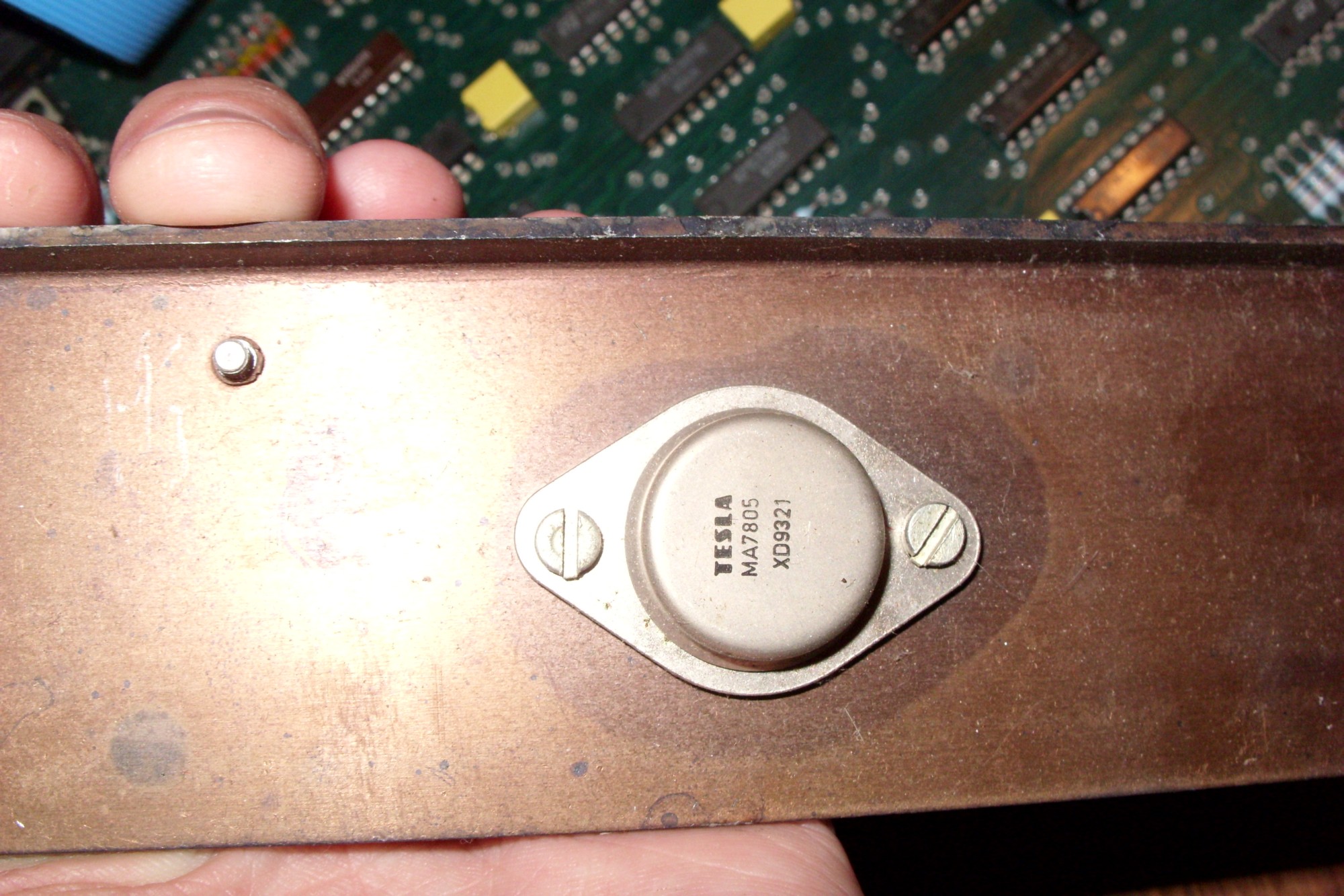

And they have no vents. Not even the big 4700uF one on the power supply (not pictured). So GSC existed in '91!

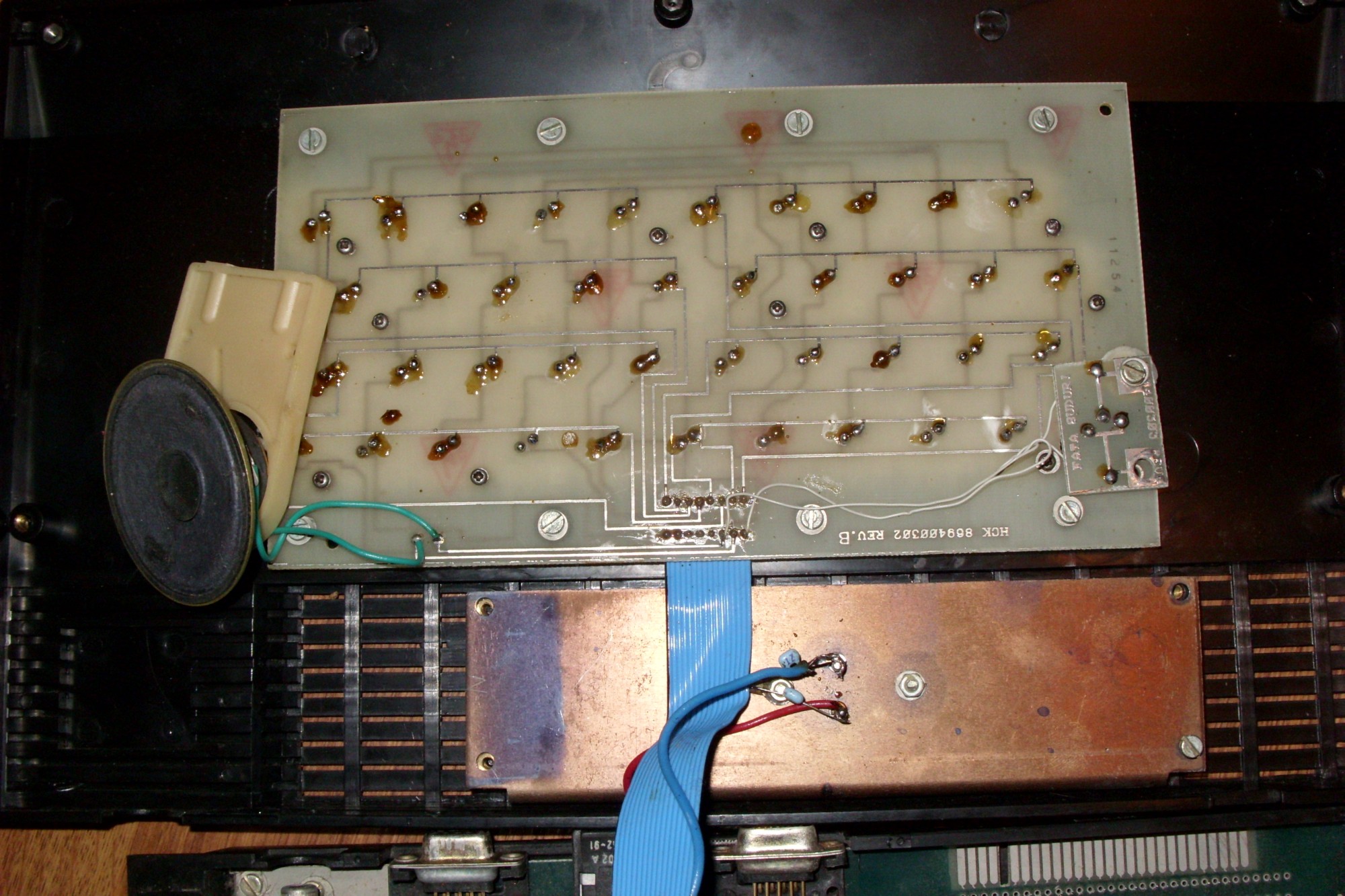

It had one really annoying aspect though - it had a big brick of a supply. Also the cable was wonky and easily disturbed. I fed it with a little SLA i had, however the linear reg it had built in would eat it in an hour or so. And i had other plans for that heatsink...

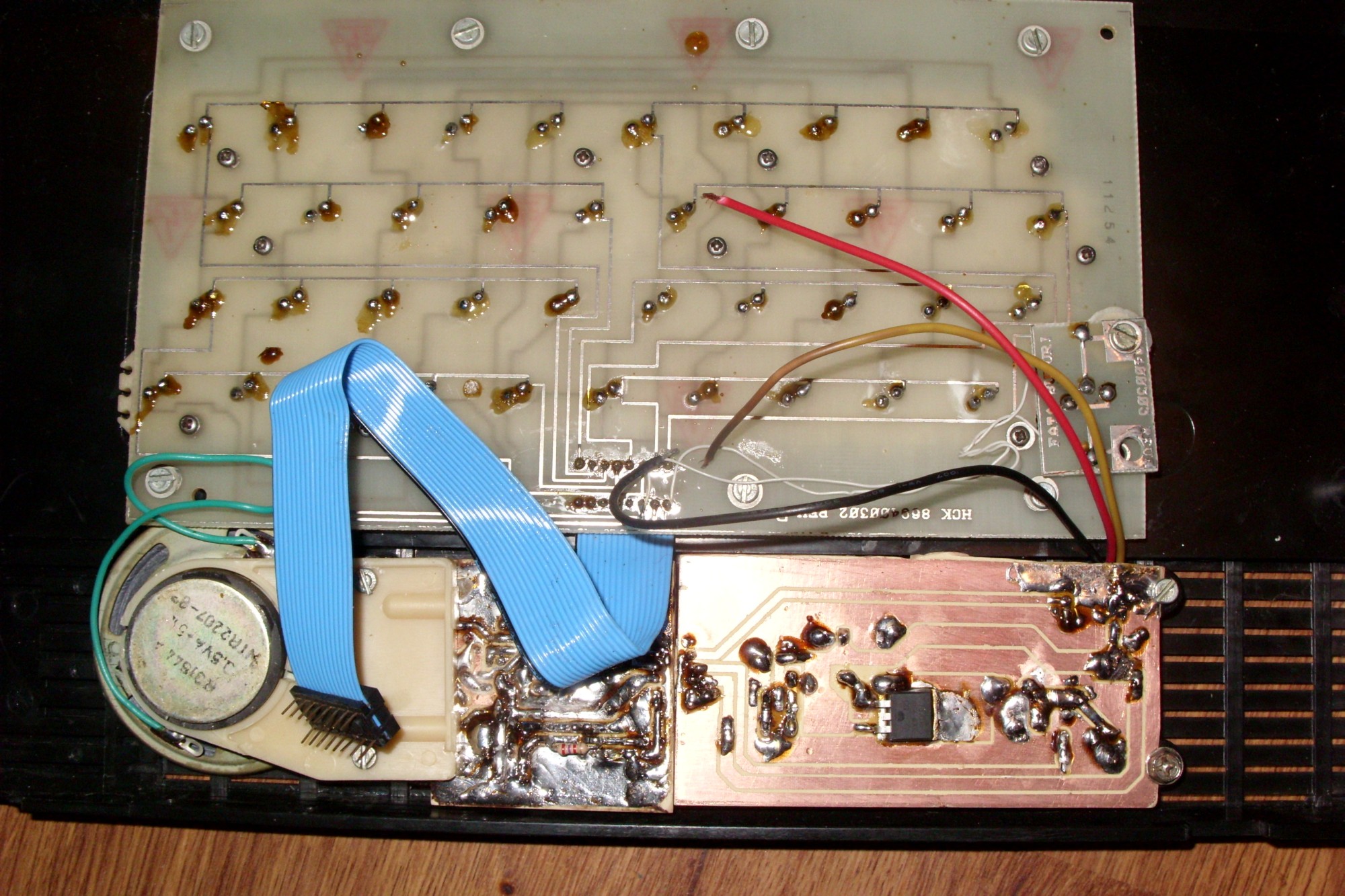

So, i built a switching power supply for it!

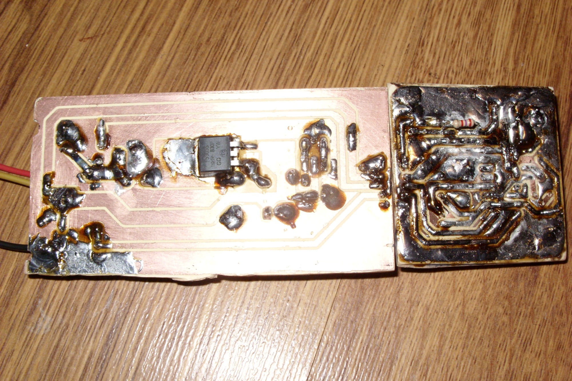

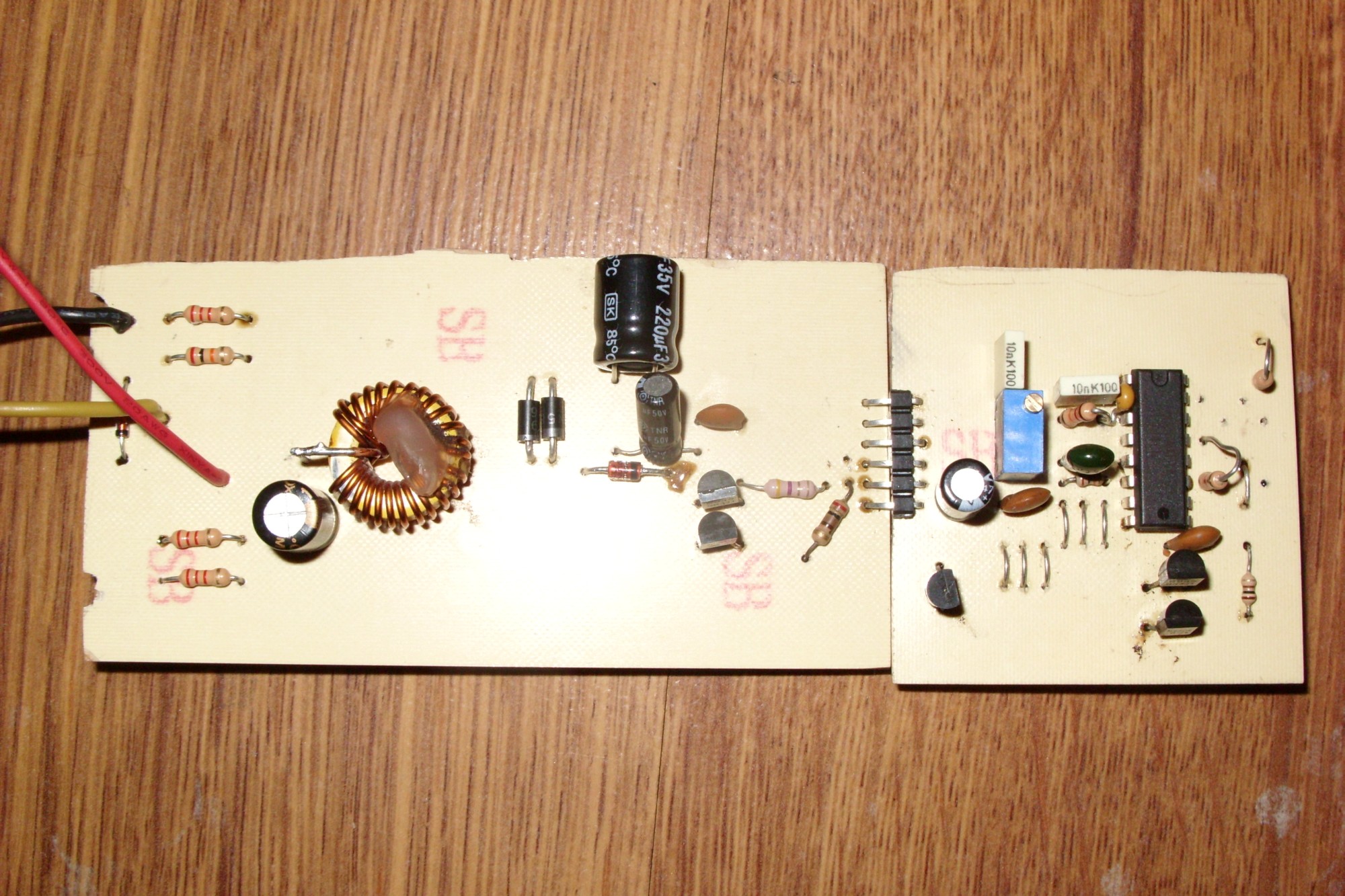

It is a simple buck converter using a p-channel mosfet, and a TL494 as controller. I used the same controller board i had designed for my 800W supply, so a few little mods needed to be made to it, but apart from that the supply basically designed itself. The inductor i think came from a 3.3v output in a cheap PSU, it is ~32uH and did not need to be rewound for my application. Since i had no other use for the second error amp of the TL494, i configured it to shut the supply down if input voltage goes over 25v. This is to avoid excess heating of the inductor - the higher the voltage, the higher the core loss. There is also a little 33v zener to protect the TL494 and the input cap in case i do something really dumb. Which isn't likely, but still.
Schematics and PCB layouts are available for whoever wants them. With bigger/better/more caps and diodes this could probably do close to 10A without needing a redesign - the power mosfet is this one. It was only $1.20, so why the heck not.
For the nitpickers:
Yes i wasted 3 transistors by using emitter output on the TL494, then i had to invert and buffer the signal again so as to drive the P-channel power mosfet, but the board was already made and i was too lazy to change it. Anyway it uses just 12mA when idle. There are also some useless copper areas left by the PCB software that crowd up the controller PCB, they will be removed in the next revision. As for the caps... this thing only uses 820mA at 5v so spare me. Input is 330uF 25v Jamicon SK, output is 470uF 16v G-Luxon LZ. Don't throw eggs at me already. The cap is rated for 730mA ripple with 0.093 ohm ESR and it doesn't even see 300mA in this application. Ripple measured ~90mvpp, which is a bit higher than the ATX spec... but this isn't a PC, it uses all 5v logic so it could care less. Oh and the sharp eyes have probably noticed a fukyoo 1uF cap in there. Along with that zener it forms the gate drive circuit for the mosfet. I chose that cap for a reason - it has around 1-2 ohms ESR. Hey look - built-in gate resistor!
Again, it'll last darn near forever in this application.

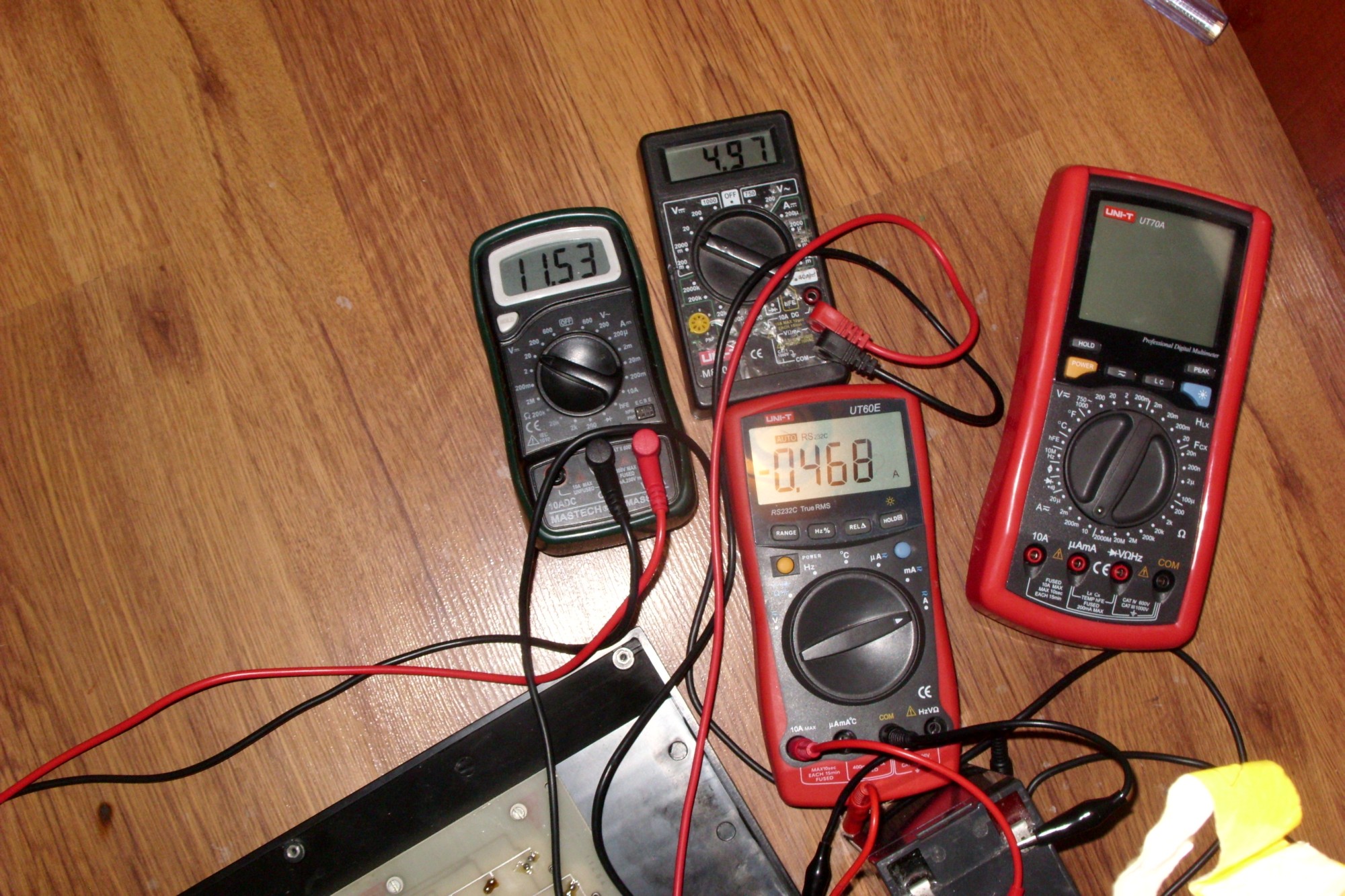

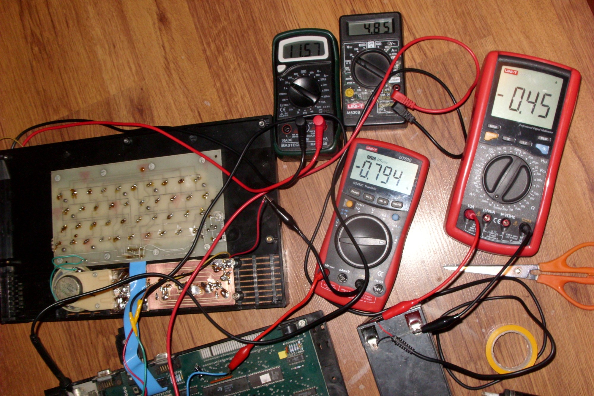

One last word on the measurements - at this low voltage the amp meter drop causes some serious errors as you can see in the second pic where the amp meter on the 5v output is removed, so the efficiency is a fair bit higher than you see in the pic with all the meters hooked up. On a bench supply the HC uses 0.82A @ 5.0v, which makes the actual efficiency 78.7%. Not stellar, but most of that is wasted on those rather lame diodes (2x 1N5819). With little effort this could be turned into a synchronous converter and achieve over 90% efficiency with ease, but at this power level, why bother.

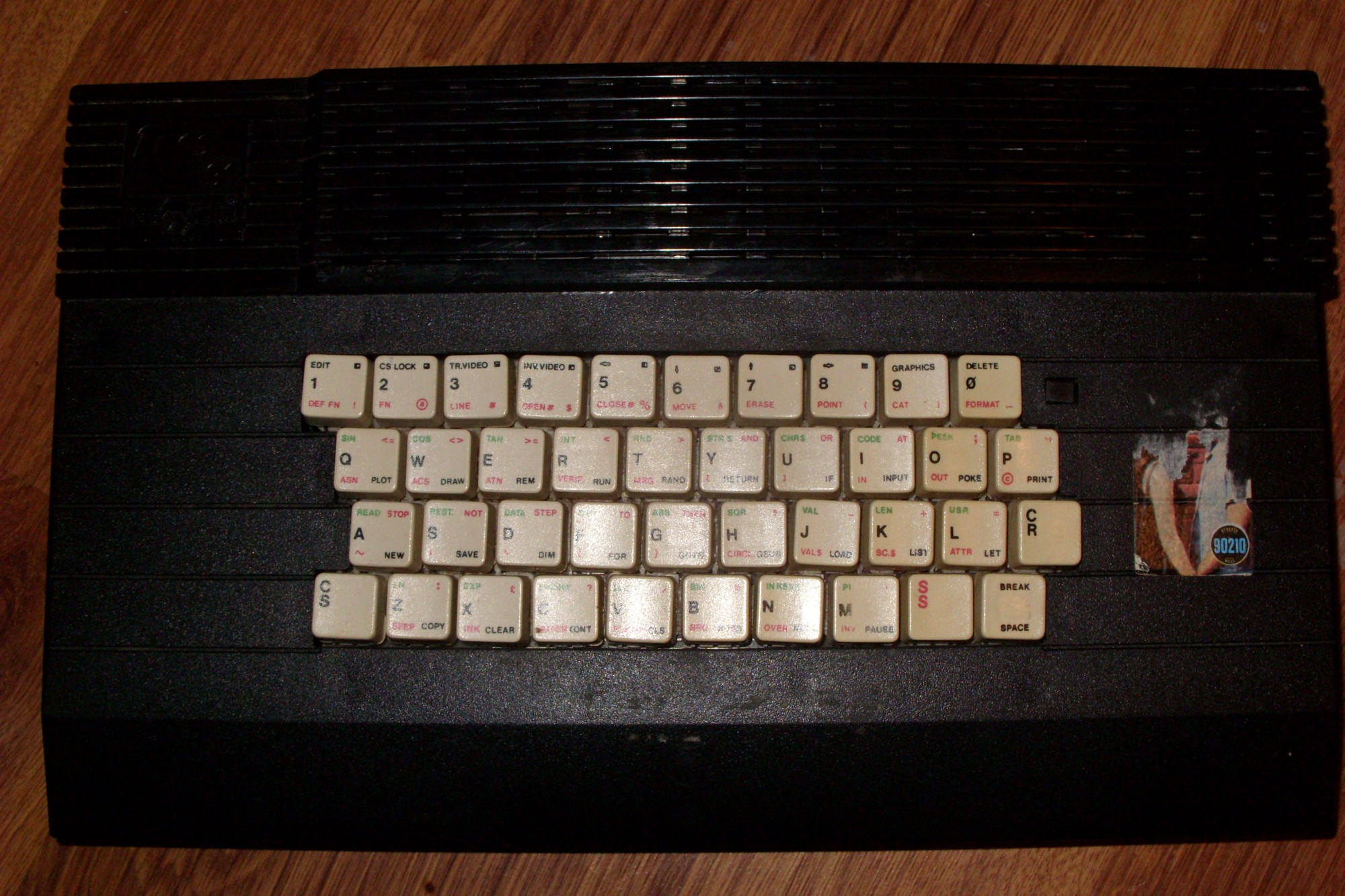

Here's the machine complete with old sticker from chewing gum. It needs a little makeover but i'll take care of that later.
