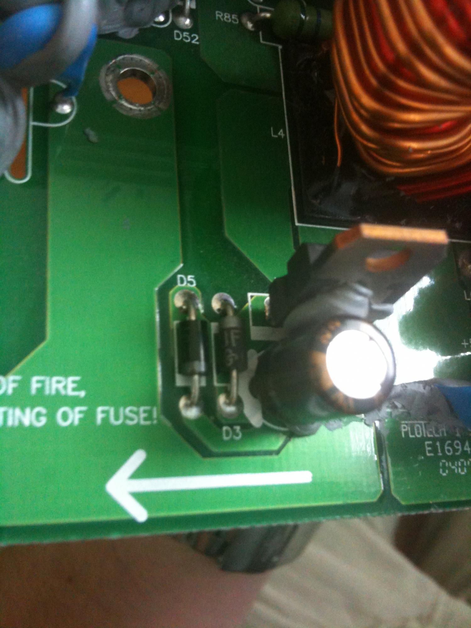

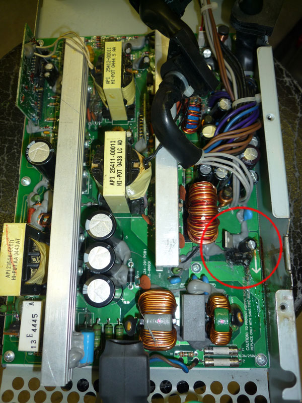

    i'm new on this forum, and my english is (very) poor (sorry I'm french )
    My PowerMac G5 have watercooling problems and i try to change the burned parts off the power supply (ACBEL 614-0306).
    But some are so burned that i can't read the ref. (see here : http://forum.macbidouille.com/index....=post&id=37116)
    Is anybody could help me to find those ref (D3-D5-W3-M1-C7 ...)
    Thank you

                Exactly what model G5 tower did this come from? This does not look like any I've seen. If it was a LiteOn PA-6601-1A I could help. Even the liquid-cooled machines I've had used a version of the LiteOn supply. Maybe someone else will recognize it! Sorry
                Another question and a suggestion. The coolant is actually a pink anti-freeze. Were you able to stop the leak? If so, you can either wait for someone else who recognizes it to post or you can try to locate one for sale online.

                  One more thought... go to macproonline.com. You will see your supply is rated at 600w and the equivalent of a PA-6601-1A LiteOn. Gives you another option if you decide to replace it!

                          Sometimes the best thing to do is buy a "PARTS" only version of your supply to identify the parts you need
                          thank you Godonr, but at this time, i don't want to buy a new power supply. Too expensive for an old machine.
                          I just try to repair mine.

                            I have a similar power supply however its a 614-0306 API2FS34-291 However, it looks identical to the one your describing. It's made by AcBel. I don't have a blown cap, however the relay clicks on and off when it was plugged in. Could this just be the relay or is it a larger problem that would possibly cause this?
                            • Toasty
                              • Jul 2007
                              • 4171
                              Re: ACBEL 614-0306 + PowerMac G5
                              You actually have an identical supply. -> All your numbers are the same.
                              The API number is what determines the -real- model and design of the supply.
                              API = AcBel Polytech Inc.
                              2FS32 = Model & design of supply
                              291 = Customer ID number. In this case, Apple.
                              With that information, you should be able to provide the information Nablabla is looking for.
                              See his post #1 - D3-D5-W3-M1-C7

                                The values are as follows:
                                D3:4UF400 (Not Sure where begining and end is, they run together)
                                03408G
                                D5:1N4005
                                Y349
                                W3: (Blue Tantilum Cap.
                                Front Side:
                                BS415
                                250V~ TJ50(Then Backwards 'S')
                                X1Y2 42
                                Back Side:
                                CS222M
                                M1:
                                L7912CV
                                WCCFUQ414
                                C7: 220uF @ 25V
                                I Had to de-solder the diodes because I couldn't read all around, I believe the second line on the diodes, tantilum capacitor, and M1 are probably batch numbers. I've also included a picture of the diodes to show how they are oriented in case the silk screen on the PCB is charred as well. Here is the link to the file on badcaps, sorry 1st time doing this.
                                https://www.badcaps.net/forum/attach...1&d=1304710410

                                  W3 - can be either an X cap or part of a Y cap setup. Its marking suggests it is suitable for either application and valued at 0.22uF. There are several more in the upper left of your photo, or lower left of the OP's photo.
                                  From its position, it looks to be filtering high frequency EMI from the output of the PSU. Doubtful that it is bad unless it is damaged.
                                  When used as an EMI and noise filter on the mains -
                                  X caps go across (X) the mains and are usually a single cap.
                                  Y's go from both sides of the mains to the chassis ground (forming a Y) and are found in pairs.
                                  M1 - is a -12v regulator rated at 1.5A
                                  D5 - is a regular 1A diode rated for 600v
                                  D3 - is UF4004, a 1A, 400v, high speed switching diode rated for 50ns recovery time
                                  C7 - I need the manufacturer and the series to get a match. Series can be a 2 or 3 letter code near the line with the temp and tolerance {usually 20% (M) }
                                  All of these are a quick Google away, and DigiKey seemed to have a majority of them.
                                  Toast

                                    Ltec is the manufacturer and the series is C(M) and it's temp is 105. I did'n't want to de-solder the cap but thats what I see so far down the side. I will be leaving for L.A. tomorrow and won't be back for a week to give more updates on this PSU. If you happen to have any suggestions for what would cause the relay to trip back and forth, I'm all ears. Normally I'm able to find the turn transistors, bloated caps, charred diodes, etc. But this PSU looks flawless, I have to say that the build quality on these is much betther than their iMac counterparts. Anyway hope this info helps.
                                    Scott
                                    • Toasty
                                      • Jul 2007
                                      • 4171
                                      Thanks for your help. I don't find a C series from Ltec, they use at least 2 letters, but that's not a problem.
                                      I'd recommend either a Panasonic FC or Nichicon PA/HE/PW, or UCC KY for the spot.
