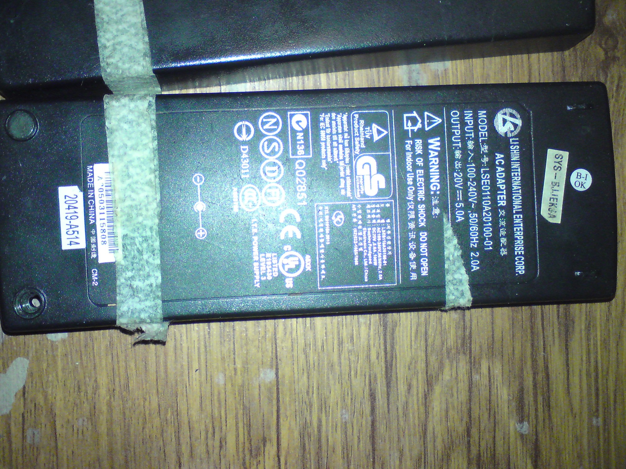

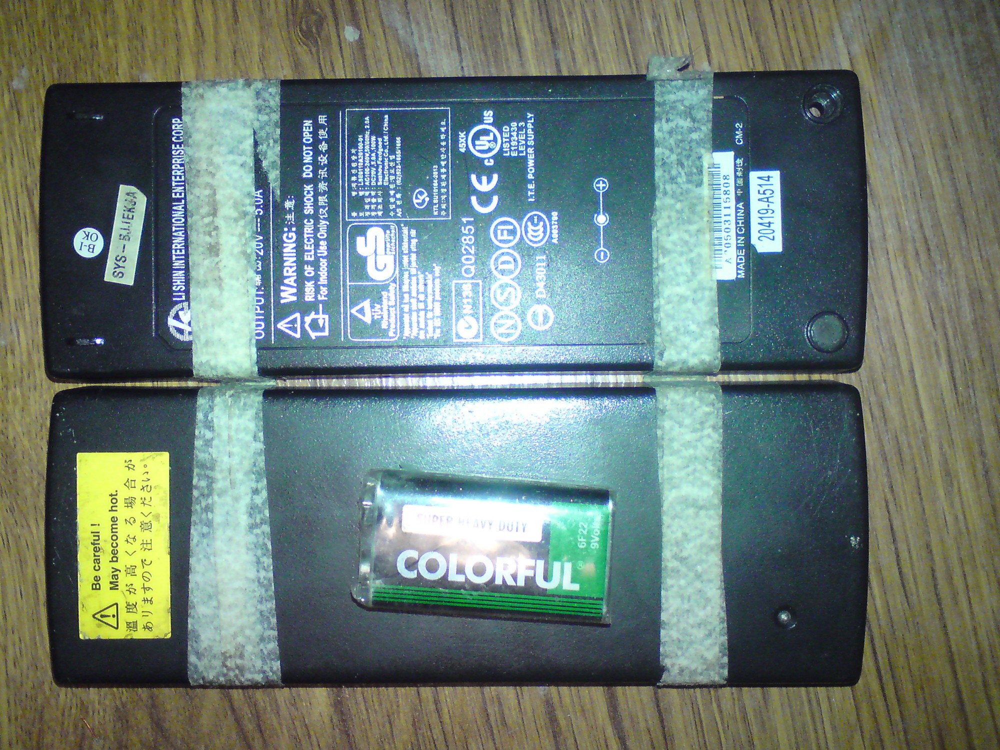

    I've had this power brick around for a while but never got around to posting it. Came from a Clevo laptop. 20 volts, 5 amps. That's 100W. Certainly not your average laptop brick.

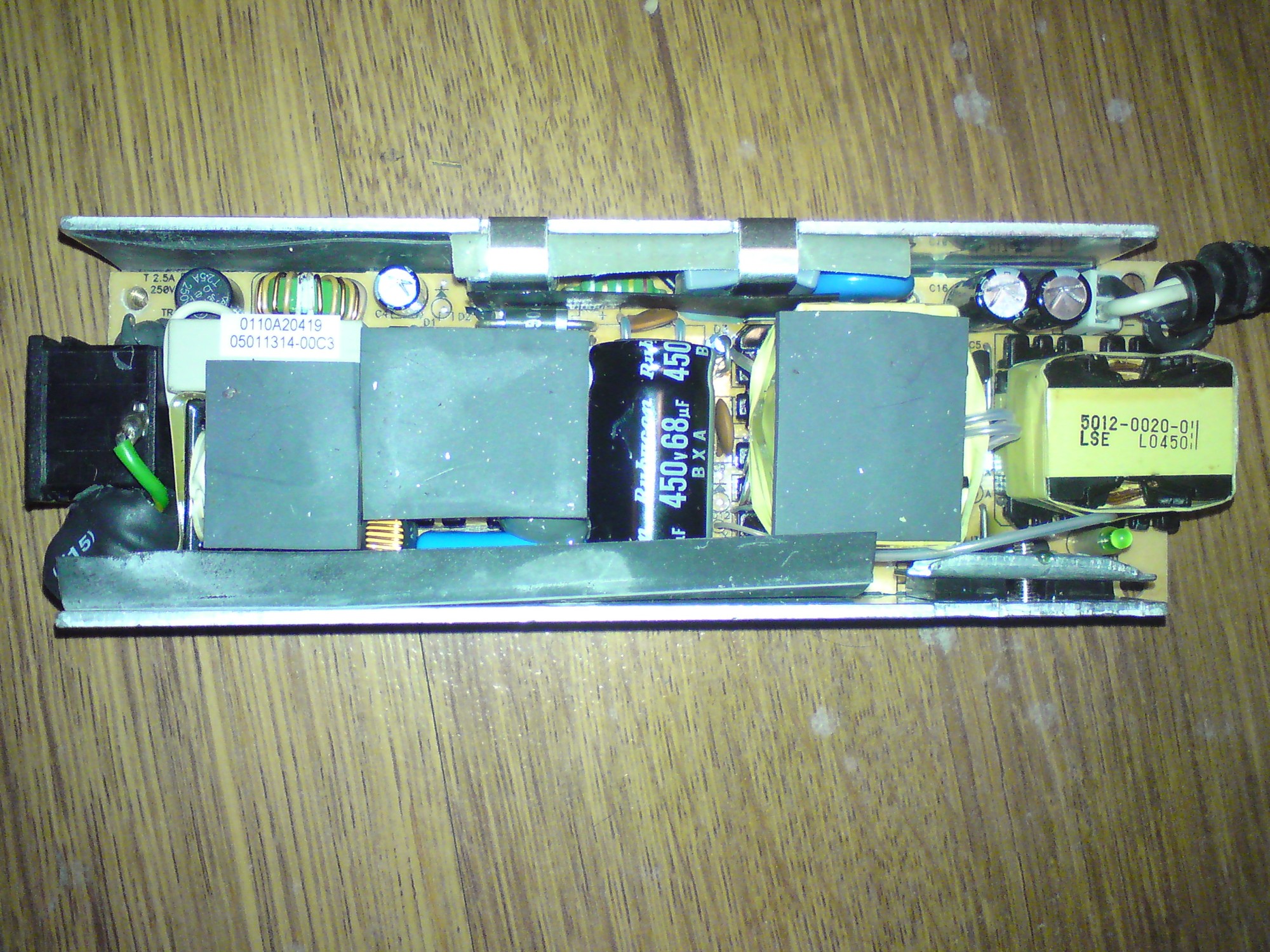

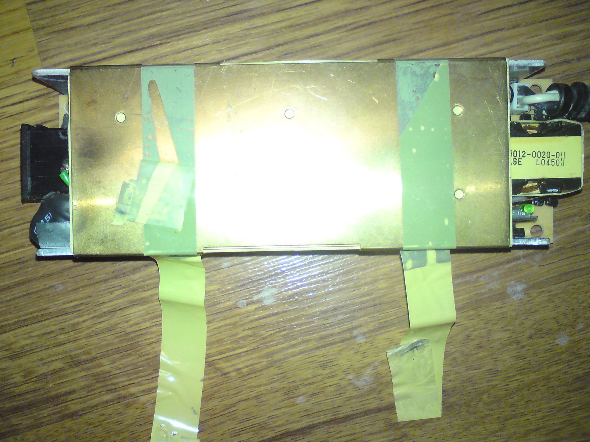

    It has a solid aluminum chassis (that a lot of stuff is screwed or clamped to). It has a copper top. It has a "Be careful! May become hot" sticker. It even has thermal pads for the transformers. Heck, even the line filter gets a pad! All Rubycon caps. It works correctly, but it hisses quite angrily. Someone didn't get their control theory right. But it looks like a decent candidate for an adjustable supply.
    There are three ferrite cores. The last one next to the output connector isn't a transformer, it's the output inductor, the one in the middle is the main switching transformer, but i'm not yet sure what the first one does. Could be an Active PFC stage. For a 100W supply, that's crazy.
    The 9v battery in the first pic is to make you an idea of the scale. More pics coming tomorrow... as a sneak peek i will tell you this uses 2x MBR20100CT in parallel for output rectifiers. Overkill. Me like.
    Edit: The hissing stops once it is loaded up with 1A or more. On lower loads it hisses and whines to various degrees. Well, it was made to power a beefy laptop after all. Anyway. Does 5.9A without shutting down, voltage is in spec at exactly 20.0v, no load voltage = 20.8v. Haven't checked ripple levels yet, will do tomorrow. And we'll see how much more it can deliver.

        Yup... but it was a Celery D with a SiS video chipset. Not sure how THAT would need 100W. Btw, did a quick check of the ripple output. 100mV @ 1A, 120mV @ 5.9A, this thing is fairly steady. Sure, those numbers aren't stellar, but this is 20v not 12v, the output caps are just 2x 1000uF 25v IIRC, and there's no pi filter. Given those parameters this is a pretty good result. And altho this brick is fairly cramped, there's room for bigger output caps.
