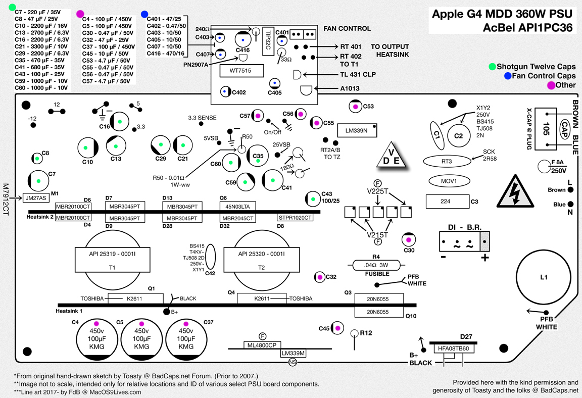

    CORRECTION: C7 Capacitor noted on the above MAP.jpg shows incorrect info. Should read : C7 - 220 uF /35V

      Re: Suspect Bad PS Apple AcBel API 1PC36
      While you're at it, would you change the Yellow dots to something that contrasts better? Orange, purple, polka-dot...
        Purple it is.
            Thanks to folks on this forum (Toasty especially) for everything on this and related threads which enabled me to repair the ACI1PC32 unit in my G4 MDD. This is my experience for the record…
            Initial symptoms: power light flashed but no boot. On removing the PSU, I measured good standby voltages but no 3.3/5/12 on grounding power-on. The fans twitched but that was all. I pulled the guts out and could measure good B+ (370v). There was no evidence of bulging caps or other distress.
            First, I replaced 10 of the 12 shotgun caps using this fine list (https://www.badcaps.net/forum/showpo...&postcount=112) from Digikey. I was able test and eliminate C7 in circuit and C8 by removal. None of the others was bad but a couple were leaky. I used this excellent ESR meter: https://www.digikey.com/product-deta...004-ND/9687220 Sadly, this didn't do the trick, so I ordered the 7 of the 10 “other” caps (the big guys C5/C4/C37 tested healthy in-circuit and certainly seemed to work well).
            From various discussions, it seemed like C45, C32 and C30 might be the next suspects. So I pulled and tested those. C45 and C32 had a high ESR but they weren't completely fried .. and C30 was too small to check. I replaced these, retested and .. praise be! .. all outputs fired up. So I applied new silicone caulk, partially re-assembled and re-tested. Nothing. Back to standby only. Rats.
            At this point, I could only guess that other caps were marginal. So I pulled C53/C55/C56/C57. I could only test the 4.7uF guys and they both checked good. But replacing all of them indeed got it working properly. So I can only conclude that one or both of the small 0.47uF caps were the culprit.
            Note that the best way to deal with the original adhesive caulk for me was to cut between caps with a modeling knife so that each cap could be easily desoldered individually.
            Also: after a test, to safely discharge and measure the high voltage on the primary caps, I'd hook a multimeter between B+ and R4, the PFC current sensing resistor, and used a 10K+ resistor to bleed between meter terminals. Otherwise, it would take at least 20 minutes to discharge adequately. This was after It'd been tickled once!

                                Hi everyone! Does anyone know where a schematic for this AcBel API1PC36 power converter can be found?
                                I'm currently troubleshooting three of these for personally owned Macintosh Mirror Door Drive systems but have no new significant insights to contribute toward the most common specific electrolytic capacitor component failures at this time. But I'll add my results when they arise.
                                I replace any relatively low voltage low capacity electrolytic capacitors with tantalum capacitors which of course provide the great advantage of being solid state and not inherently life limited. I view this option as limited to about 100 µF at 16 V or equivalent capacitance times voltage product, and almost never available at high voltages such as above 50 V. But I eagerly parallel them to avoid electrolytics too - I view five 100 µF 16 V tantalum capacitors as far preferable to a single 470 µF 16 V electrolytic capacitor for 12 V power rails for example. For capacities and voltages outside the range of tantalum capacitors I highly prefer hermetically sealed electrolytic capacitors when available, because:
                                Bruce: ChatGPT, polymer sealed electrolytic capacitors are life limited components which cause serious failure problems in long life electronics products. Are hermetically sealed, such as with glass or epoxy, electrolytic capacitors still available? If so about how much greater longevity to they generally provide, and very roughly what extra cost do they typically impose compared to similar polymer sealed capacitors?
                                ChatGPT: Yes, hermetically sealed electrolytic capacitors are still available in the market, particularly for applications where longevity and reliability are critical. These capacitors are sealed using glass or epoxy to create a hermetic seal that protects the internal components from environmental factors such as moisture and humidity. The hermetic seal ensures that the electrolyte inside the capacitor remains stable over time, reducing the risk of electrolyte drying out or leaking, which are common failure modes in traditional electrolytic capacitors.
                                The longevity of hermetically sealed electrolytic capacitors can be significantly greater compared to polymer-sealed capacitors, depending on factors such as operating conditions, voltage stress, and temperature. In general, hermetically sealed capacitors are designed to have a longer operational life, often ranging from tens of thousands to hundreds of thousands of hours, or even longer in some cases.
                                As for cost, hermetically sealed electrolytic capacitors tend to be more expensive than polymer-sealed capacitors due to the additional manufacturing processes involved in creating the hermetic seal and the use of high-quality materials. The exact cost difference can vary depending on factors such as capacitance, voltage rating, size, and manufacturer, but in general, you can expect hermetically sealed capacitors to be several times more expensive than polymer-sealed ones.
                                Despite the higher cost, hermetically sealed electrolytic capacitors are preferred in applications where reliability and longevity are paramount, such as aerospace, defense, medical devices, and industrial equipment, where the consequences of capacitor failure can be significant.
                                In my view the considerable labor required to remove this power converter from the Macintosh MDD, plus the additional considerable labor required to replace capacitors well warrants upgrades to tantalum and hermetically sealed electrolytic capacitors. Otherwise we trap ourselves in an eternal rather short cycle time and effort intensive maintenance task. This particular power converter seems reliable except for capacitor failures, as does the Macintosh MDD. So for those who wish to preserve this computer tantalum and hermetically sealed electrolytic capacitor upgrades, where available, seem like a worthy investment.
                                (The RTC (real time clock) battery is a corrosion time bomb and the only other inherently life limited component. I replace them with super capacitors as described here.)
                                All just in my personal view of course... Cheers!

                                  I repaired one of my five MDD power converters, crudely but sufficiently, in the process developing the following approach which replaces many life limited electrolytic capacitors with unlimited life MLC (Multi Layer Ceramic) or tantalum capacitors, or longer life PAE (Polymer Aluminum Electrolytic) capacitors, and minimizes new component ordering complexity by substantially consolidating the range of values.
                                  The consolidation is practical because none of these capacitors appear to be utilized in frequency or timing related circuits but rather only filtering roles, where more capacitance is essentially always better (and where if capacitance degradation occurs the power converter will nonetheless remain functional for a longer time). I've yet to prove success in all consolidation cases, but many were successfully implemented in my first crude repair and I'll test the full array later.
                                  I couldn't find suitable hermetically sealed electrolytic capacitors so the PAE option seems to be the best practical alternative to ordinary aluminum electrolytic capacitors in these times.
                                  I purchased from the vendors linked. Values must be selected from the arrays provided on the linked pages.
                                  This completely ignores all values above 1 mF. I judge those as much less troublesome but of course they could be replaced too, such as from this vendor (the same as the 1 mF PAE vendor below), for a fully thorough capacitor upgrade.

                                    Please ignore my previous post, or better yet moderator please delete it. Here's a more refined version, with previous mistakes corrected, for a more thorough restoration:
                                    I repaired one of my four AcBel API1PC36 MDD power converters, crudely but sufficiently, and in the process developed the following approach which replaces all but three life limited electrolytic capacitors with unlimited life MLC (Multi Layer Ceramic) or tantalum capacitors, or longer life PAE (Polymer Aluminum Electrolytic) capacitors, and minimizes new component ordering complexity by substantially consolidating the range of values.
                                    The consolidation is practical because none of these capacitors appear to be utilized in frequency or timing related circuits but rather only filtering roles, where more capacitance is essentially always better (and where if capacitance degradation occurs the power converter will nonetheless remain functional for a longer time). I've yet to prove success in all consolidation cases, but many were successfully implemented in my first crude repair and I plan to test the full array in April 2024.
                                    This ignores the three 100 µF 450 V primary side rectified line storage capacitors. I judge those as much less troublesome but of course they could be replaced too for a complete electrolytic capacitor upgrade.
                                    An illustration of the board's capacitors and everything below "Original Capacitors, 28 total:", in some cases with my very modest refinements, is compliments "Toasty", FdB 'a.t' MacOS9Lives.com, and perhaps others, thanks tons all! To wit:
