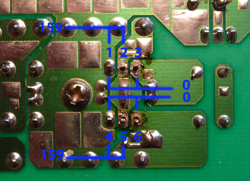

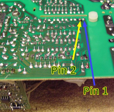

Soldering to Pin2 would be next to the square solder pad. (?)
Found a piece of 24ga wire should be good (better than the 16ga next choice)
Need to ask (because I've wondered) - I did the cap soldering with a chisel tip and wonder if I should have used a needle tip. The chisel tip seems to melt the board solder 'almost' before it touches (fast at any rate)?
Measuring the 3.3/5/12 would be as done when checking voltages initially (using a pinout diagram and instructions)?
