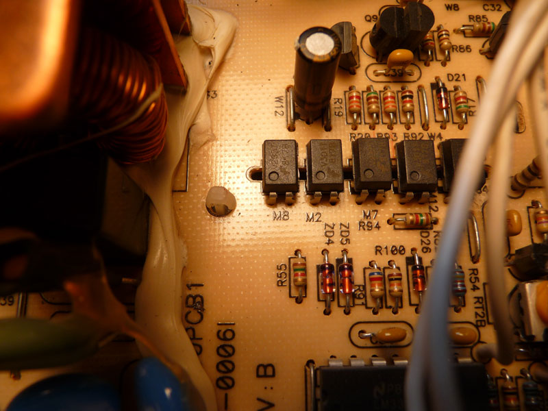

                    #49
                    Re: Suspect Bad PS Apple AcBel API 1PC36
                    Check opto M8. Measured from output ground, the first pin on the "cold" side (square pad on solder side, or lower left in your above picture) should read 5v. Pin next to it will read 5v until the supply is jumpered on. It should then read 0.1v or so. If it reads near 5v (i.e. 4.3v), then the OV/OC protection is kicking in.
                    That would indicate that perhaps one of the replacement caps is bad. Do go over all your solder work to be sure a "cold joint" is not causing this problem.
                    If the fans in the supply were functioning, I don't see how the system fan blockage would cause a problem, unless the whole unit got very hot...?

                      #50
                      Toast .... let me know when you've reached your limit on 'hand holding' or if you've put enough time in to this. I appreciate your help but lack considerably in 'understanding' electronics etc. That said ....
                      I attached a photo of 'opto M8' that I think you are referring to. I'm unable to understand the instruction for checking voltage on this. Is this test done on a 'hot' board? or at the connector where it's jumpered? (first pin / cold side / square pad?)
                      I've re-examined my soldering. Is a cold joint where you have a lead soldered solid but no solder down the hole? No question some of my joints are not as uniform as the originals - maybe I should touch them up (a little heat and a touch of solder).
                      The fans were working without question. I checked the warm output many times while the machine was running. I had a thermometer in the case placed right at the intake to the PSU and the hottest it ever got was 118ºF. The software TempMonitor was reading the CPU and it was at 72ºC when it shut down. I sat and watched it rise from normal to 'hot' - so it wasn't 'hot' for more than a few moments.

                        #51
                        Yes, hot board.
                        Measure Pin 1 & Pin2 on the opto when hot but -not- jumpered on. Then jumper the supply on and check Pin 2. It should be around 0.1v or so. If it goes high as I said, that could mean the OC/OV has kicked in or that the OC/OV chip has failed.
                        Cold joint = poor solder joint. It moved after you soldered it, it cracked, it wasn't hot enough to flow solder correctly, the solder didn't stick to something... Pick one...
                        Just check all the joints you did.
                        Try to monitor the 3/5/12v lines when you jumper it on. See if anyone looks low or high. I know it's tough with a DMM and such a short time span. Most react too slowly.
                        Also, make sure you didn't put a cap in backwards. It happens.

                          #52
                          Ok, now I know which pins you want checked - I'm not sure where to check from (i.e. where does the black lead touch to)
                          Duh!!! ... just a little dense so .... hot board no jumper pin 1 5v and pin 2 4.65v.
                          hot board jumpered pin 2 4.44v

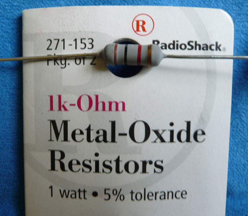

                                        #59
                                        So I struck out and wound up at the Shack .... this is what they had --

                                          #60
                                          Fine.
                                          We're going to 'fake out' the PSU for testing.
                                          Carefully solder a piece of wire, 8" or more, to pin 2 of M8 on the solder side of the board.
                                          Solder the other end of the wire to one end of the resistor.
                                          Jumper the supply on as usual. (Pin 11 - green wire to ground)
                                          Touch the other end of the resistor to any of the black (ground) wires on the PSU output plug.
                                          Measure the voltages for 3.3/5/12 and report the readings.
                                          If they all are fine, then the supervisor IC has likely failed.
                                          On the "daughter board" on the output side (where the fans plug in) is where the supervisor chip is. Looking at the daughter board from the side, notice that the it is attached to the main board with a single line of 17 pins. Measure the voltage on the 5th pin from the left, with the resistor jumper connected and disconnected.
                                          Report.
