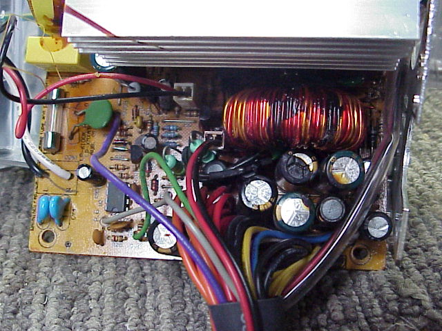

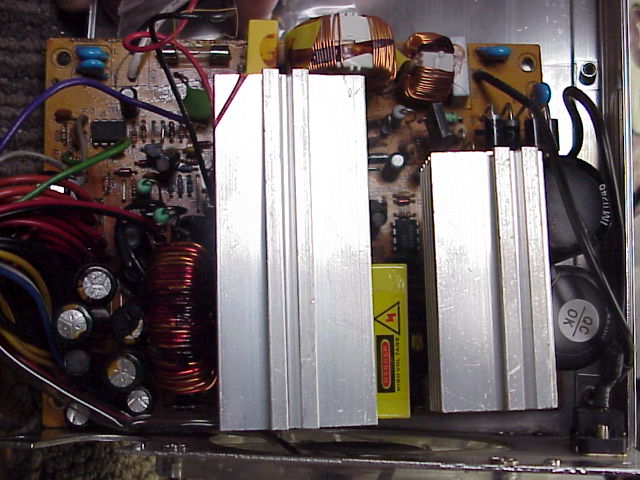

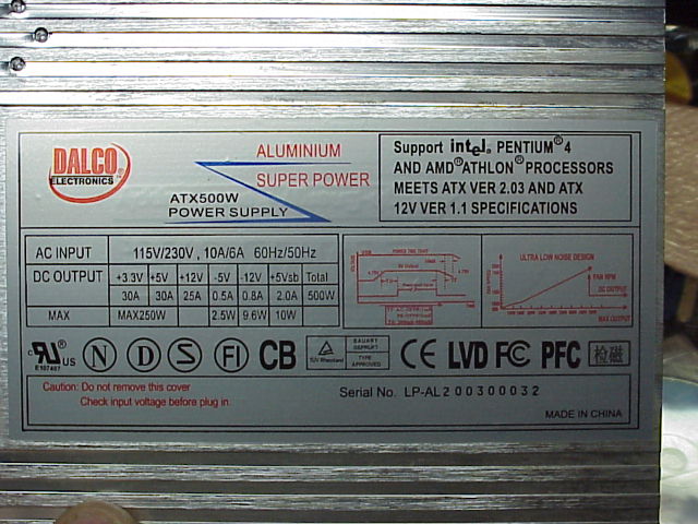

    dalco atx500w(powmax re-label)
    dalco is a local pc parts distro.
    this appears to be a rebadged powmax in a pretty case.
    same crap different day
    a mix of jee,asiacap,and teapo
    several of each blown open.
    this is less than a year old.
    dont let the pretty aluminum case fool you.
    500w my ass!

    What is the black stuff on the cap in the middle that does not look blown? Same goo that looks to be on the coil?
    • Rainbow
      • Aug 2005
      • 1374
      Re: dalco atx500w(powmax re-label)
      Looks like some kind of crap-glue. Maybe the one that's yellow and turns brown somewhere (from heat?) - I've this in some PSUs.
        its cooked glue and cap juice.
              Epoxy with an electrolyte chaser? Do you take that with an olive or a maraschino cherry?
