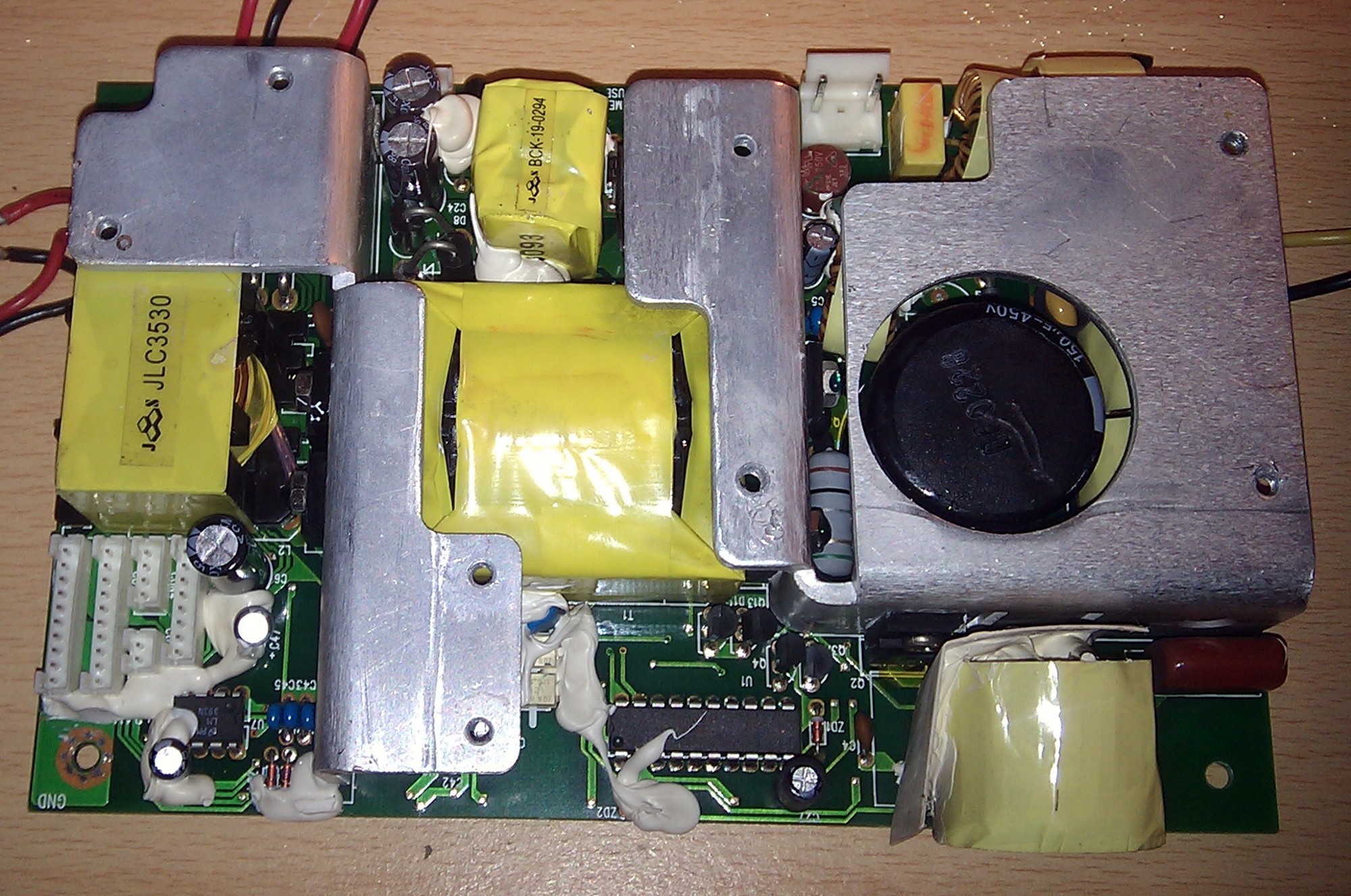

      Okay - my low ESR caps arrived today. I soldered them in and it made no difference.
      There is still a noticeable high pitched squeel coming from the PSU that concerns me.
      Is it possible that the main 450V cap is gone too? I can't see any swelling on it.

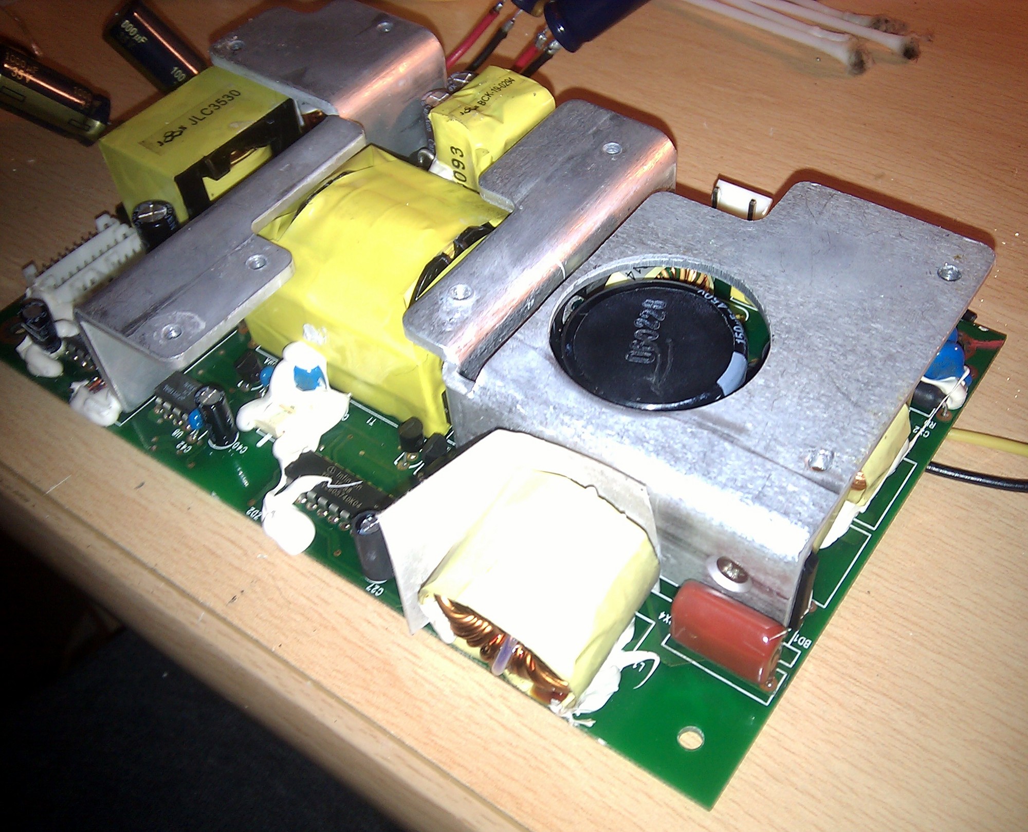

            I've now resoldered every transformer and toroid coil on the board.
            I measured voltages across the 400v cap (300V) and the 35V caps (25V).
            I found points on the PSU that should give out 12V and 24V. I get 11V and 26V respectively, even under load, which seem a little off tolerance - no?
            I switch on the power, I hear a whine/squeal and after a few seconds I hear the audio on noise, and see the inverters switch on for a second.
            I found the on/off pins for the inverter and wired these directly to the 5V supply - this caused the inverters to switch on as soon as I turned on the mains and switch straight off again. This removes the logic board from the equation I believe.
            If I'm not mistaken, the logic board makes 5V and passes this to the PSU, rather than the other way around.
            What should be my next step?

                By inverters switching on, you mean the CCFL's light on for a while? It probably means the inverter circuit is fine otherwise it won't turn on at all.
                Good start usually is to look whether all diodes, fuses and transistors are fine. Maybe some of them is shorted so it shuts down than. If this is not the case, there is no short and no cold-soldered joint, only two choices are left: shorted driving chip (bad) or shorted transformer (even worse).

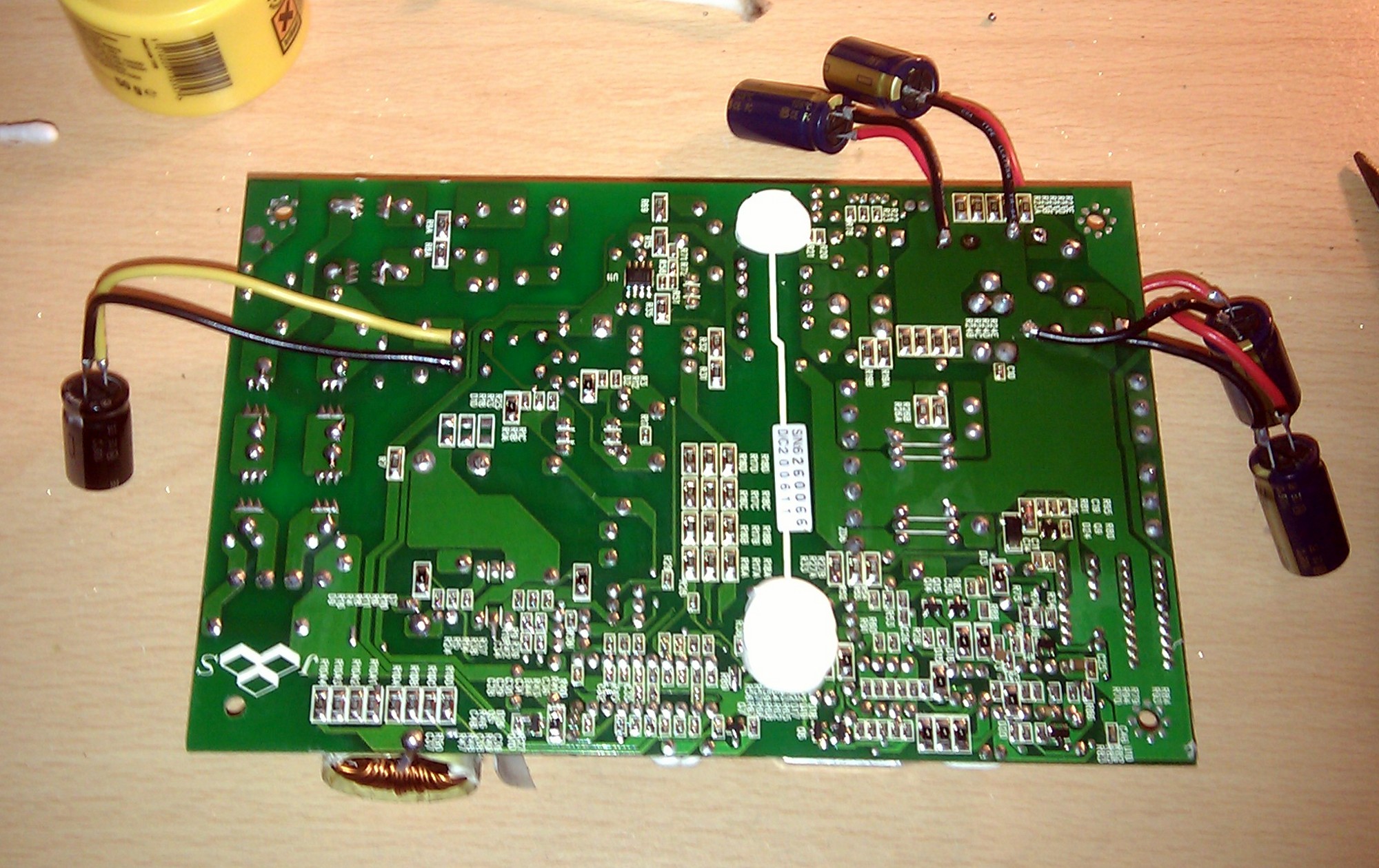

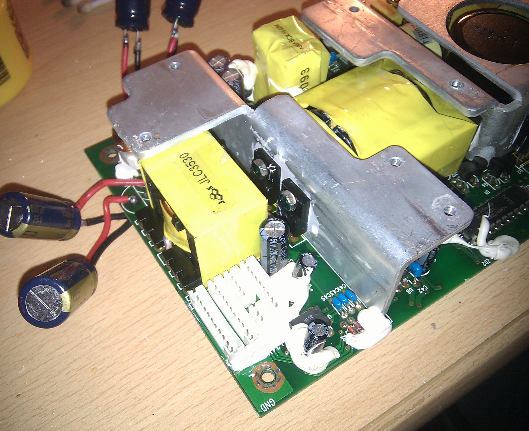

                    No, I've not replaced 100% all of them. There's a few small ones around. But I can't help but think that the noise I'm hearing is part of the problem - or at least, a clue as to what is going on.
                    I attached them to wires because there is a solid heatsink over the top of where the caps should be - it's pretty tricky to get in there, and this way I could be certain I had a decent joint. I didn't think it would cause an issue?

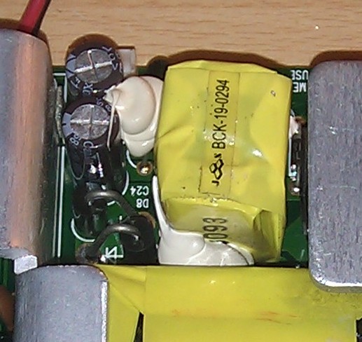

                            Right, I've managed to isolate the noisy component - a transformer labelled "BCK-19-0294".
                            I'm struggling a little on how to test this properly. On the back, I can see 5 pins on one side and 4 on the other - it appears to be a pair in and a pair out.
                            Resistance from left to right with my DMM set to 2000k, trying various combinations is around 1200-1500. Comparatively, the same technique on other transformers shows very little resistance.
                            Would I be correct in thinking that this transformer is shot?

                              It is rare for transformers to fail on smps. Usually, a failed transformer will be indicated by severe charring or dark colouring of the windings and perhaps cooked pcb pads. Your transformer is in pristine condition and it is not the main switching transformer but more likely a feedback isolation transformer.
                              To me the problem seems to be more that your inexperience with smps repair means that you are plucking at straws or fishing in the dark for the failed component/s. Unless you can get a schematic of the power supply you will have trace out the circuit and draw your own schematic. Even then, once you have replaced the usual suspects (output filter caps) there may be other faults. Because these devices have feedback circuits it is often difficult to get them up and running untill all faulty components have been found. Even I have been forced to admitting defeat on one or two occasions after I have swapped almost everything that can be swapped. Thankfully, that is a rare occurrence.

                                If you have replaced all the 1000uF caps then it seems that C8 could be a likely culprit.

                                  C8 is a tiny cap, very close to the transformer I'm hearing noise from - so it makes sense that this would be worth changing. It's a bit tricky to get to, but I'll give it a shot!

                                      I think removing the caps from their extensions might help - but there is just no room on the PCB!
