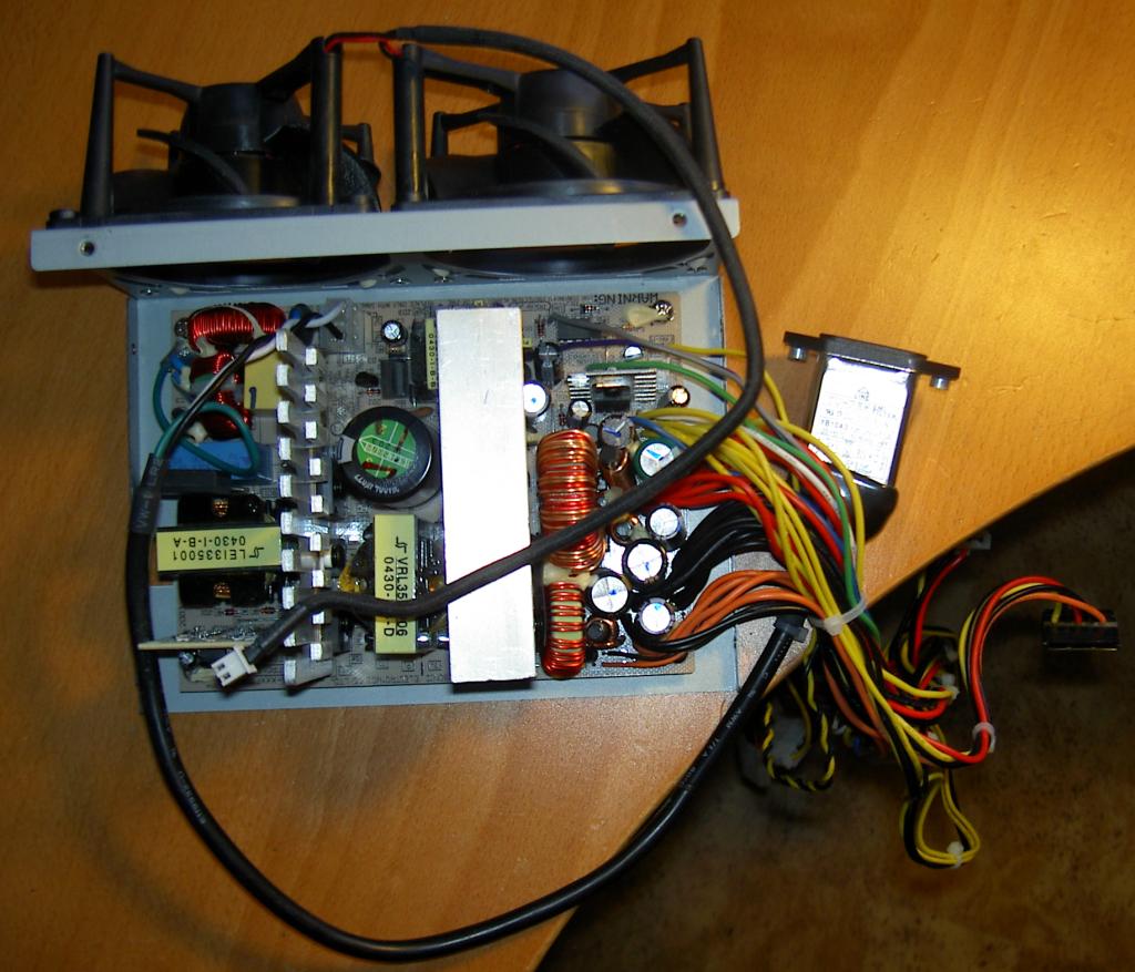

Here is a pretty cool Seasonic powersupply, it has two custom designed temperature controlled 80mm fans on it's top and is located at the bottom front (a la Lian-Li) of the Arctic Cooling Silentium T2 case. As far as I know this is the only place you will find this PSU.
It is rated at 350w

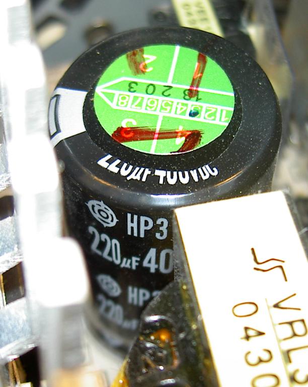

It has a 220uf primary cap that I would really like to know what manufacturer it has, according to an e-mail I got from Seasonic they use Hitachi caps in their powersupplies... It is makred "HP3 85°C 220uF 400VDC" and "38B5" on it's back... with this logo:

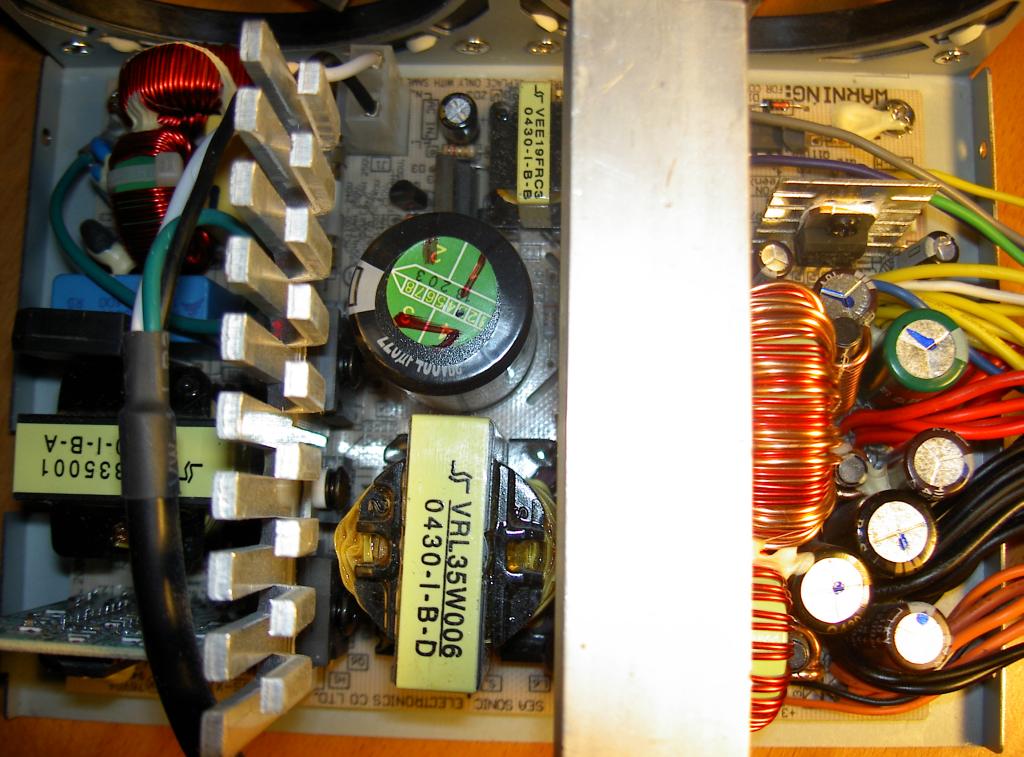

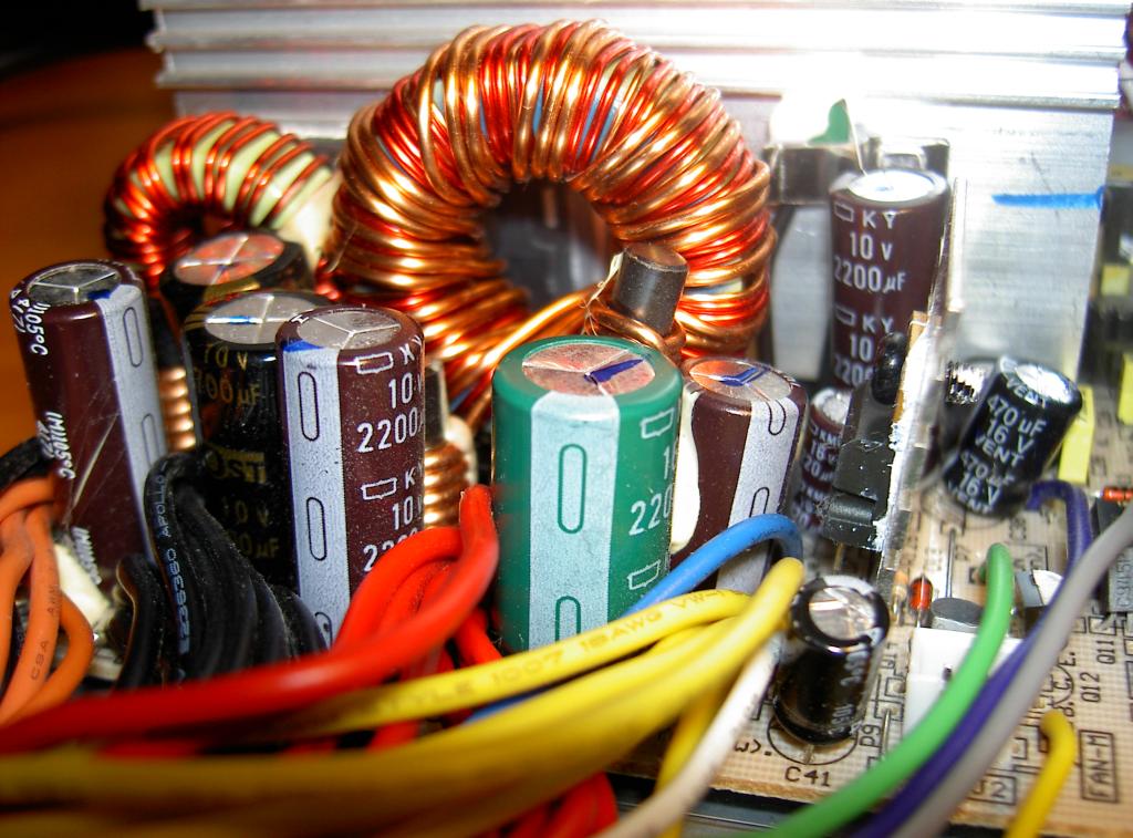

On the secondary side there is a real cocktail of capacitors... 6x United Chemi-con, 2x OST. 2x PCE-TUR and 1 Rubycon

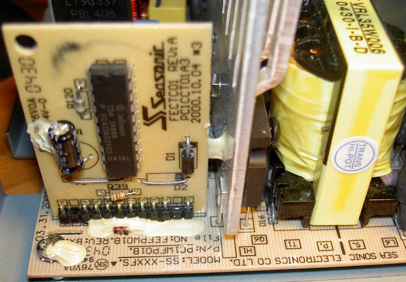

Pulse Wide Modulation (PWM) and Power Factor Correction (PFC) Control Circuit by Infineon TDA 16888 (And a 47uF PCE-TUR cap)

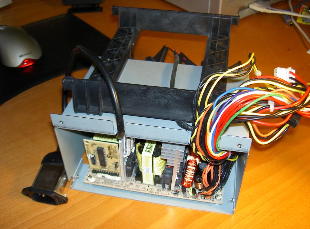

The PSU looks a bit strange since there is no bottom; it is provided by the T2 case itself...

Code:
BRAND: Cap(uF) VDC Max Temp: Date: Model: PCS: PCE-TUR 470uF 16v 105°C 0401 1x PCE-TUR 47uF 25v 105°C 0401 1x Rubycon 47uF 50v 105°C A0344 YXG 1x United Chemi-con 220Uf 16V (M)105°C 4(7) 3W KMG 1x OST 4700uF 10v 105°C 0430 RLS 2x United Chemi-con 2200uF 10V (M)105°C 4(7) 4a KY 3x United Chemi-con 1000uF 16v KY 1x United Chemi-con 2200uF 16v (M)105°C 4(7) 6G KZE 1x
