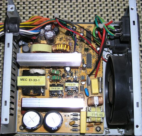

                Re: Power supply build quality pictorial
                Hairong ATX-400W
                10A 40V rectifiers for +3.3V and +12V rails (3.3V rectifier failed because it was not at least 20A, as marked on the specification plate )
                20A 40V rectifier for +5V rail.
                470uF 16V TUR series for each negative rail.
                2200uF 10V TUL series for +5V rail.
                2200uF 16V TUL series for +12V rail.
                1000uF 10V TUL series before and after +3.3V inductor.
                1000uF 10V TUL series before and after +5VSB inductor.
                470uF 200V (85C) "SC" brand primary units.
                Non-approved ceramic capacitors between line and earth .
                Primary rectifier appears to be a 2A unit.
                Heatsinks look a bit small too.

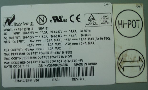

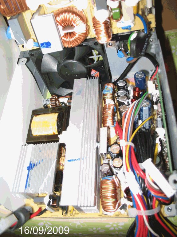

                      Following zandrax suggestion I have bought 2 PSU, I post here few pics.
                      I pay 15€ each and for the first time I think I have not spent my money for gutless wonder PSU.
                      I had some problem to mount one in my PC because Newton Power is longer than the previous Allied 450 W (1.2Kg ) and because my PC has too much stuff inside . One strange thing is that the holes to screw it on the cabinet are smaller than usual: they are 3MA.
                      I hope that my cabinet can support the 2.44Kg PSU.
                      I was lucky that the cap near 20Pin connector is small otherwise it would have been a problem since this PSU has a 24Pin connector.
                      Last thing: I hope those OST caps spread on my MOBO can go on for a long time since they look still good after 4 years.
                        15€?
                        so they're used, not new?
                          i would take a old unit like that over any allied "gutless wonder"
                          you did well.

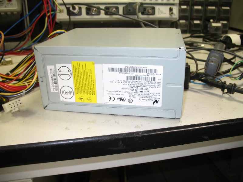

                                This morning I had the time ( few minutes ) to make a quick test of one Newton Power PSU I bought.
                                In the picture you can see it on my desk.
                                I measured the input power with my scope, here following the output voltages, current and input parameters:
                                +11.97 7A
                                +4.98V 15A
                                +5.1V .154 A
                                +3.26V 15A
                                -12.06 0.055 A
                                Pout= 208.8W
                                Pin= 273.7W
                                PA= 287.9VA
                                Efficiency= 76%
                                The input voltage is a little bit distort probably due to the safety transformer used to separate the equipment under test from live line.
                                I forgot to set the +12V current at 10A... I had not much time.
                                Thanks to the APFC, the VA power is 287.9VA against real (active) power of 273.7W so the power factor is around 0.95.
                                I tried to take the maximum inrush current and the best pic is here attached: the peak is around 12Apk, thanks to the input power resistor that get shorted, after few seconds from power on, by a relay.
                                Unfortunately I can't arrange the testing cables to bring the PSU at full load.
                                The last thing: the output ripple is low on all outputs, the worst value I measured was 30mVpp on -12V.

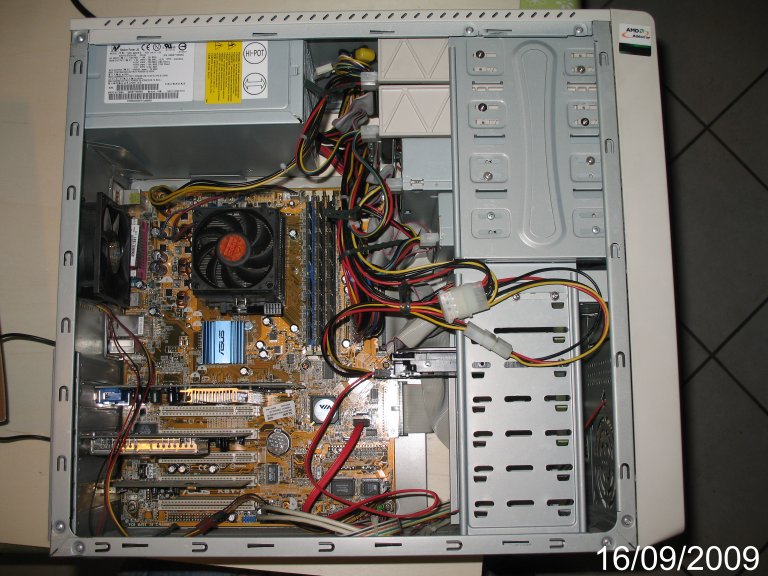

                                        Today I have opened a spare PC I had in my cellar: I rescued it few months ago and I have cleaned it up and changed the HDD because was dead.
                                        What I didn't do was to open the PSU and because today I had to lend it to my brother, I opened the PSU and i have taken few pics for this thread.
                                        The Newton Power mounted on this Scenic Fujitsu-Siemens have a passive PFC, the continuous output power is only 110W and should be enough to feed the 1GHz Celeron CPU.
                                        OTOH it is not possible to replace it with a standard PSU because the cabinet is not standard and the PSU has a plastic conveyor (hope it is the right word) to suck the air from CPU HS.
