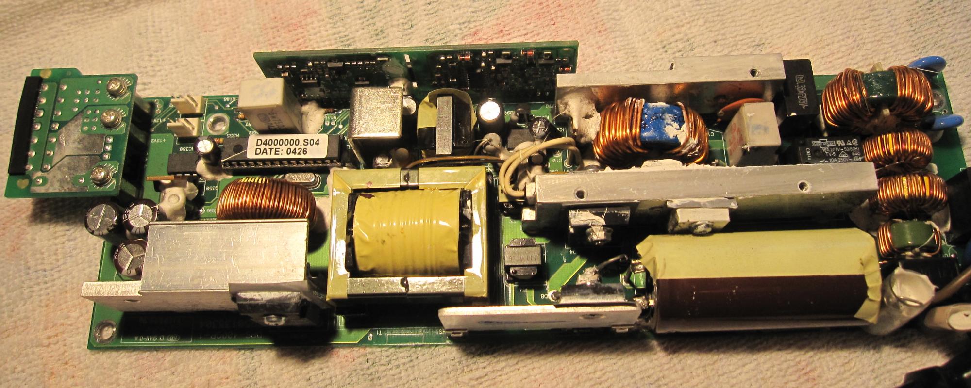

              Re: Delta DPS-400GB-1A Troubleshoot (xserve)

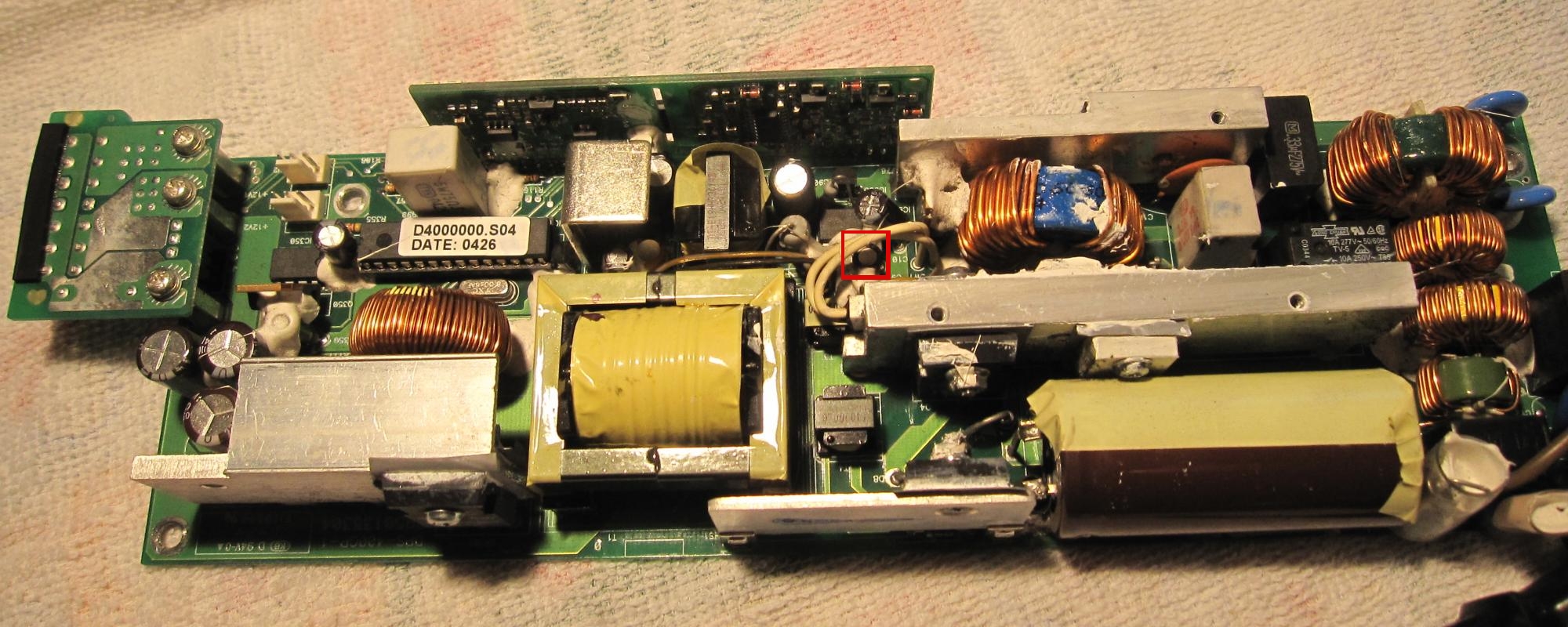

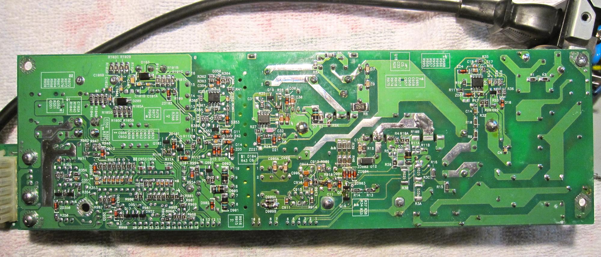

              Pictures of the board and components:
                Not the MOSFET's. Unblown fuses are the first clue.
                As was mentioned, the caps between the blue coil and the other side of the small transformer, under the "L" shaped heatsink, are the likely problem. A -lot- cheaper than chasing obsolete FETs.
                Your scope probe just held -near- the transformer should be giving a nice ringing wave form, not a sine wave. Looks like a pyramid on its side pointing to the right > . Set the scope for ~20mV and 10µS.
                Does this have any type of standby voltage output?
                  I resoldered the small transformer after a failed attempt to remove it.
                  The psu turned on! I could hear the buzzing and the relay click on.
                  I shut it off quickly so I could setup my voltmeter to test the output and when I turned it back on... nothing.....
                  Looking at the small transformer with the scope as toasty suggested, it appears as though it is trying to turn on, there is a ringing waveform about once a second, the big transformer is quiet.
                  I am going to start swapping caps out near the small transformer and see where I get.
                      Ahh, good! The heat from soldering the transformer warmed a nearby cap. Sometimes the "hair dryer" trick works. Sometimes the freeze spray.

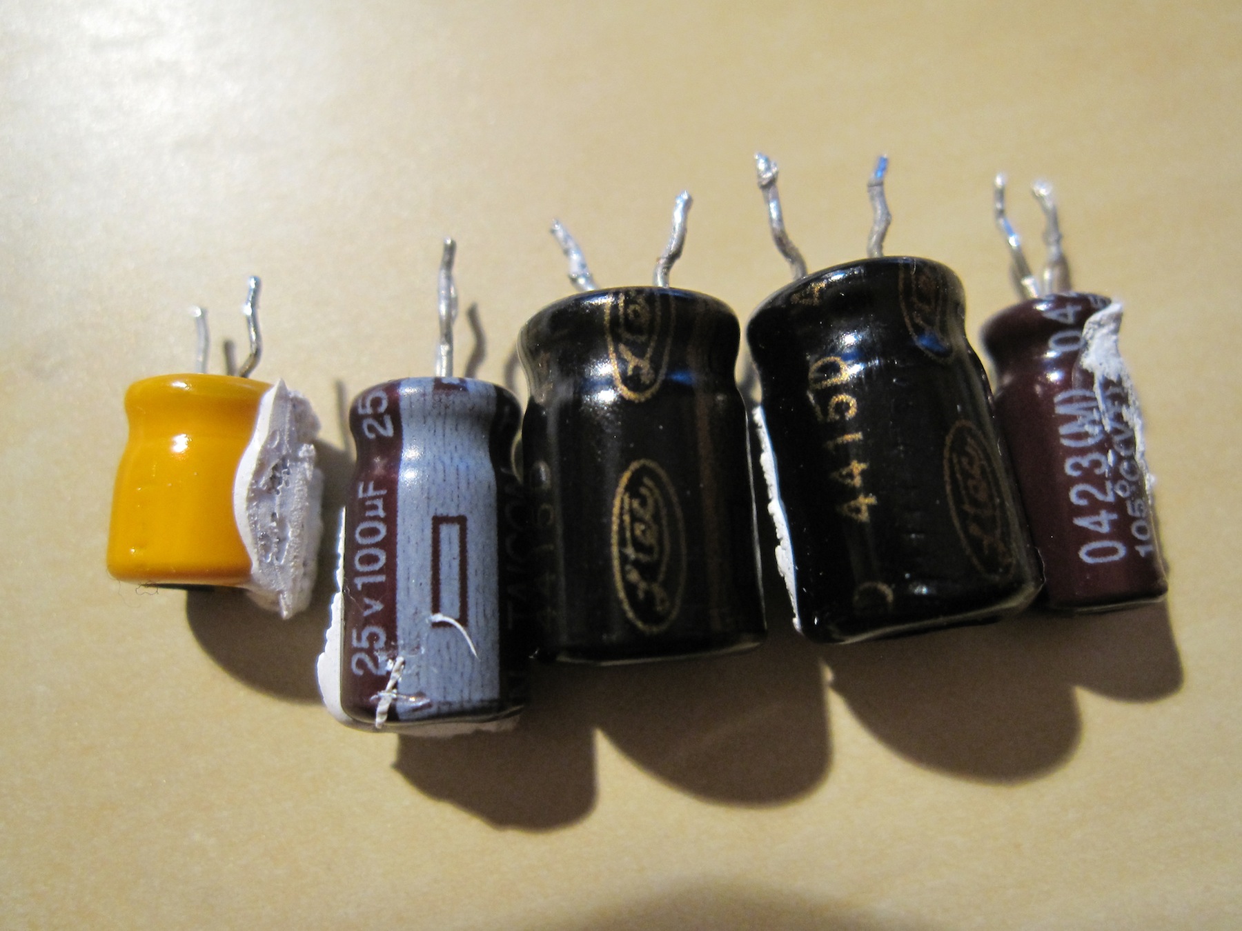

                            Could you add informations and some pics of the bad caps (for reference to another) ?

                            • brianc
                              • Dec 2010
                              • 11
                              Pics might take me a while. Supply is tucked back inside the server.
                              The caps didn't actually look bad, and seemed to test OK with my voltmeter. They must only go bad under load. There are 100micro25v on either side of the small transformer, another 100mF25v, a 10mF50v and a 47mF16v on the secondary side of the transformer that I replaced.
                              The primary switching mosfets were inactive during initial testing. There was some voltage on the output of the small transformer. On the scope I could see that the supply was acting like it wanted to start up when looking at the ringing of the small transformer as suggested by Toasty.
                              The filtering section on the 12v lines has 2x 2200mF16v and 2x 1000mF16v caps.
                              I replaced all caps with equal Farad values, but higher voltages.

                                • brianc
                                  • Dec 2010
                                  • 11
                                  The two that were closest to the transformer are labels as LTEC 100mF35v 4415D.
                                  The rest are TAICON, the 10mF50v reads 0423(M) 105C(VF)
                                  Here is what I was able to rescue from the trashcan.
