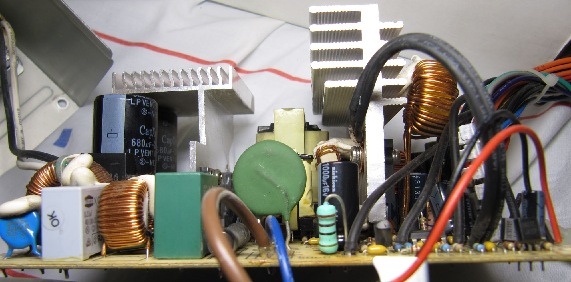

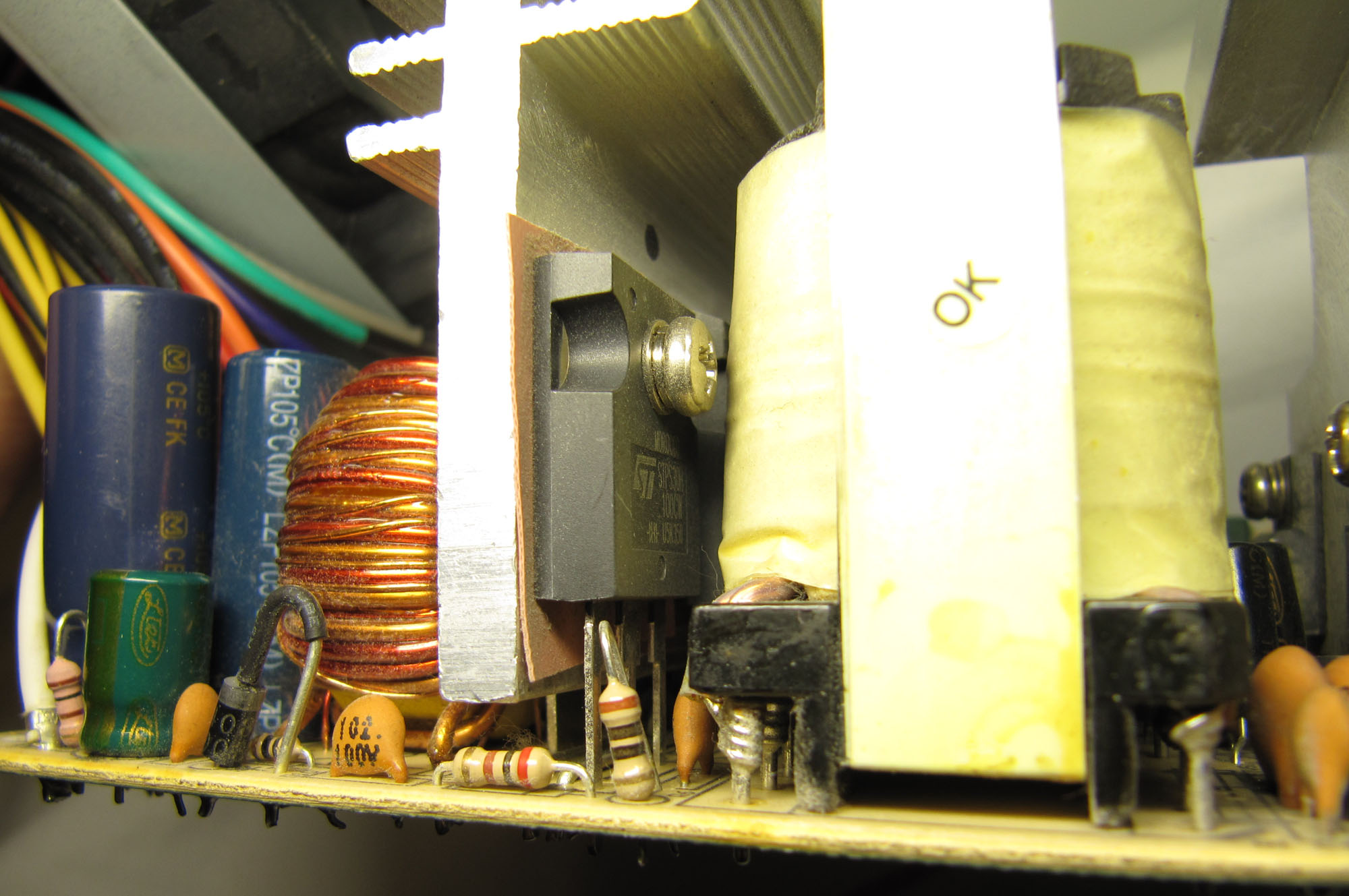

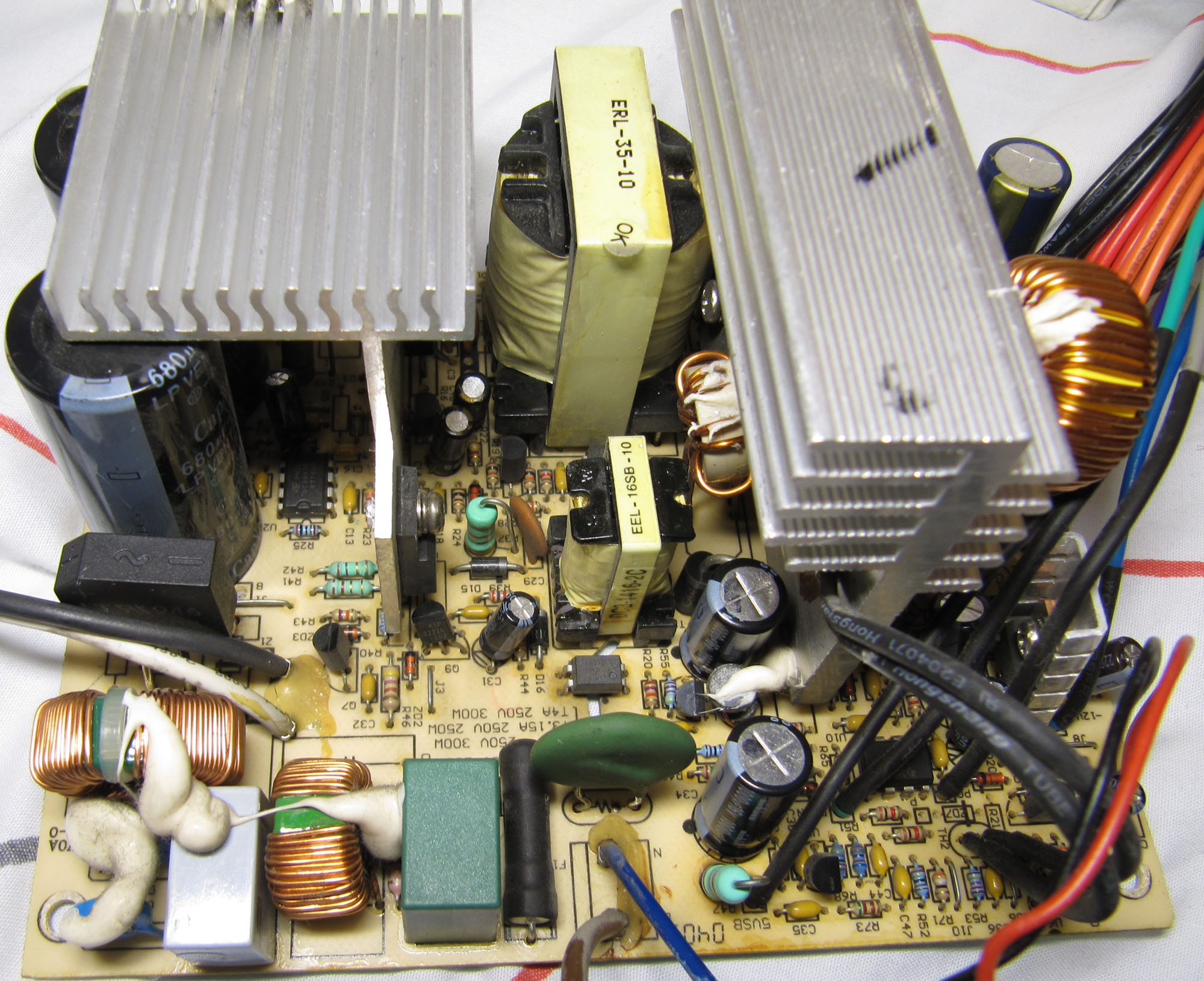

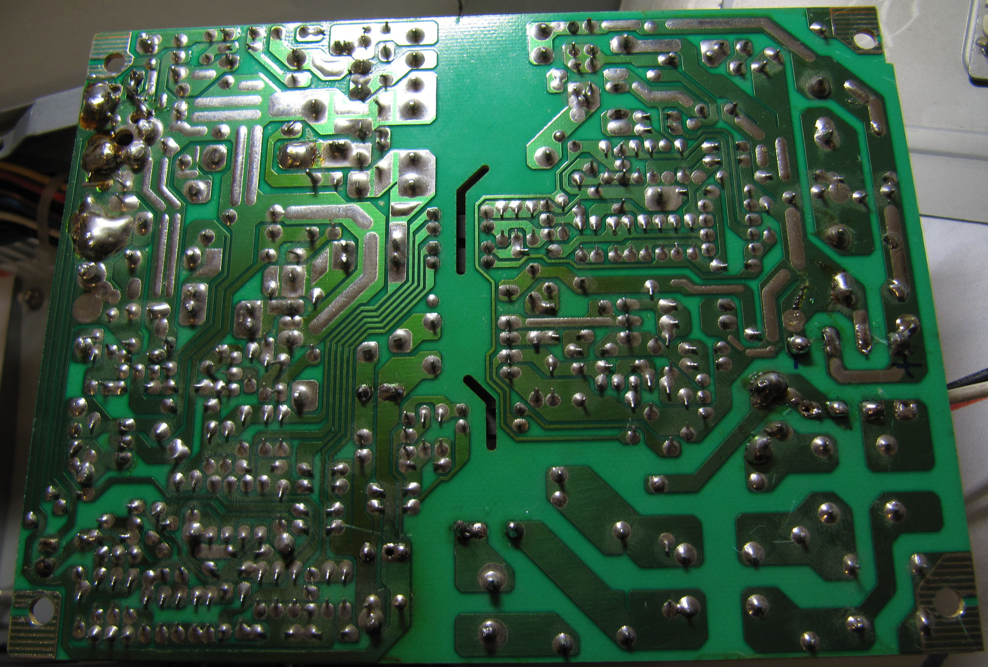

    The psu is powering a Pentium 4 3.2GHZ Hyper Threading (Prescott) for 3 years.
    I was impressed by the big heatsinks, the large ERL-35 transformer, the 2x680uF 200V input caps and the full transient filter (2 X caps, 2 Y caps, 2 coils, 2 MOV).
    The controller is UC3843B and the power mosfet is STP13NK60ZFP, capable of 13A continuous, 52A pulsed.

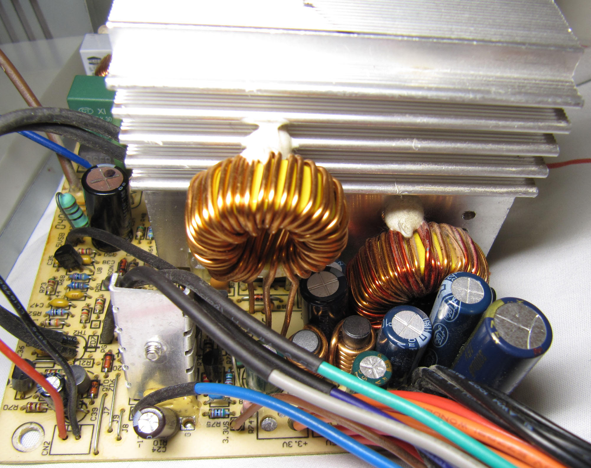

    The biggest surprise to me was the secondary though:
    STPS4045CW for 3.3V
    MBR6045WT for 5V
    STPS30100 for 12V
    5vsb caps:
    2x1000uf Teapo bulging
    3.3V caps:
    1x1000uF Teapo
    1x2200uF Ltec
    5V caps:
    1x1000uF Teapo
    1x2200uF Ltec
    12V caps:
    1x2200uF Ltec

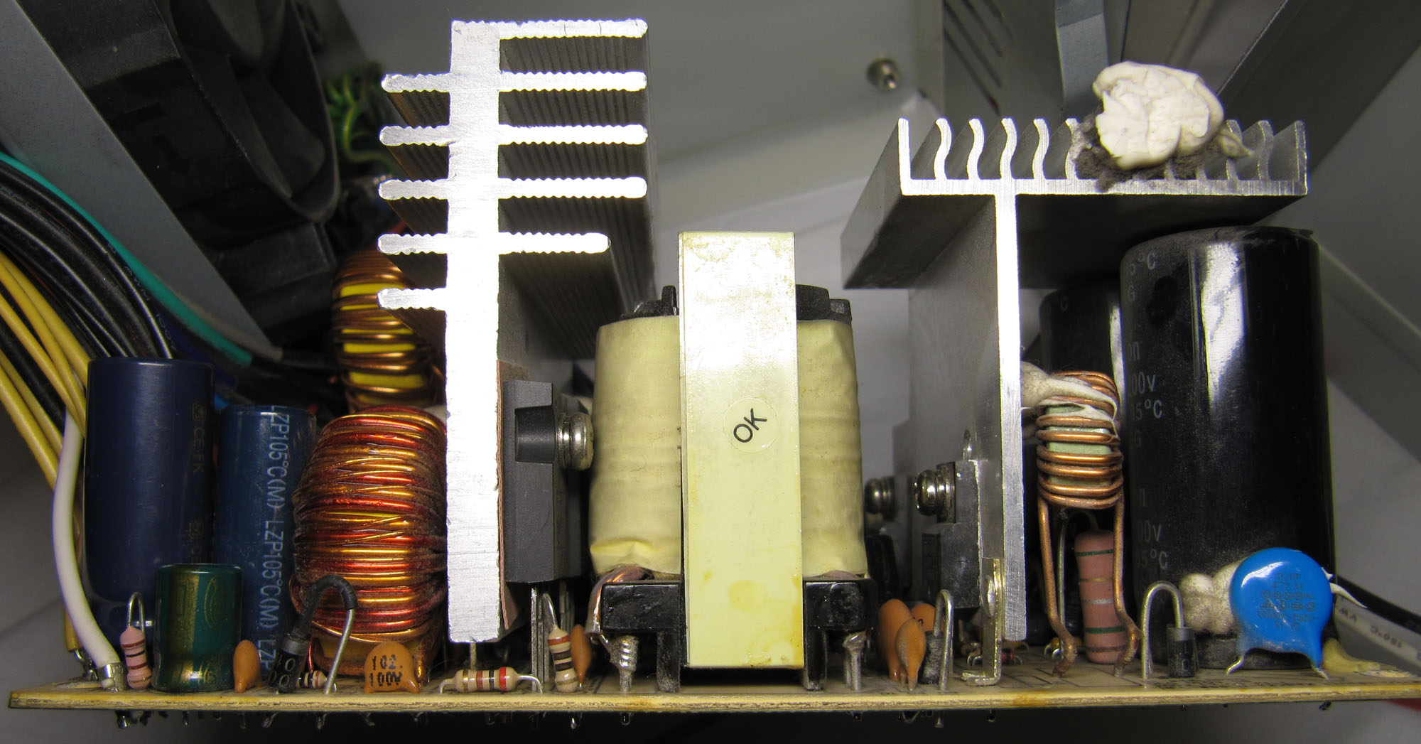

    Mods:

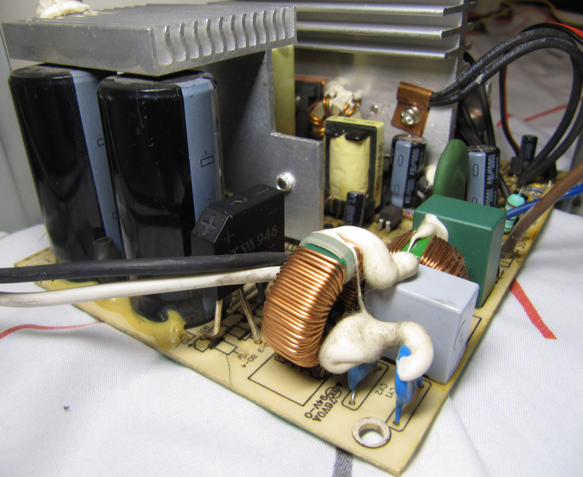

    1)Added an NTC Thermistor at the AC input
    2)Replaced 4 3A diodes with a 4A bridge rectifier (assuming 230V AC, it is ok for 450W)
    3)Replaced the bulging Teapos with 2x1000uF 16V Nichicon HD
    4)Added a 3300uF 16V Panasonic FK at 12V (there was an empty spot on pcb for a second 12V cap)
    5)Added a plastic insulation sheet between the case and the back of the pcb.

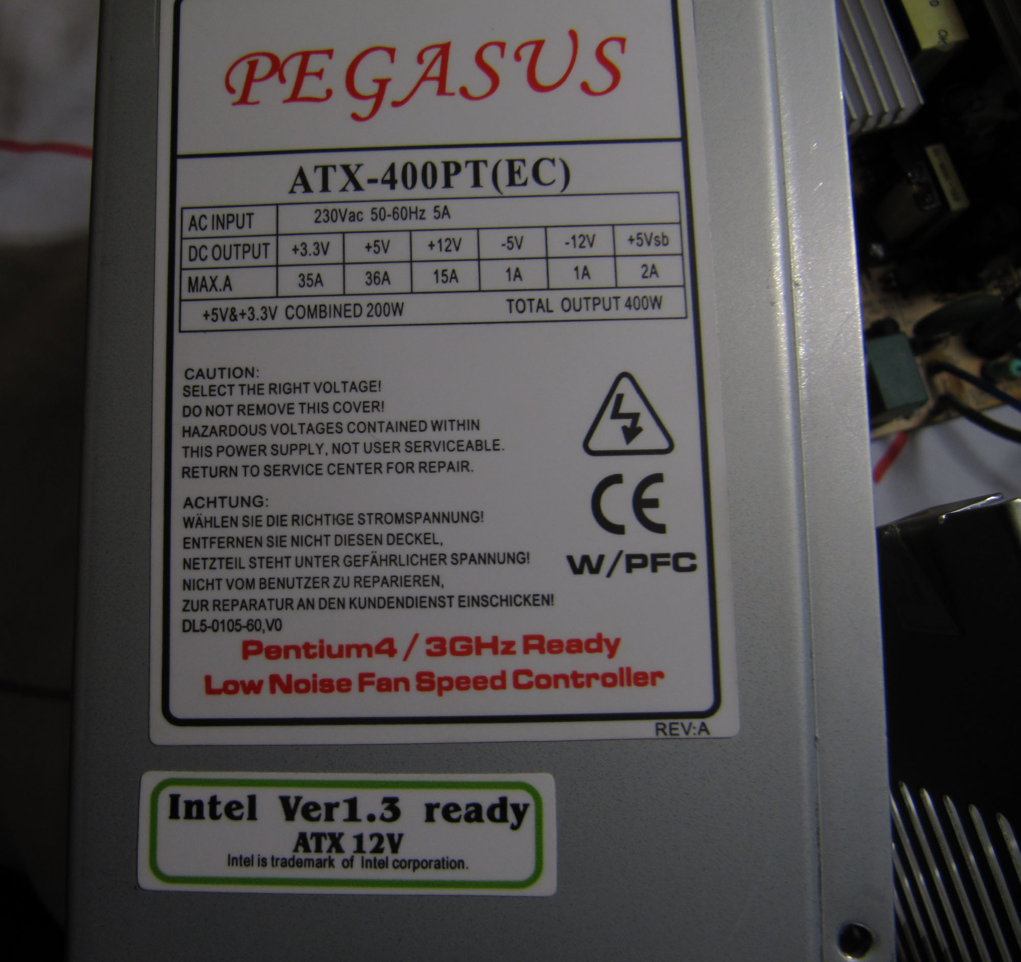

    What do you think? Who made this power supply?
  • 370forlife
    Large Marge
    • Aug 2008
    • 3113
    Re: Pegasus ATX400P
    HEC/Crapucase

      agreed, not too bad after recaps.
      change C31 too.

        Yup, its a HEC/Compucase. Looks like the Thermaltake TR2 430W (XP550-NP). Pretty decent overall.
        5vsb circuit is 2-transistor, though - get C31 replaced as POM_MJ mentioned (this is likely the 5vsb critical cap).
        Also, note that the value of R47 - the load resistor on the 5vsb rail - is 21 ohms (red, brown, black, if I'm reading it correctly). This value is too low, which is not good because it will generate a lot of heat - probably the main reason why the Teapo caps on the 5vsb were bulged in the first place. Definitely get it replaced! A 100 Ohm, 1-2W resistor should be perfect for this.
        *Edit*
        Looks like the -12v rail has 100 Ohm resistor - again, that's way too low of a value for that rail (at 12v it's dissipating 1.44W of heat!). Replace it with 470 Ohms or more.
        See if the PSU has other low-ohm loading resistors on the output rails, and if it does, get them replaced. Generally, you don't want a loading resistor to dissipate more than 0.5W of power, otherwise you're cooking the caps.
          Actually, on 230V it would be good for 920W power draw and 690W output (assuming 75% efficiency)

              About the resistors and the 5vsb caps, I did a fan mod today so that the fan spins faster and the unit doesn't get very hot during operation.
              I advised my friend to switch it off completely when he is not using the computer. That's what I do with my own PCs too.
              I also try to bend the resistors so they are not near caps and the caps so they are not near heat sources in general.
              But I agree that the best would be a full recap and some resistor replacements.
