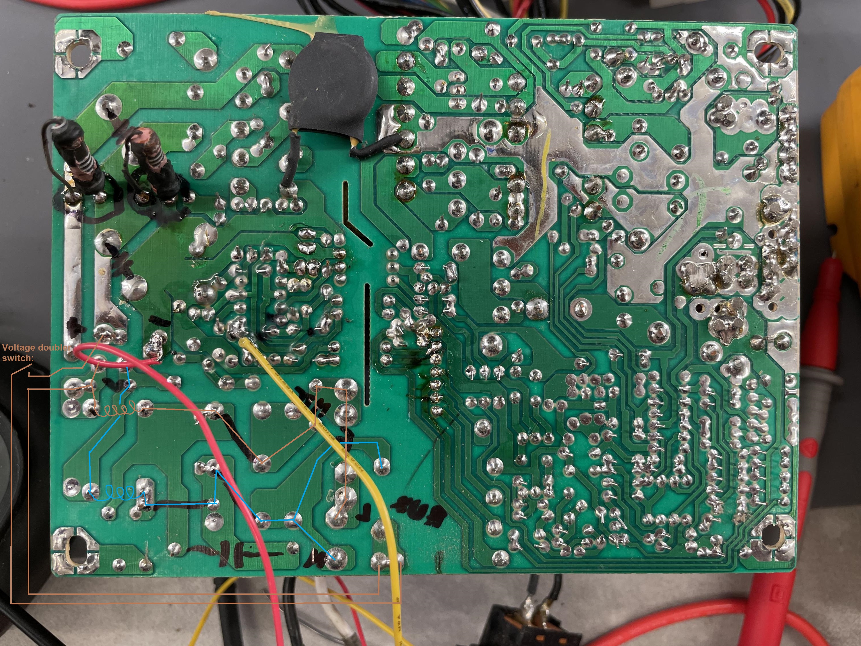

                  I went and reread that whole thread and looked at these pictures again. There are 2 things I noticed:
                  There is brown glue on the primary. Remove that brown stuff on sight as it gets conductive. I see it on the bridge rectifier for example.
                  Next I noticed that you get like 16V peak to peak ripple on the main filter caps. Well that can't be any good either.
                  Something smells fishy to me. There is no way you should get that increased voltage what you are reporting.

                    First, thanks for taking the time to re-read the whole thread!
                    You're right about that conductive glue. It didn't go under the caps but you're right about the bridge, I think there is some ON it. I'll check and remove.

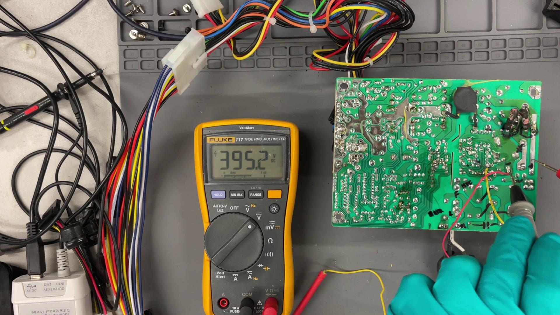

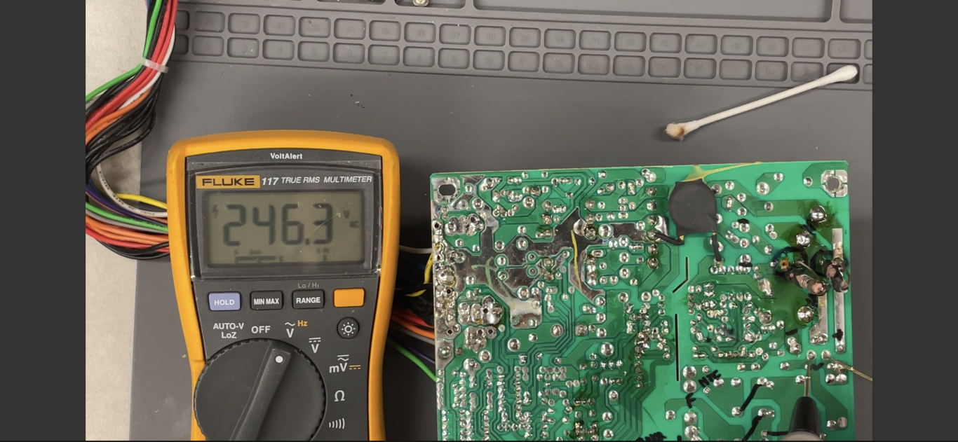

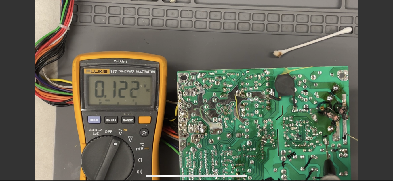

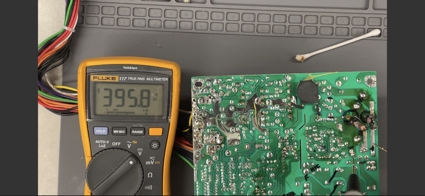

                        246VAC in, 395VDC out. 0.122VAC ripple.
                        That said, I somehow measured 50VAC ripple for a moment (I have that on video!) then it measured 0.122VAC...
                        I removed the conductive stuff, the one around the bridge was still "soft" and not conductive. The stuff around the caps was dried and conductive.

                          I don’t understand how you get more voltage out of a simple voltage doubler than mathmatical possible. Your AC and the ripple measured with the fluke is believable. The DC measured with the fluke and also the 16V p to p with your scope, not so much. With 16V peak to peak ripple, the caps certainly would be toast.
                          But how you get 395VDC out of something where there should be 348VDC beats me. I got to admit, I never came across something like this.
                          If it be mine, I’d be very tempted breaking the 2 high voltage DC traces right after the main filter caps so the high voltage DC can’t get any further and measure again. Then I also take the bridge rectifier out and solder on a 400V or better cap and check it again. That’s just wild.

                              Could it be that I was measuring 490V because I was measuring with the bleeding resistors removed - and then I measured 395V with them back on the PCB?
                                #55
                                Re: diagnosing an old ATX PSU help identifying resistors (PowerComputing TCX-20D)
                                These "bleeding resistors" have actually two functions in this case:
                                1st) Discharge the main filter capacitors when the power supply is disconnected from the mains power.
                                2nd) They distribute the output voltage from the bridge rectifier symmetrically to the both main filter capacitors.
                                I don't recommend to connect this power supply to the mains with these resistors removed, because the voltage on one of the main filter capacitors may exceed the capacitor rated voltage, which may lead to the damage to the capacitor.
