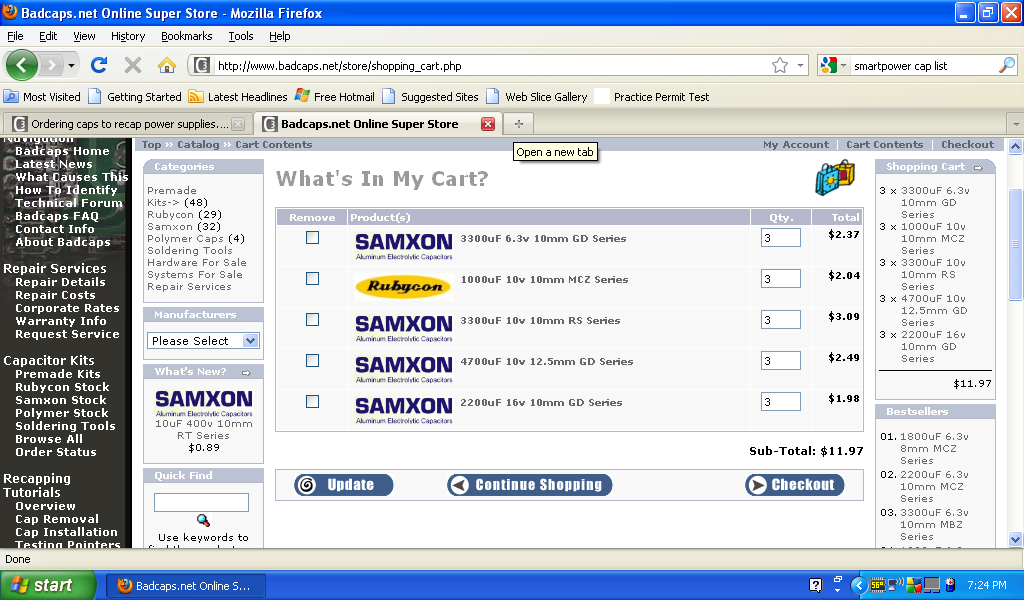

          • shovenose
            Send Doge Memes
            • Aug 2010
            • 6575
            Re: Ordering caps to recap power supplies.
            so i would start wih these. ok?
                Why did you use 3 6.3v GD series and 3 10v RS series. GD aren't suitable for PSUs, the ESR is too low (the same as ruby MBZ). Just use 6 10v RS series. You can use higher voltage caps than the originals.

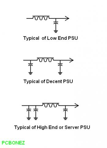

                    Do you know what a PI filter is?
                    For Ripple the value of the Inductor and the value of ESR are chosen so the cap passes the most Ripple to ground.
                    If you change one without changing the other you can 'detune' the filter and less Ripple will be removed.

                                        The correct way to do it is to look up the data sheet on the old caps and match the ESR & Ripple specs or go slightly better without getting into over-kill. The ESR requirement isn't super tight but I try to keep ESR between +0.00 and -0.01 ohms of the original cap's spec unless there is just no way to do it.
                                        When it comes to the final output filters, usually 2200uF to 4700uF caps, FC often aren't good enough and sometimes FM are over-kill.
                                        ~BUT~and~Because~
                                        There are A LOT of different PSU designs and A LOT of different filter designs.
                                        The more caps there are the higher the ESR can be on an individual cap.
                                        For the most common [baring gutless wonders] two cap PI filters *I* usually see ESR [-loosely-] between .030 and .035 Ohms for each cap. [That's for the 2200-4700uF final OP caps...]
                                        Usually they are way better than FC and not as good as FM but it varies A LOT.
                                        The three cap type filter might have three of that grade cap -or- it might have one of those on the 1-cap side and two lesser grade [comparable to FC or PW] on the 2-cap side -or- all three caps might be comparable to FC & PW.
                                        - It varies a lot.
                                        There isn't a good answer to 'what should I use' when you haven't looked up the specs for the old caps.
                                        - It simply isn't that consistant from PSU to PSU.
                                        If I can't find data sheets for the 2200uF-4700uF I go for caps with ESR right around .030 based on the assumption the originals are crap and it's doubtful they were any better than that.
