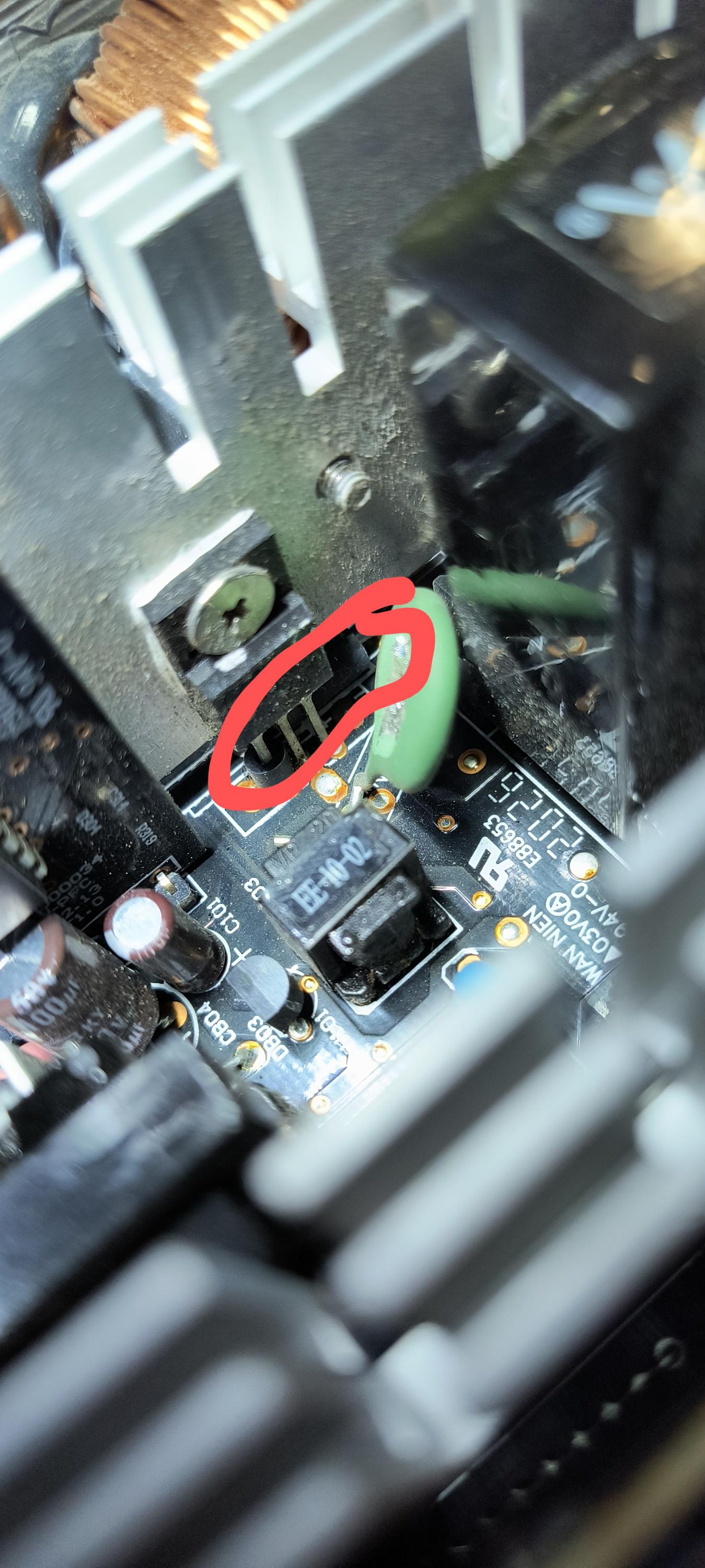

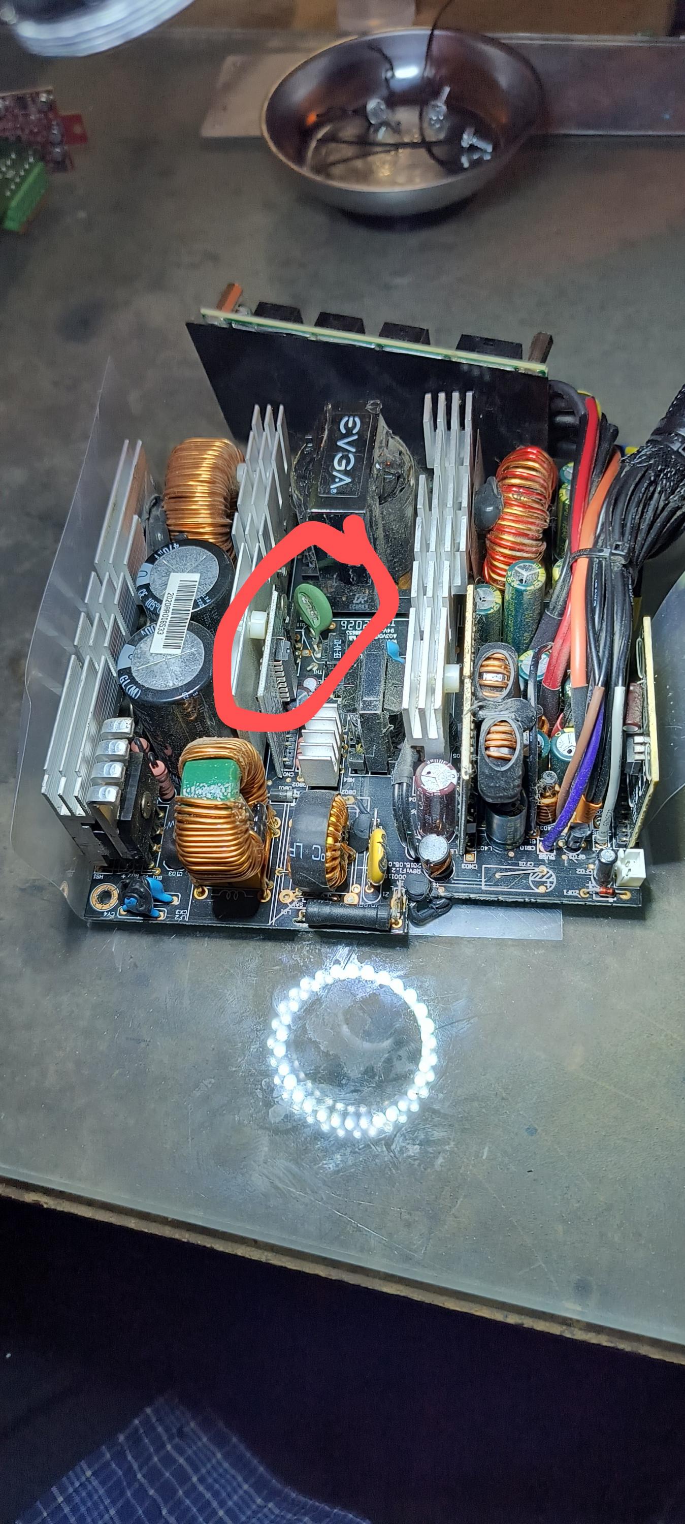

    I woke up today and 1 of my electric panel breaker was off , and I found out that it was caused by my computer, so I decided to troubleshoot the PSU
    evga 850 bq , those 2 parts : d111 a diode & q119 green circle ceramic resistance ( not sure but the emblem is like a rez ) both have no value writed on them.
    They both gone bad , the res is blow on 1 side and the diode is just not doing Its job.
    If someone can help me out to find what are the value of those 2 parts it would be really appreciated,I dont have the money to afford a new psu atm =\ ( hope that right to repair is coming soon xD )

    Sounds like another case of bad/blown APFC circuit (not particular to this unit, but to PSUs with APFC in general)... but I'll reserve my judgment for later.
    If you could, please post some pictures of the power supply and the areas of the affected components. And please do it with the forum's built-in attachment feature.

          Hmmm... yup, most or all of those parts are part of the APFC booster circuit.
          Start by making sure the primary caps are discharged. I'm sure they would be at this point, but it's always worth checking before doing any measurements. Use multimeter to check voltage. Should be 0 or very low (under 2-3V, in which case short their leads to drain the rest.)
          Next, start checking all components on the input and the primary side.
          - Check the fuse. It should have low resistance and not be open-circuit.
          - Check the yellow "disc component" next to it - that's an MOV, which is used for clamping surges on the input line. I can't tell if the dark spots on it are because it's blown or because there's black silicone glue on it. If the former and/or if it measure low-resistance across its leads, remove from the circuit.
          - Check the bridge rectifier (BD1) diodes

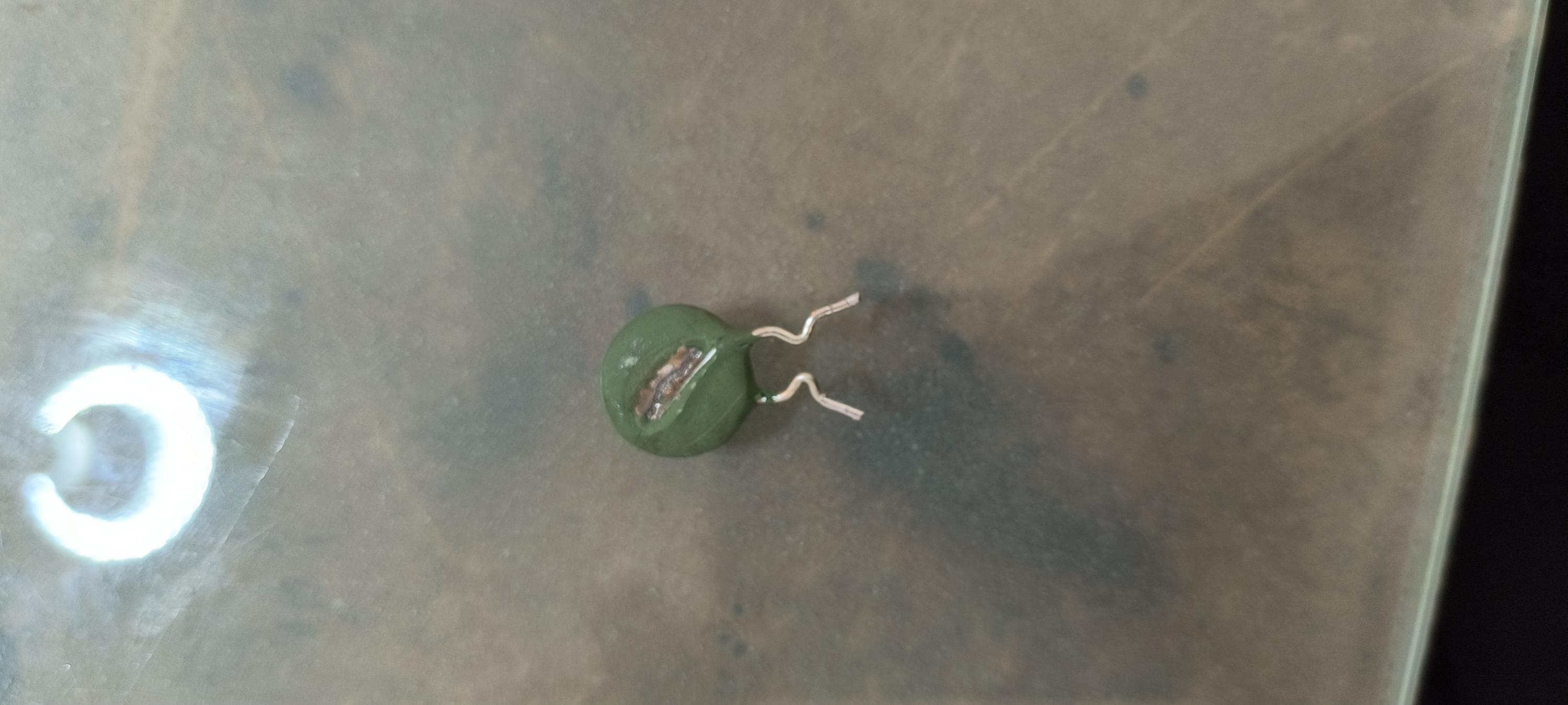

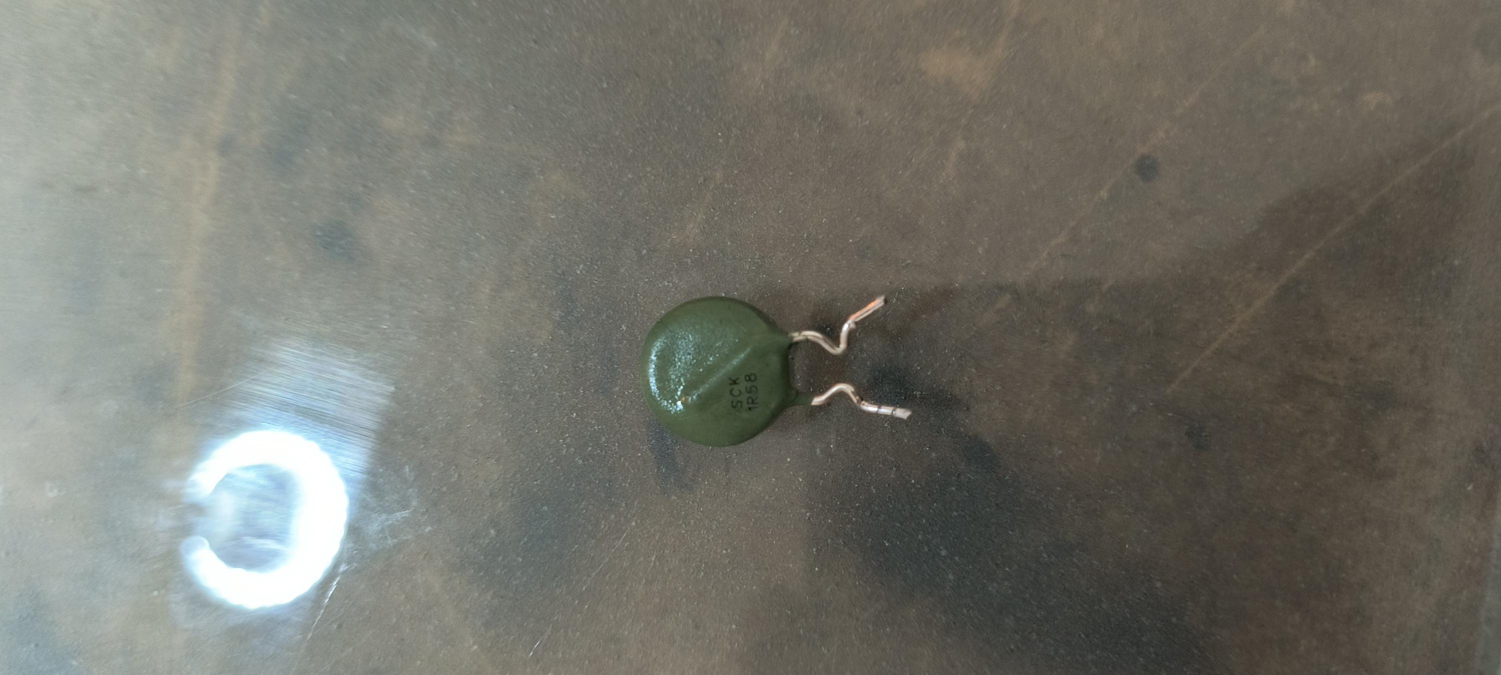

          - The green disc component is an NTC thermistor (a resistor whose resistance decreases with temperature.) It's used to stop large inrush currents from going into the big caps when the PSU is first plugged in... but then as it warms up due to current flowing through it, its resistance decreases to decrease heat losses through it. Some PSUs will even have a relay to bypass it to further reduce losses, but I don't see one in this PSU. In any case, the NTC should have a few Ohms of "cold" resistance across its leads when measured with a multimeter, and slightly lower resistance when hot/warm. It's best to remove it from the circuit to check its resistance. Post what you find here.
          - Check the two big electrolytic capacitors for short-circuit with a multimeter. With the multimeter hooked to their leads, you should NOT see any low resistance across them whatsoever after a few moments of them charging up.
          - Additionally, if you have one of those component testers, remove the primary caps and check their capacitance and ESR. While Nichicon is a really good brand, APFC circuits are known to roast even good capacitor brands over time. The result is usually dry or semi-dry primary caps with partial or no capacitance and high ESR... which can cause other components on the primary side to blow up.

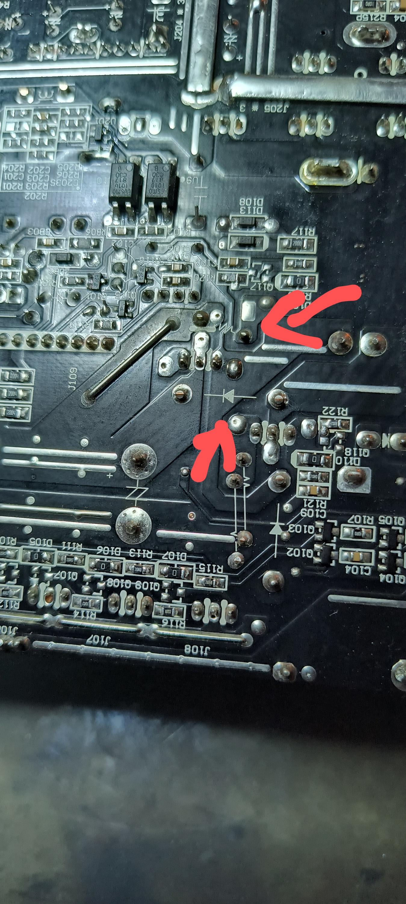

          - Remove the diode you pointed to and test it out of circuit again. This diode is actually not part of the APFC circuit, but rather the main PS. The main PS appears to have a double-forward transistor topology. If that diode is bad out of circuit, then the MOSFET you pointed to in this picture is probably bad too... and likely would be a good idea to replace the other diode and MOSFET pair that's part of this circuit.

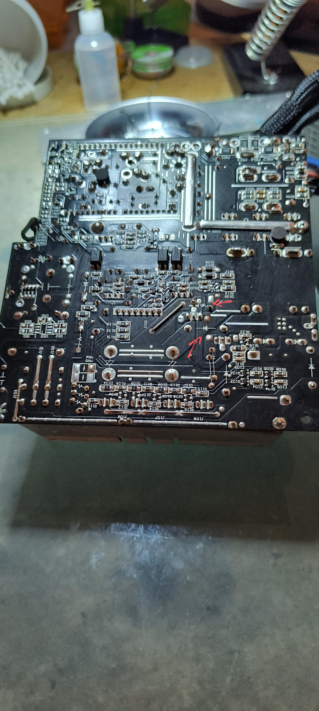

              hi friend , this is what i found so far , i havent made yet the dbt and tested the 5vrail , but i did un solder and test these component .
              sck1r58 NTC thermistor had : 2.5 ohm
              big caps was starting a 7m ohm and going down slowly
              d111 was good ! ( the one circled in red behind the mosfet and the thermistor )
              fast diode d102 was shorted ! ( byc10-600) 1 of the 2
              q119 n 120 was good ( not common wit mosfet testing but i refered to spec sheet n tested source , gate n drain ) 0.3 ohm at source drain diode mode one way.
              edit:adding picture
