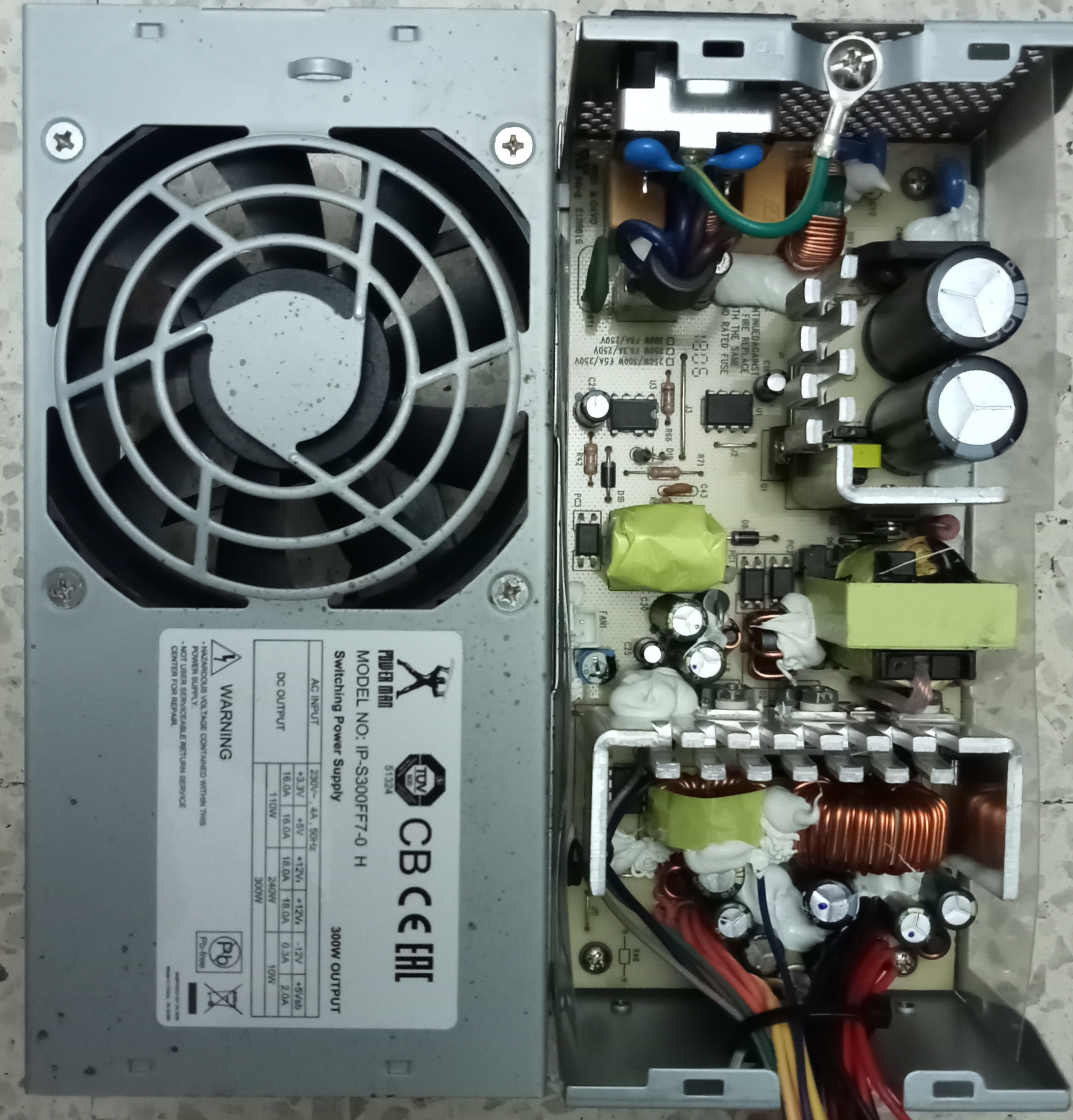

    Help me :
    I have power supply model (power man ip-s300ff7-0) w'ont turn on
    +5v power on(green yarn) voltage low 2.6v

    Re: Power man ip-s300ff7-0 w'ont turn on
    Hi:
    Only it has the 5Vsb? and is it low?
    In case both answers are affirmative I would start looking at capacitors. Specifically ¿C29? The one next to the IC.
      Originally posted by Francesc V.
      Hi:
      thank you for the answer.
      +5vsb present
      the green wire 2.6v
      I replaced the c29 but the problem still persists I received 03 power supplies with the same problem

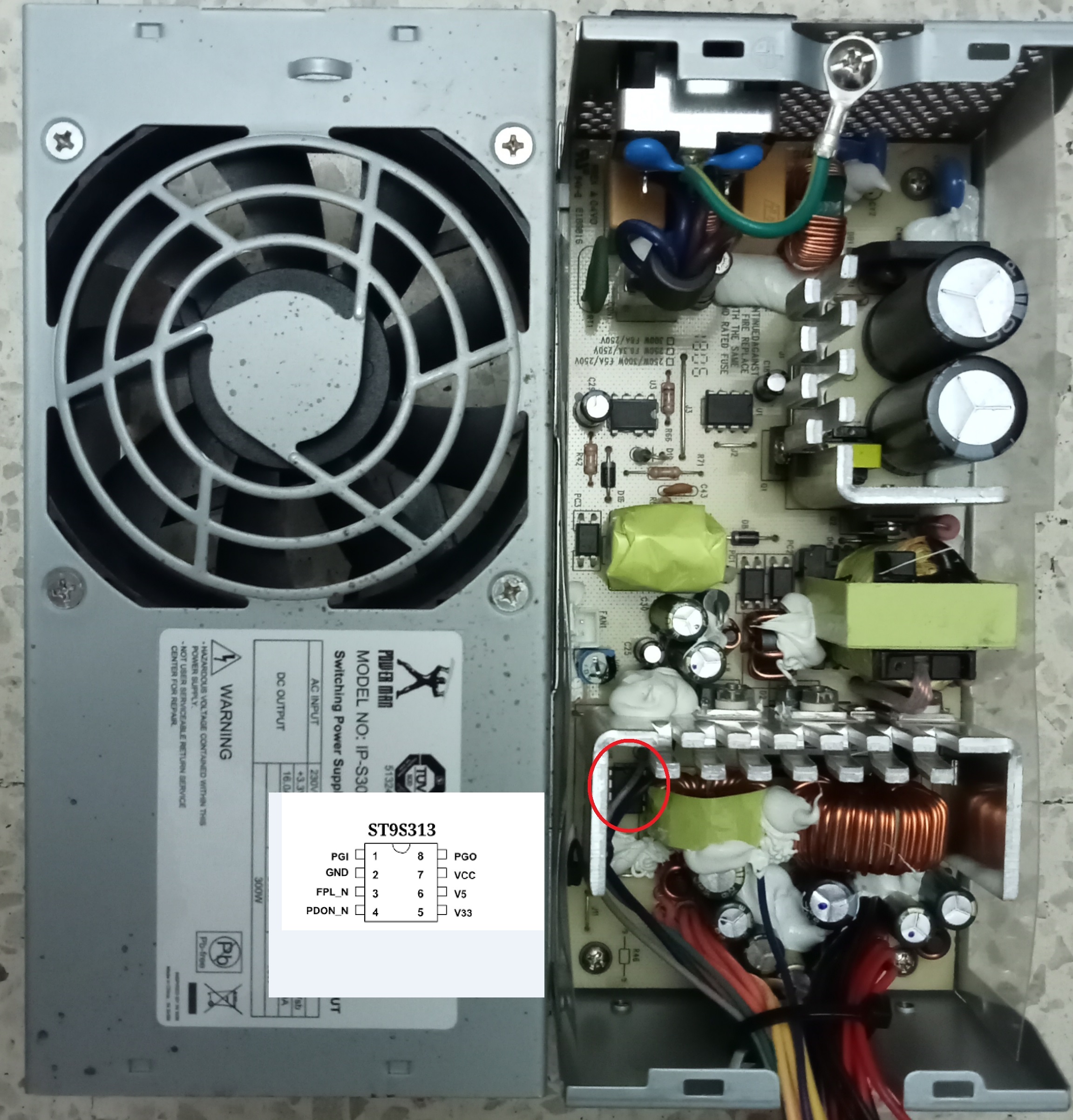

                I grounded the ps-on but no output voltage, the fan does not turn, I believe that the "ST9S313" ic is the cause of the failure
                  Well. This chip needs voltage.......and maybe is not receiving it.
                  I would say that issue is in capacitors........have you tested them? Put numbers on them......do a photo. Desolder them all and let's see.
                    The main part of the power supply needs to turn on in order for the supervisor IC to get VCC. I would suggest looking on all the caps. Basically you got two power supplies in there. One is always on VSB (the one with a TNY2xx IC) and the other one is switched on and off. First you have to see that VSB is working correctly. Then you got to figure out how the supervisor works and may be even tricking it to force the PSU on. So, is the psu turning on for a split second and then the supervisor ic shutting back down or nothing happening at all? If you want you can read up on a Powerman ip that I repaired a while ago.
                    I think your st9s313 is the same as a WT7510 supervisor. Check carefully what the VCC and the FPL pin do.
                      st9s313 voltage
                      pgo------0v pgi----------0v
                      vcc-------4.47v gnd
                      v5--------0v fpln----------4.79v
                      v33-------0v pdown-n 0v
                      • CapLeaker
                        Leaking Member
                        • Dec 2014
                        • 7986
                        Now follow the fpln through the secondary and it probably ends on an opto isolator. Right?
                        • aboumohamed
                          • Dec 2018
                          • 258
                          • algeria
                          Originally posted by capleaker
                          now follow the fpln through the secondary and it probably ends on an opto isolator. Right?
                          exactly i replaced the opto isolator which is on the right, the power supply turns 20 seconds then the failure returns again
                          • CapLeaker
                            Leaking Member
                            • Dec 2014
                            • 7986
                            See what the opto does. My bet is that when the PSU shuts down, you got something like 5v on one pin of the opto (secondary side) and at least 4v on the other pin, measured to secondary GND. Means the supervisor ic turned it off.
                            Could be a few reasons for this, like the main filter capacitors are bad, the output caps are bad on one or more voltage rails or the supervisor ic is bad.
                            If you put GND from the secondary to the fpln pin on the supervisor ic, you are going to defeat that protection and the PSU should stay on.
