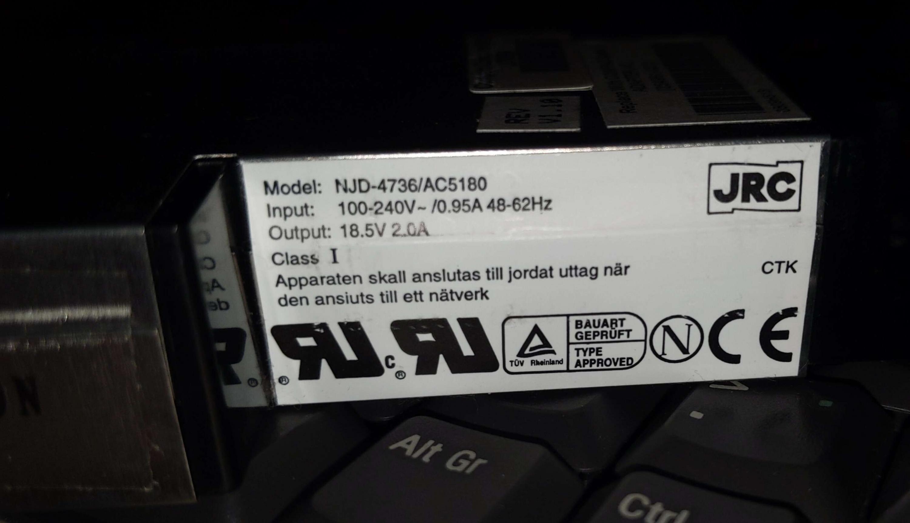

          Here is the original PSU:
          This thing is super light and super small, yet it does 18v 2a? No wonder it failed...

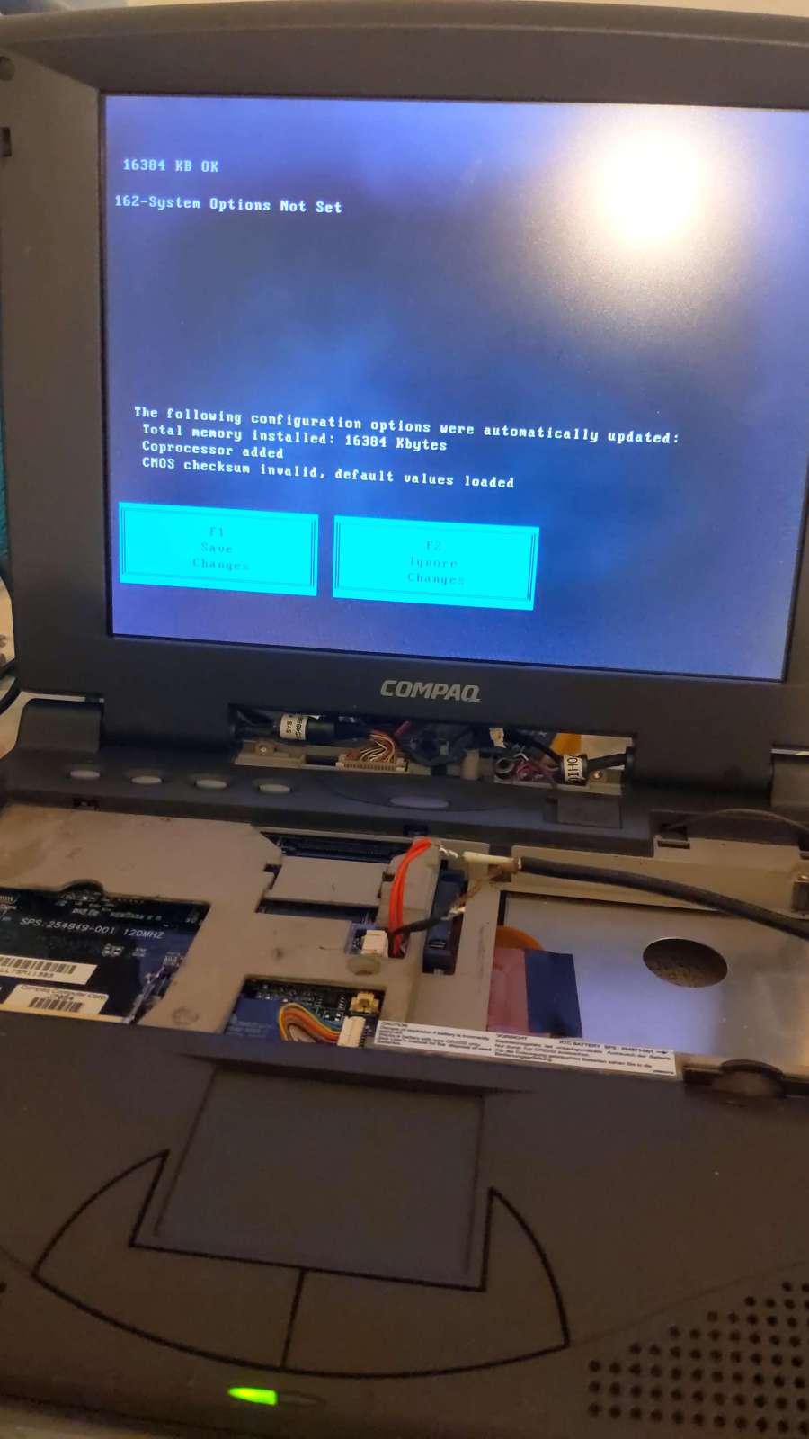

              I took a gamble and hooked a 19v supply directly. IT WORKED!!!!!!!!
              Passes RAM test and everything. I did a quick boot test with a Windows 98 startup diskette and it seemed fine.
              Now this is a question of what I do about the dead PSU. Obviously, I cant use it with a hot wire hanging from the top. That's dumb. I could buy some third-party 18v PSU module and use it as a drop-in replacement with some gluing, but I hate the idea of gluing and internal PSUs. I think I'll solder a DC barrel jack and loosely glue it at the hole where the old Mickey-Mouse plug from the internal PSU was. Will be ugly but its an ok solution for now, can be reversed later.
              I'm also concerned about input voltage, I'm not sure it's a good idea to use 19v on it. I think 18.5v exactly is best for long term health, no?
              I wonder if I can wire an 18v regulator after the barrel jack? Will that work?

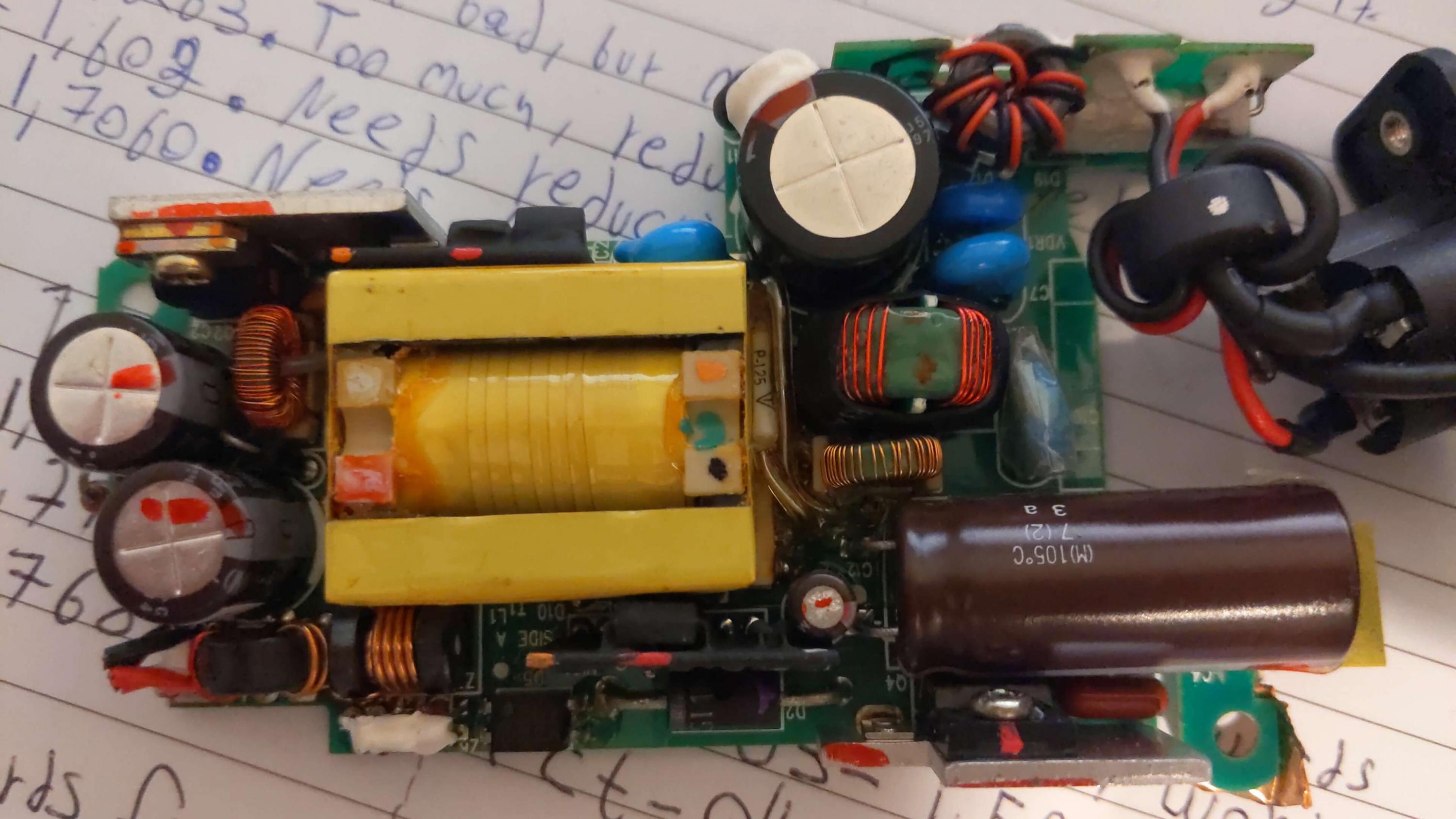

                Anyway, here:

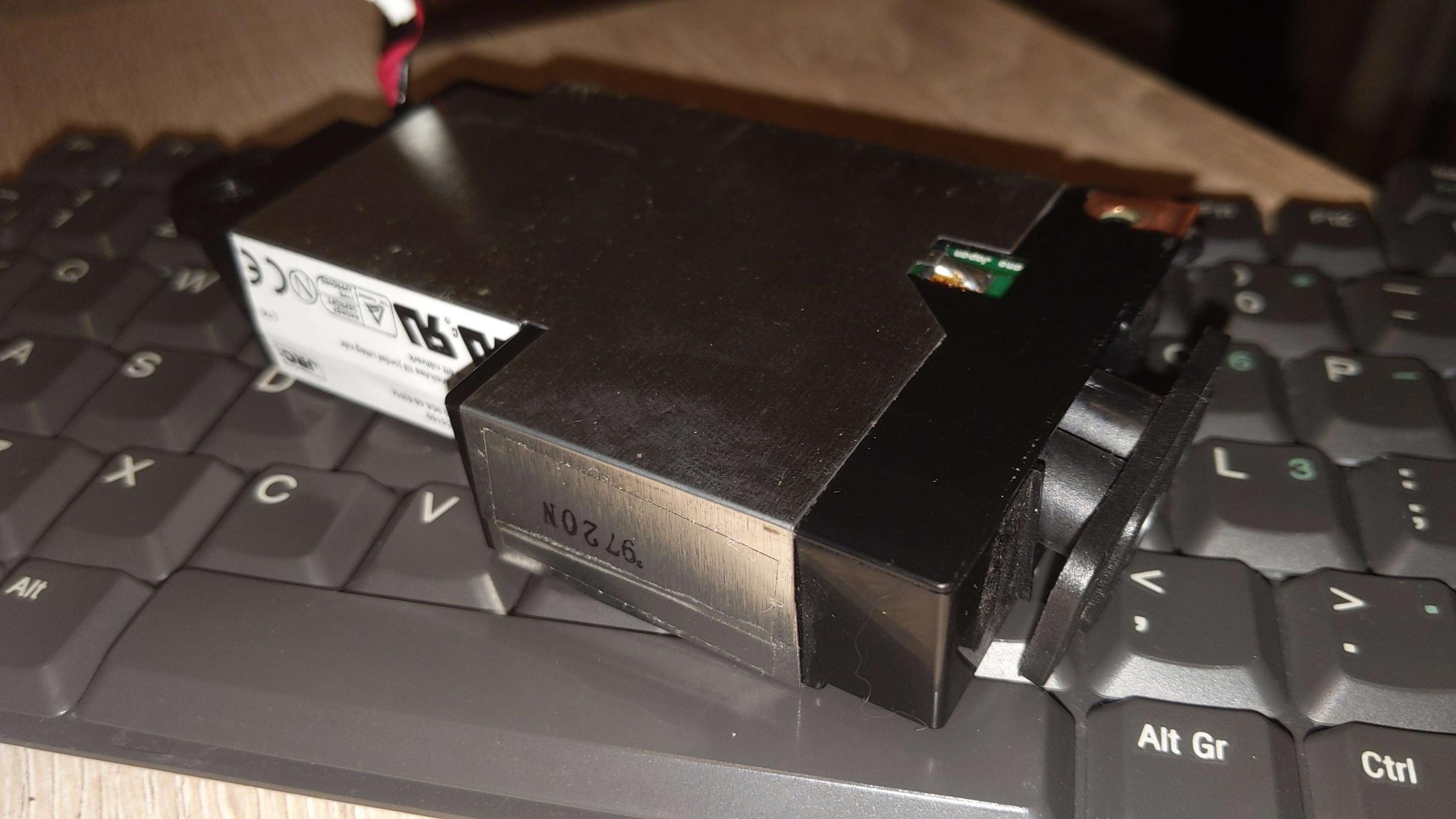

                It also has a daughter-board like module thats covered in a thick layer of paint or something. I think that's a controller of sorts?
                But anyway, I don't really trust this flimsy power supply.

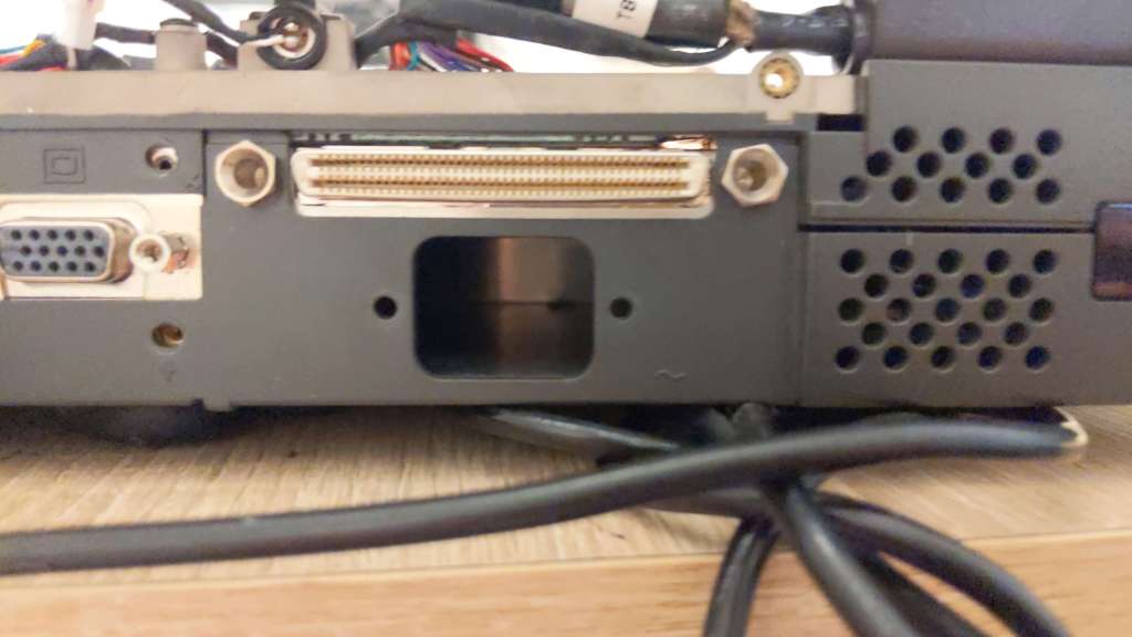

                  BTW, here's the laptop, with an awkward wire at the top...
                  And here is where the PSU used to be:
                  I'm thinking of gluing a DC barrel jack to the side there, awkward but will be fine.
                  The question is whether I should regulate the supply after the barrel jack somehow. Or will the laptop be fine with something less than 18.5v as you said?

                    replace the small electrolytic in the psu with a low impedence part like panasonic FR series
                    it will probably start.

                      I wouldn't call it flimsy.
                      2 Amps @ 20V (OK, 18.5... whatever ) is 40W, which isn't a lot or hard to do.
                      Also, note this original power supply has Nichicon capacitors, which are very high quality. That being said, they are quite old at this point, and indeed may already be EOL - particularly the small 5x11 mm "startup" cap seen at the bottom-right of this picture:
                      https://cdn.discordapp.com/attachmen...126_220859.jpg
                      (BTW, please use the forum's "Manage Attachments" feature to add pictures. This way, pictures will stay with your thread indefinitely instead of disappearing after a few years, which online hosts are known for regularly.)
                      Also, another point worth mentioning is that while Nichicon capacitors are considered a very good and reliable brand, you might want to check the series of the ones in your PSU. If they are PR series, you should definitely replace them. The PR series are known to leak electrolyte from their bungs after many years. I think PL and PF series also had similar issues, but not as often. So worth a look there. The output caps are the ones on the left in the above picture.
                      No, the exact voltage hardly matters with laptops. I doubt there is any circuit inside the laptop that needs anything this high. Probably only the battery charging circuit, as stj noted, and that too may be OK, depending on the voltage rating of the battery. Otherwise, I'm pretty sure anything down to 14-15V will work OK or anything as high as 24V. I wouldn't go past 24V, though, just in case there are any parts that are only rated for 25V (a standard voltage rating)... though I doubt it, since 18.5V is too close to 20V, meaning most parts are probably rated to withstand up to 35V.
                      But yeah, 14-24V will do just fine without any adverse effects on the life of components whatsoever.
                      Just to be on the safer side, though, use a standard 19.5V or 20V laptop adapter... and that's if you do decide to go with an external one.
                      My suggestion, of course, would be to try to repair the old PSU. Again, it likely needs its startup cap replaced. Just make sure you use a good quality brand like Rubycon, Panasonic, Nichicon, or United Chemicon, if you want the repair to last any reasonable amount of time. Preferably pick a low ESR series from those. Panasonic FR is one of many. Panasonic FC, FM, and FS would be just as good. From Rubycon, good choices would be YXJ, YXF, YXH, YXG, YXM, ZL, ZLH, ZLJ, and ZLQ. Nichicon: PW, PJ, PS, PM, HE, and HW. UCC (United Chemicon): LXZ, KY, KYB, KZE, KZH, KZM.

                        You mean the one besides the big long brown cap? I can try replacing that...
                        The output caps are Nichicon PL series from the looks of it. They have PL(M) printed on them...
                        The big brown cap is KMG 400v 65uf.
                        The startup cap is a KME 35v 33uf.
                        There is also a fat black cap on the top right, this is a Nichicon R7 series from the looks of it.
                        BTW, the capacitor legs are covered in glue. Not sure why, maybe to insulate them since they are high voltage? How do I go about removing them, desoldering alone wont work...

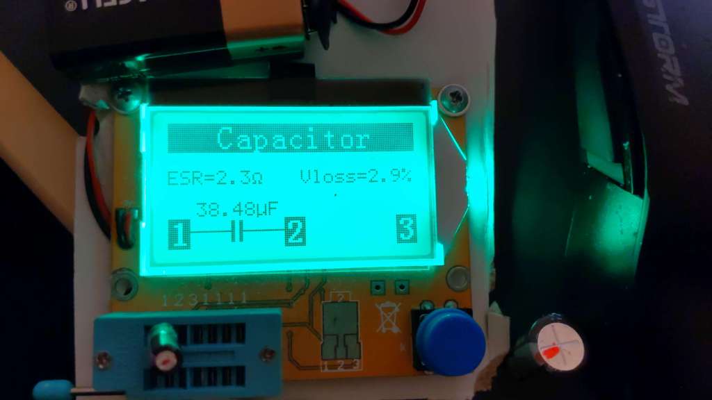

                                      Ohhhh, I pulled out the startup cap and measured its ESR.
                                      Isn't that super high?

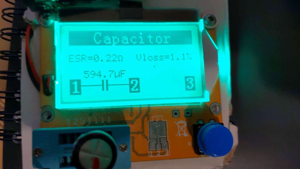

                                        Re: Old Compaq Armada internal PSU repair
                                        The output cap, in contrast, seems fine
