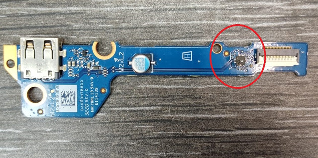

    The device works fine, but the USB 2.0 and HDMI output does not work. The power button&USB board is damaged. The USB charging port power switch controller is completely dead.
    Thanks.
  • mon2
    • Dec 2019
    • 14667
    Re: For HP 15-ec00 DA0G3HMB8D0 REV Quanta G3HA
    USB load switches get damaged all the time. They are electronic fuses and should turn off the Vbus rail with an excessive current as the trigger.
    However, some of the load switches are crapware designs and they just die.
    Post pics of the USB connector that does not work and nearby, there should be the USB load switch. They are very common to source from real branded companies.
    Datasheets are often with the same pinout so you can confirm if this is the fault or not very quickly.

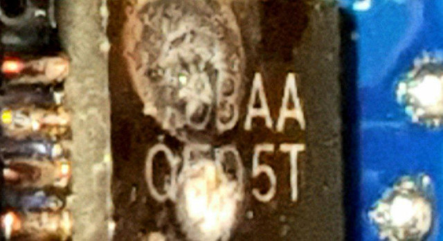

      Ok. Please help identifying the chip. I would be very grateful
      Last edited by SMDFlea; 04-19-2023, 05:48 AM. Reason: copied offsite images to badcaps
      • mon2
        • Dec 2019
        • 14667

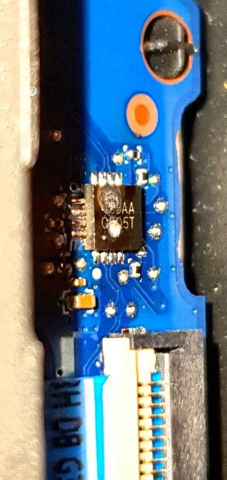

        Very difficult to read the top line - can you post a pic of the bottom side of the IC ?
        Looks like that the IC has been removed off the board ? So also post a pic of the SMD pads on the logic board so we can understand the SMD package of this component.
        Looks like a QFN-16 package.
          yep. its QFN-16
          IC still on board. The laptop continues to be used for work.
          There have already been hints that this is an analogue of the TPS2540 and perhaps the SLGC55544CVTR or SN1702001RTER will do.
          That's why I was looking for a schematic / boardview to make sure. HDMI worries me. Will it work after changing the IC.

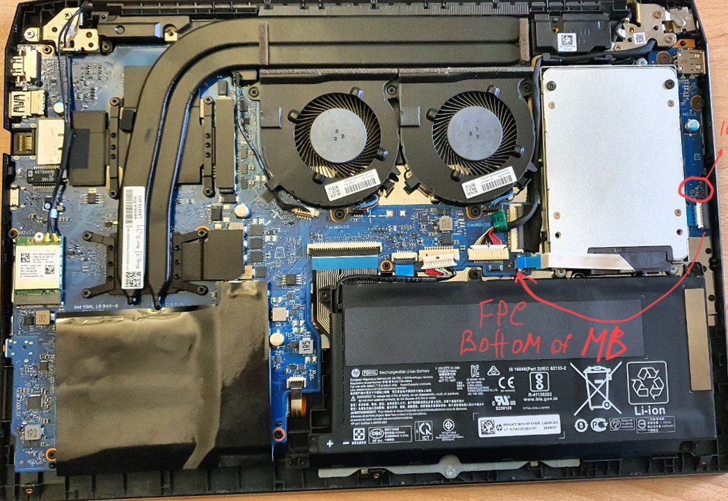

            The IC is linked to the FPC connector on the right side of the daughter board.
            What is this FPC connector used for ? Even with the top side being damaged, the FPC connector is working with the connected circuit ?
              The train (FPC) goes to the motherboard from below. This power button board itself and also USB 2.0 on it with power support.
              P.S. on the picture, the battery connector is disconnected before the first visual inspection.

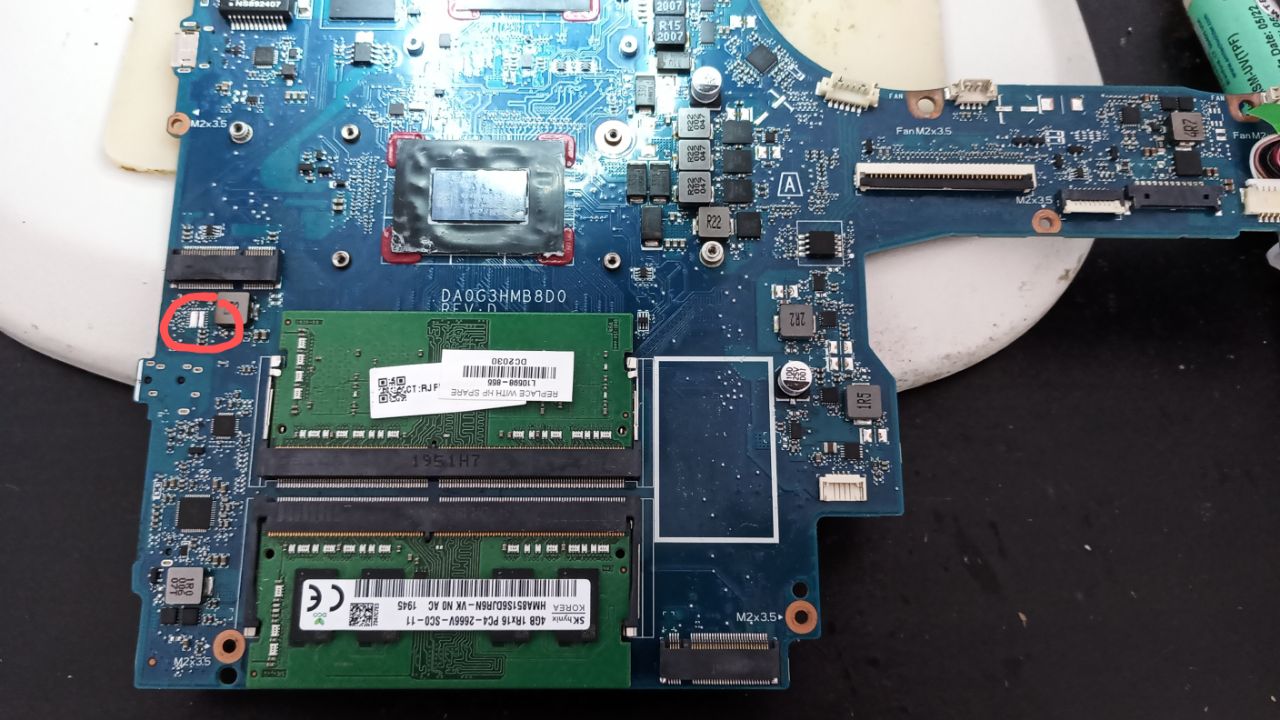

              • rs2pac
                • Apr 2022
                • 8
                • Moldova
                Case history: The laptop is turned on, and the FeiyuTech-G3Ultra gimbal (3-axis stabilizer) was safely charged in the USB 2.0 port, in the OFF state. After turning on the power, this connected stabilizer, the laptop turned off (it went out completely), but did not die. In the future, it was launched, loaded and still works. However, part of the hardware does not work. That USB 2.0 died, HDMI stopped working (although the second monitor reacts that something is connected, sorts through the inputs, but does not show). USB 3.0 works ok.
                Later it turned out that the FeiyuTech stabilizer should be connected to the PC ONLY via an adapter (USB TTL), but the pinout is not pure TTL, but a proprietary modification (there are only three wires), rather signal ones.
                  i have it here it says on it 48BAA
                    Thx bro. Hope it's help.
                    Still need schematic, board view, to fix hdmi.
                        Is 48BAA

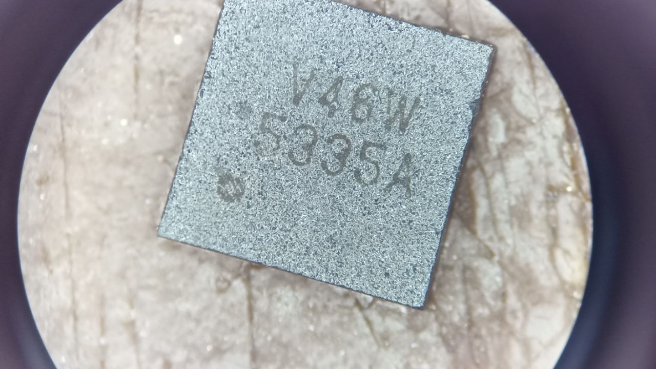

                              Hello. Can anyone help me identify the microscheme? quanta g3ha platform. Unfortunately I couldn't find anything on the internet
                                • 21907
                                GMT G5335A https://cdn.badcaps-static.com/pdfs/...ab6fd587d6.pdf
