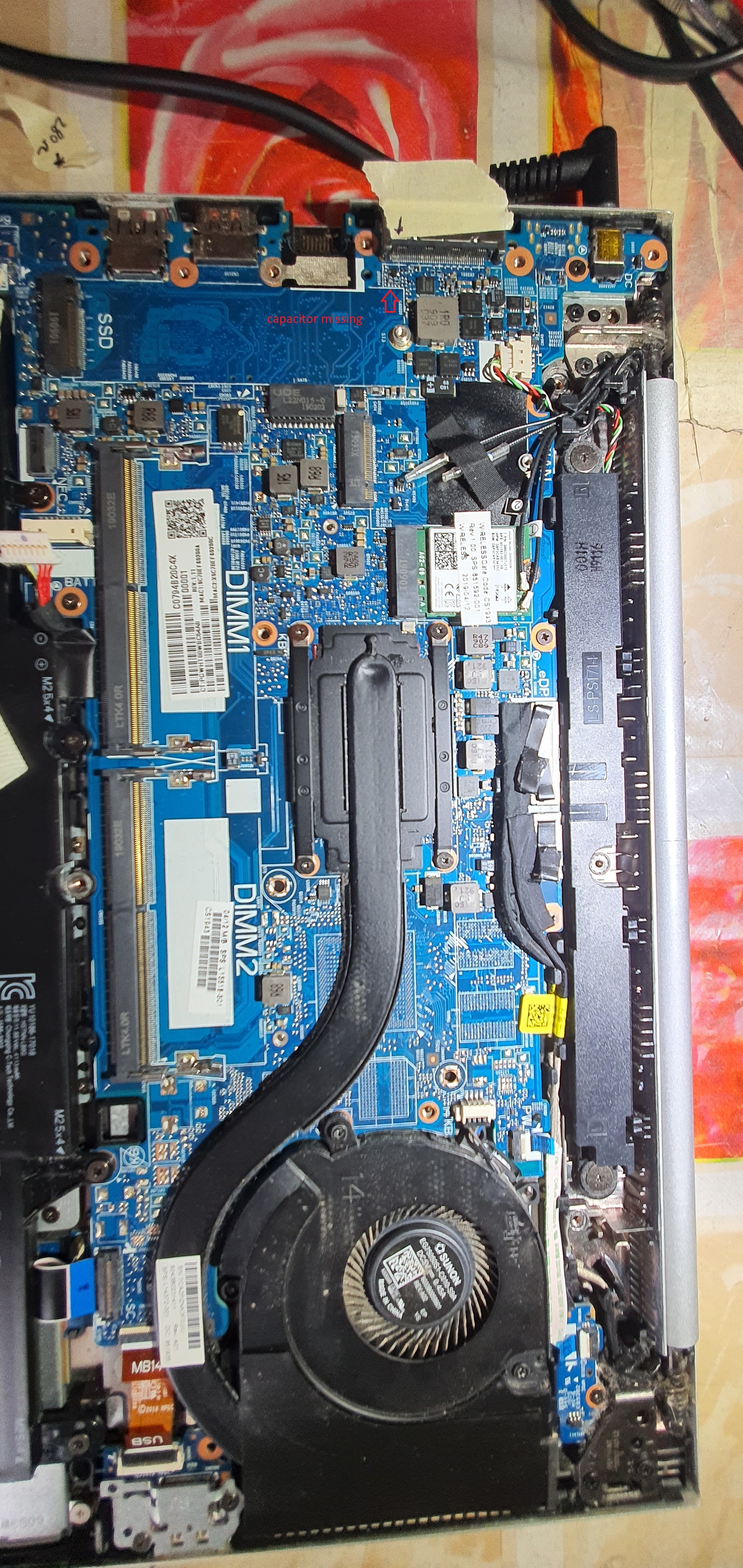

              • jackx
                • May 2020
                • 222
                • casa1

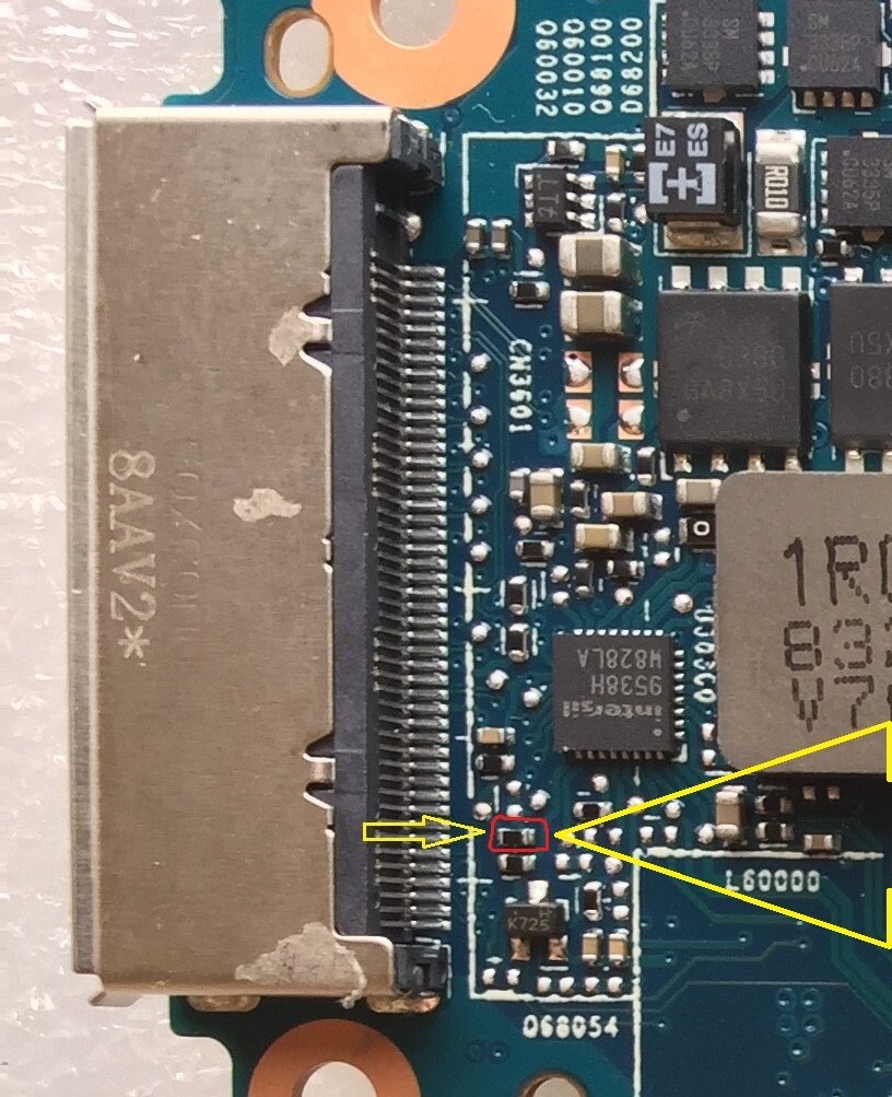

                HP ELITEBOOK 850 G5
                ​6050A2945601-MB-A01
                i need valeur for 2 resistor in photos

                Originally posted by jackx
                HP ELITEBOOK 850 G5
                50 Ω
                and 20 Ω

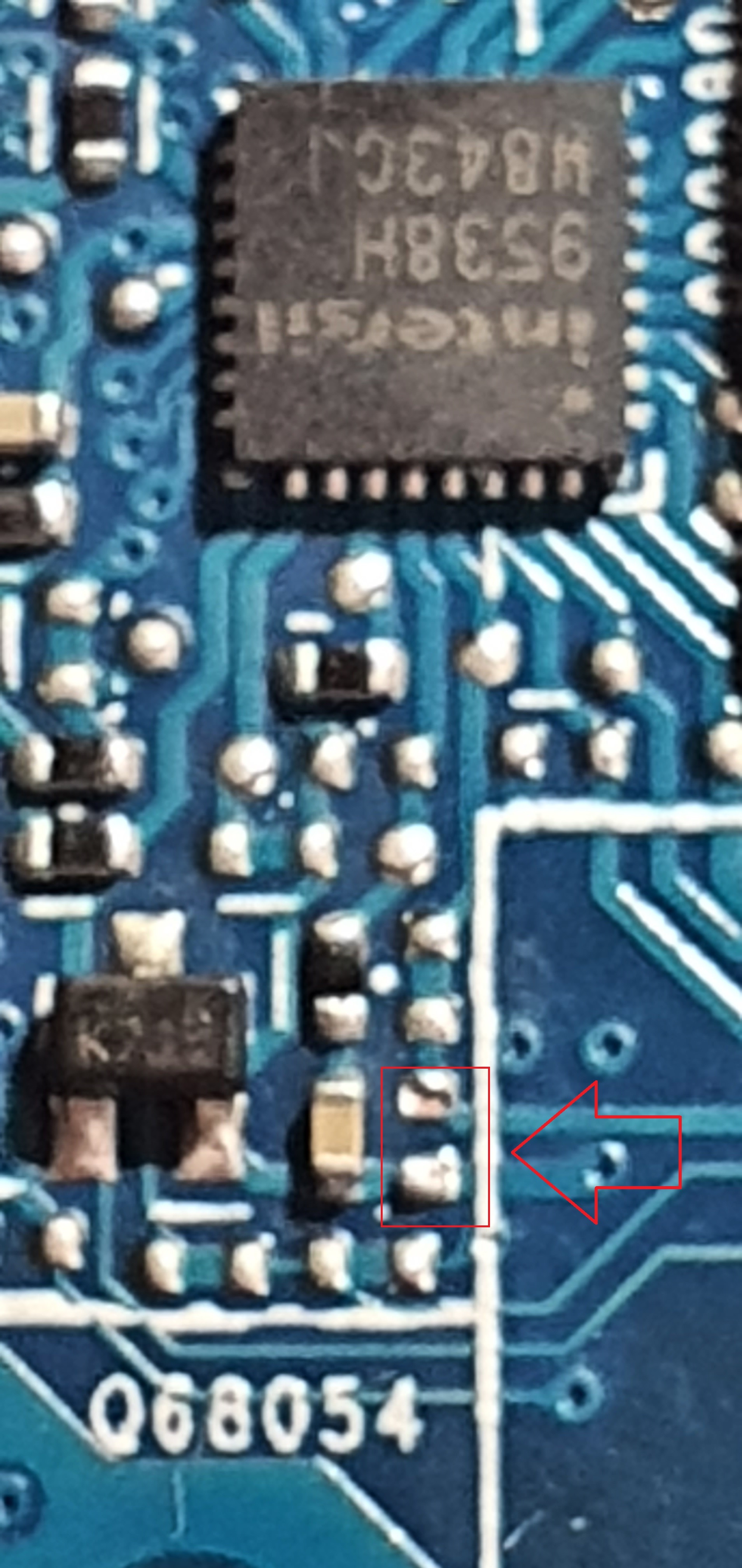

                      Hp840g5
                      mainb 6050A2945601-MB-A01
                      Hello everyone, I have an ElitBook 840 G5. As soon as I plug it into the power jack, the light next to it flashes from white to orange, alternating between the Caps Look and F10 LEDs.
                      From an initial visual inspection, I found a component that's most likely a capacitor (I'm attaching photos). This interacts with the ISL9538H IC.
                      Can someone please tell me the value of this capacitor?
                      Thanks.

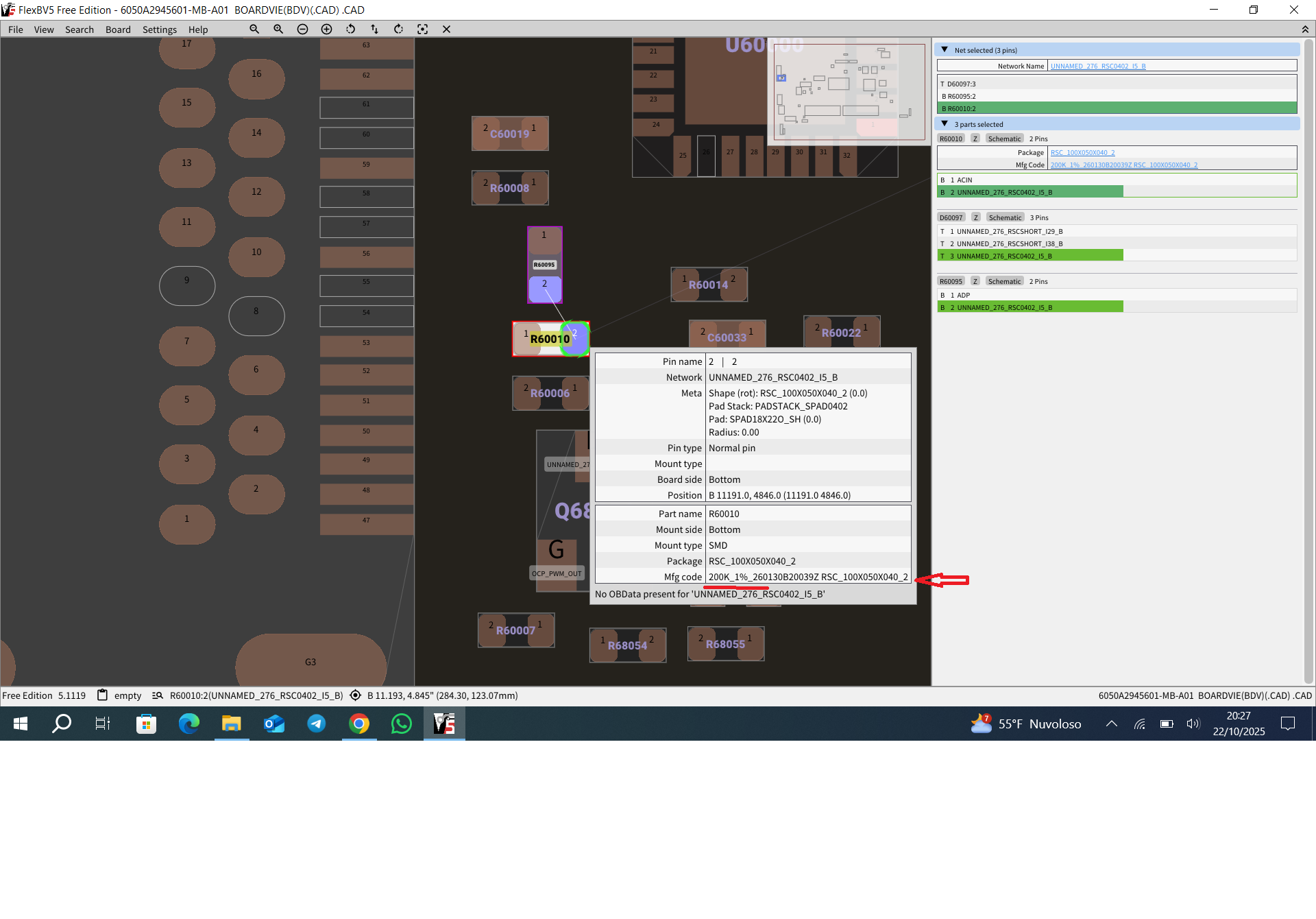

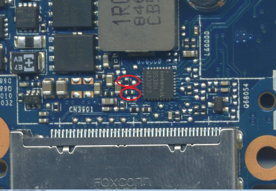

                              Good afternoon, my friend. Could you please tell me the ohms of this resistor? please

                                Good afternoon, please, someone who has an HP 850 G5 mainboard can help me get the value of the resistor that I indicate in the image, please.
                                  here you are .
