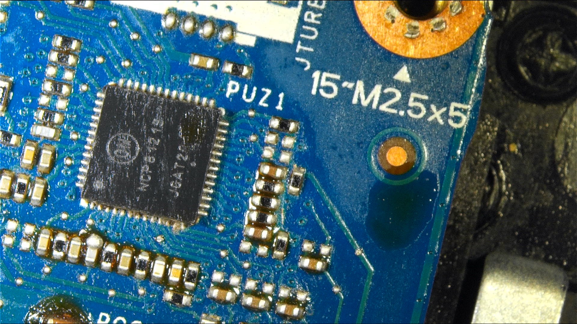

    Hi friends
    I need board view for acer an515-55, Motherboard LA-J891P
    I lost a resistor and I can't find it on the schematic
    I tried 100 k and 10k but still I have a problem not detecting the ssd

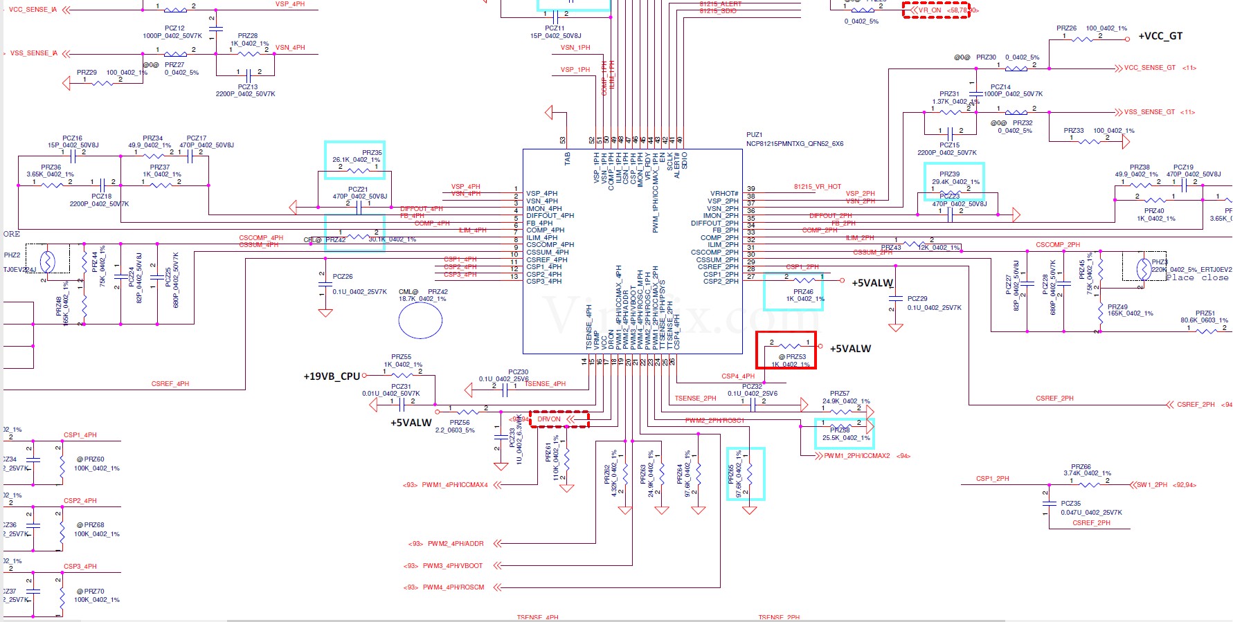

    I have the schematic in my paid sub. Which pin has this missing resistor? Will post the relevant part of the schematic.

      The resistor is connected to another resistor and to leg 25 of the chip. I can see on the schematic only 1 resistor connected
      its not matching thats why i need boardview
      NCP81215PMNTXG_QFN52_6X6

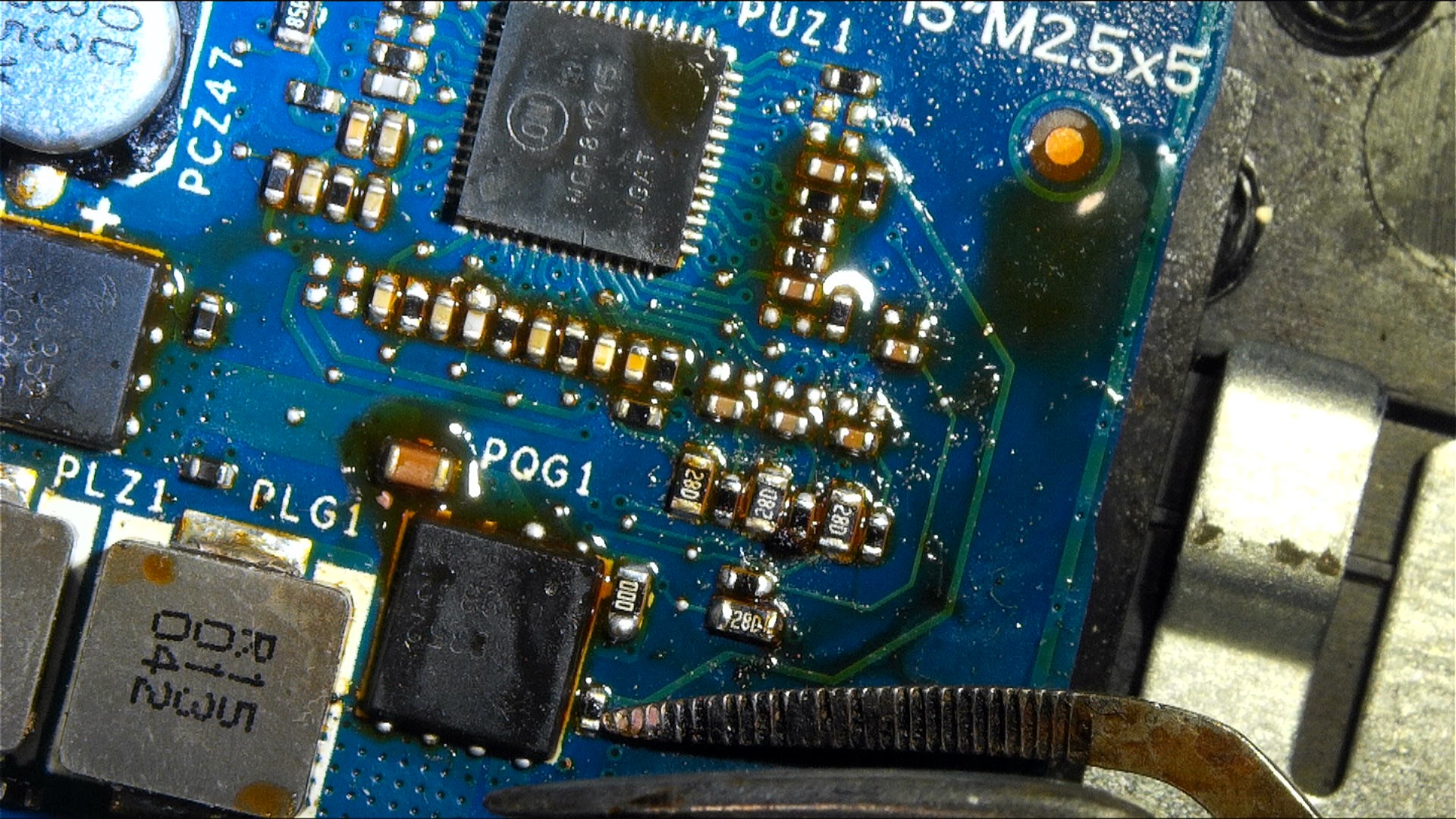

          140kO
          • nissimezra
            • 178
            Re: LA-J891P board view
            Originally posted by miha0095
            140kO
            Good bless you
            140ko
            Thank you
