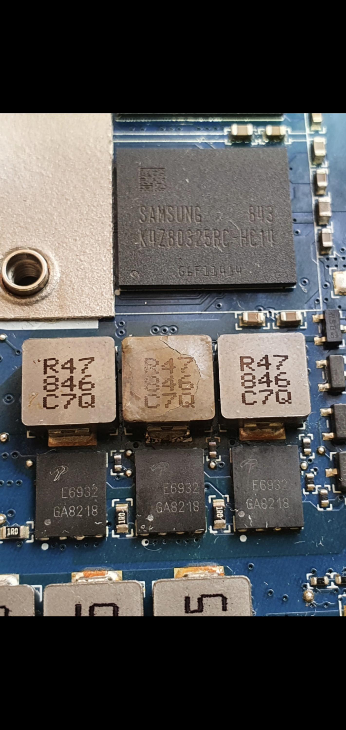

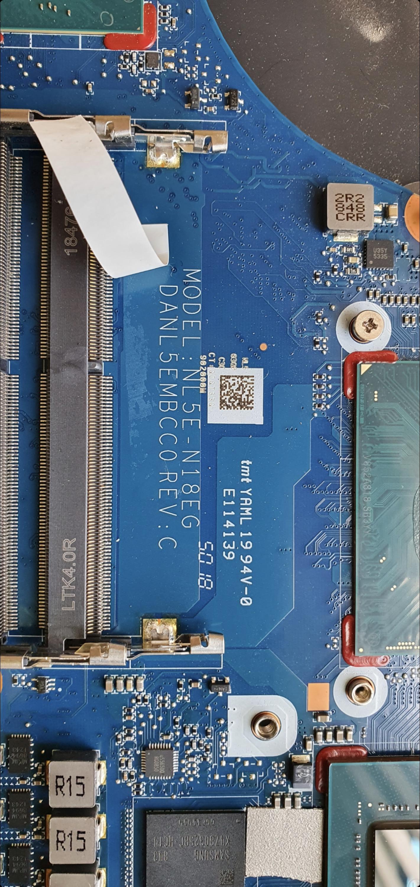

    Hi I need the schematic and board view file for a PC specialist proteus. The component that I am trying to identify is a power rail coil from the video circuit. The motherboard model is NL5E-N18EG. The component has a code on it which is R47846C7Q

    Any coil off a scrap board marked R47 will do. Check the mosfet below it as well.

      @diff. Laptop was dead. That mosfet is good. Had one mosfet in short on 19v rail replaced it. Found thia coil to be in short, after removing it no ore short in the board. Laptop is powering on and charging but with no screen as does not have the coil to power the video card
