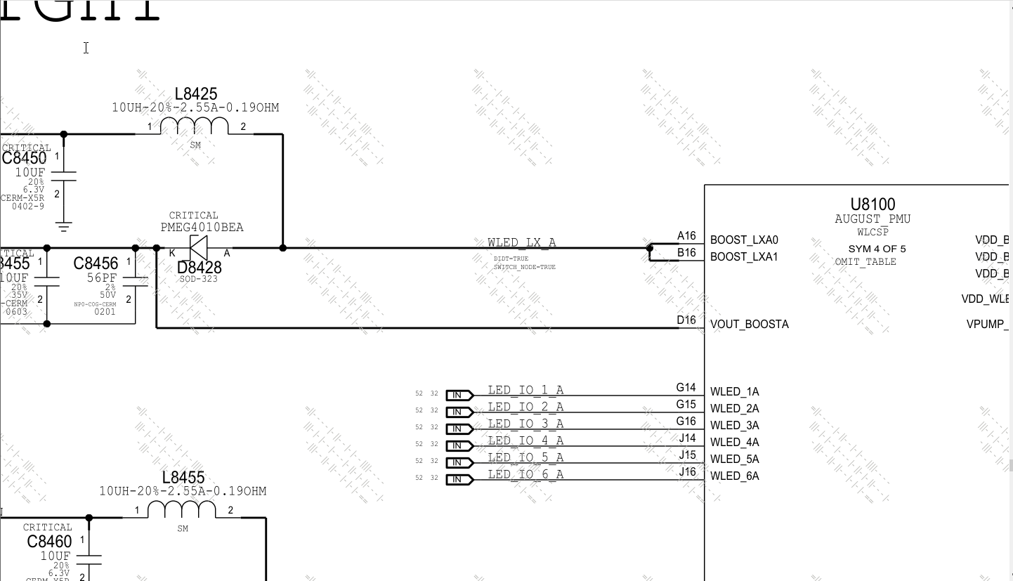

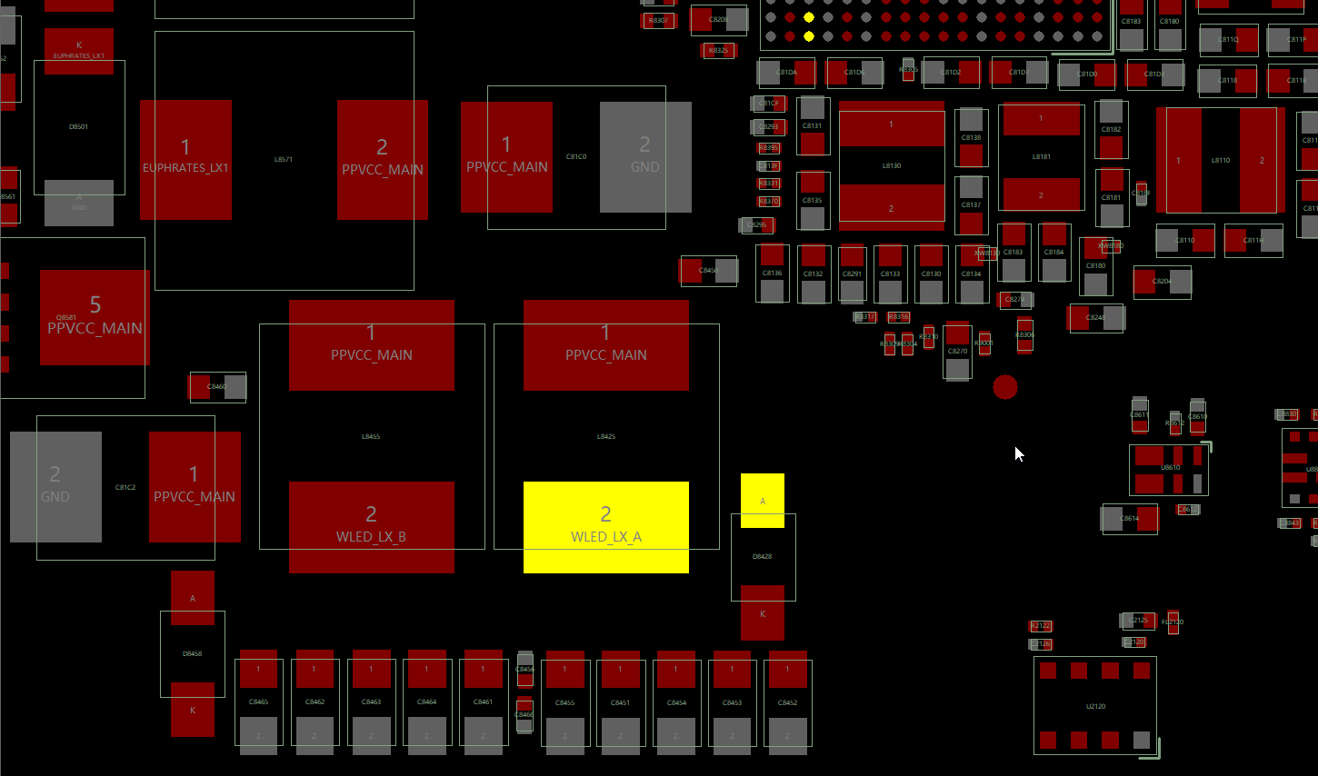

    Does anyone have schematic for ipad pro A1701?
    i need to find value of coil. or is anyone know where to buy?

    Re: ipad pro A1701 missing component
    There is no schematics for this board.
      You can compare with ipad air schematics.
      I think the coil you are searching is L8225 (PILE051D/4.7µH-3.4A-0.075OHM) on ipad air.
      Check the diode on the right it can be damaged.

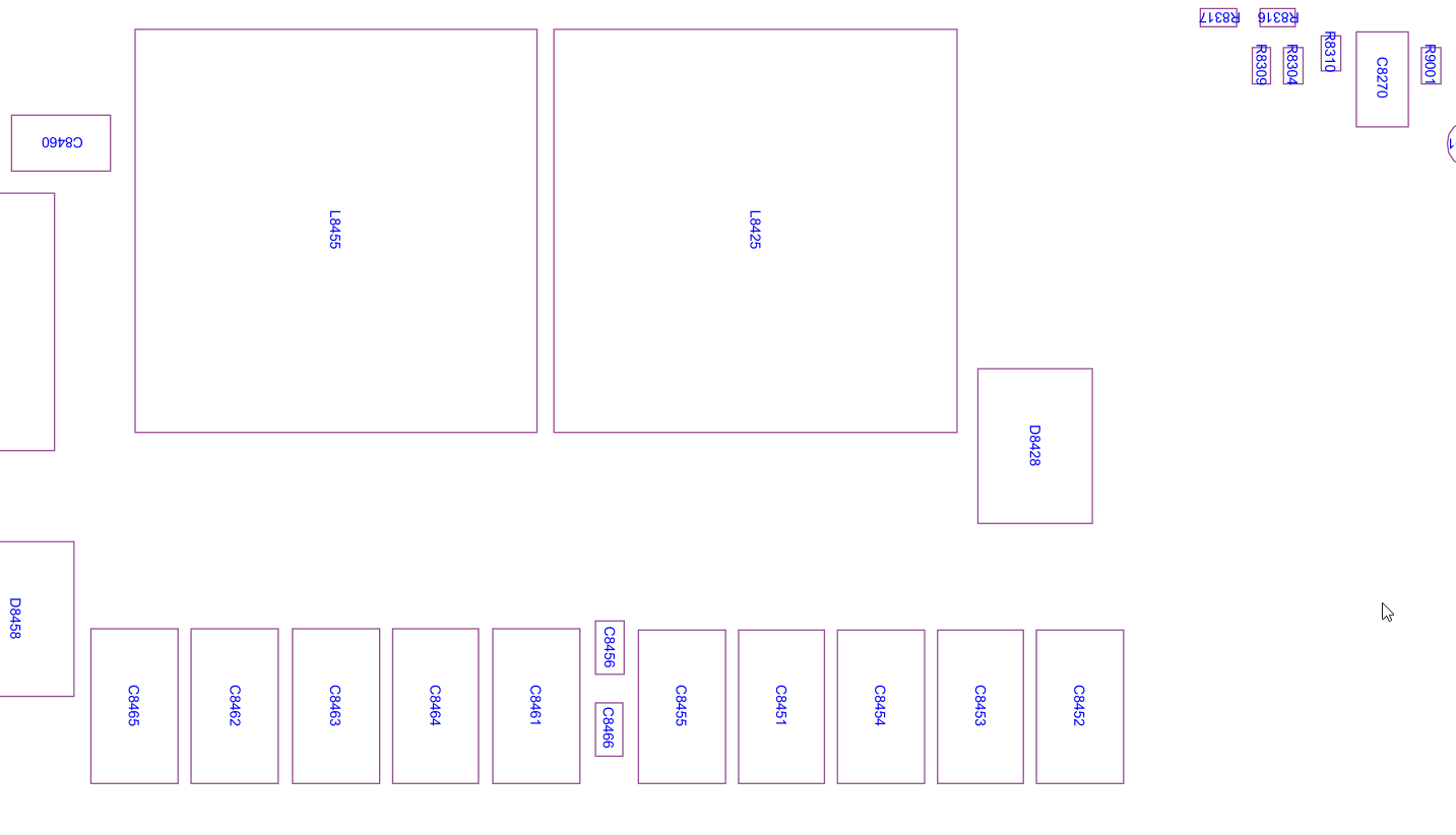

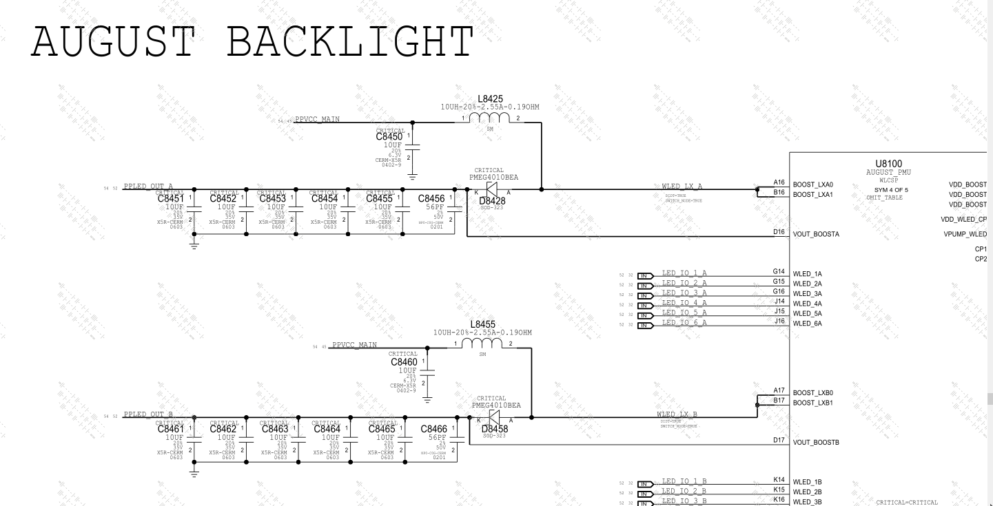

        Please see attached. Coil is p/n LF8425 = 10uH - 2.55A.
          thanks all, i used 4R7 from ipad 2 eventhough the size is bigger but it works. thanks again

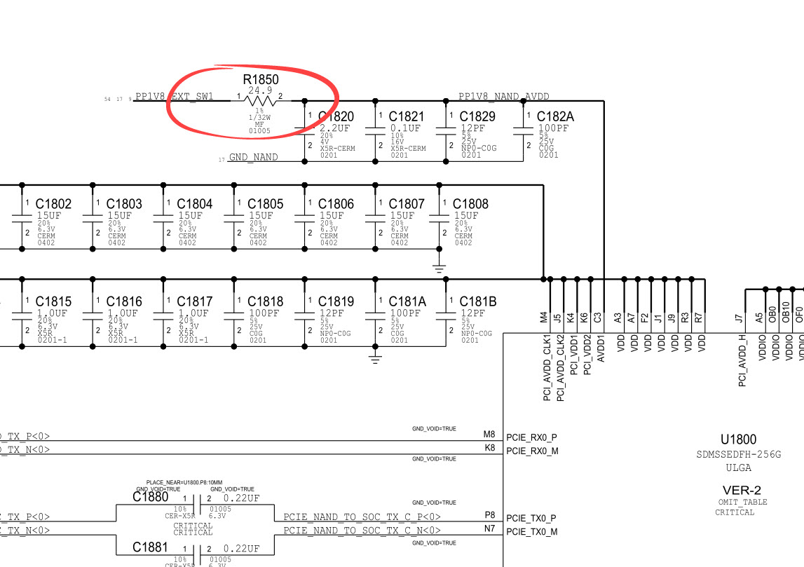

              Any chance you might be able to tell me the value of R1850?
              I was reballing NAND and had R1850 come off. Afterward as I was putting it back in place my boss starts yelling my name (FOR NO FUCKING REASON!!!) distracting me for half a second, and that's all it took for it to disappear
              Thank you very much!

                See attached. This is from an ipad PRO schematic - hope it is the same for your logic board.
                That is one tiny bugger - DK / Mouser / Arrow should have these = 01005 SMD size ? (OMG that is tiny)
                DK has them:
                https://www.digikey.com/en/products/...zDfin4hZNXy1AA

                  Thank you so much!! That is the exact right one. And yes, they're the smallest components used on these things, crazy little.

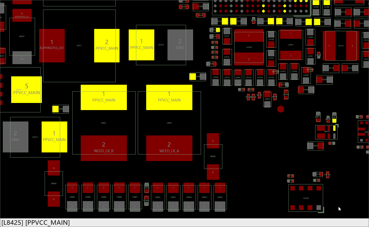

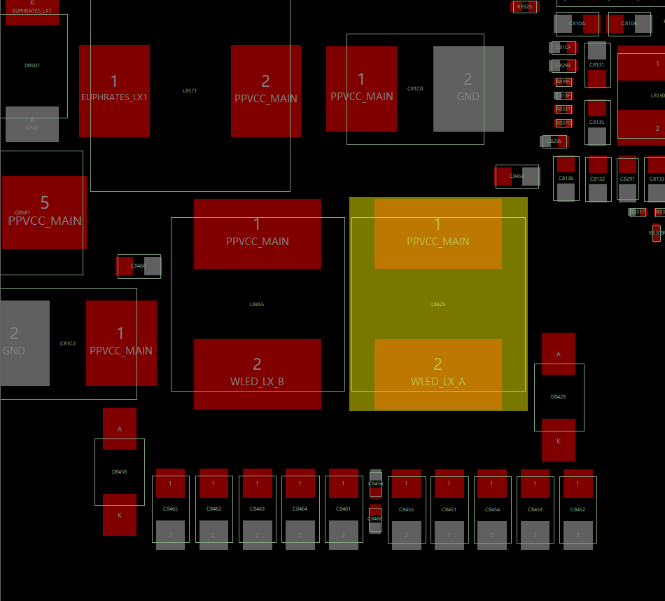

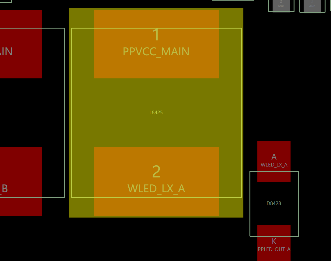

                    sorry to dig up this old thread, LF8425 = 10uH - 2.55A but mine measure around 4.4x4.4x1.3mm.. what package size is this? it doesnt seems to be 0420 or 0520?
                    Also, for L8101, I saw it is 0.22UH-20%-7.0A-0.018OHM, it measured 2x1.6mm, I guess that is size 2016 or 0806?

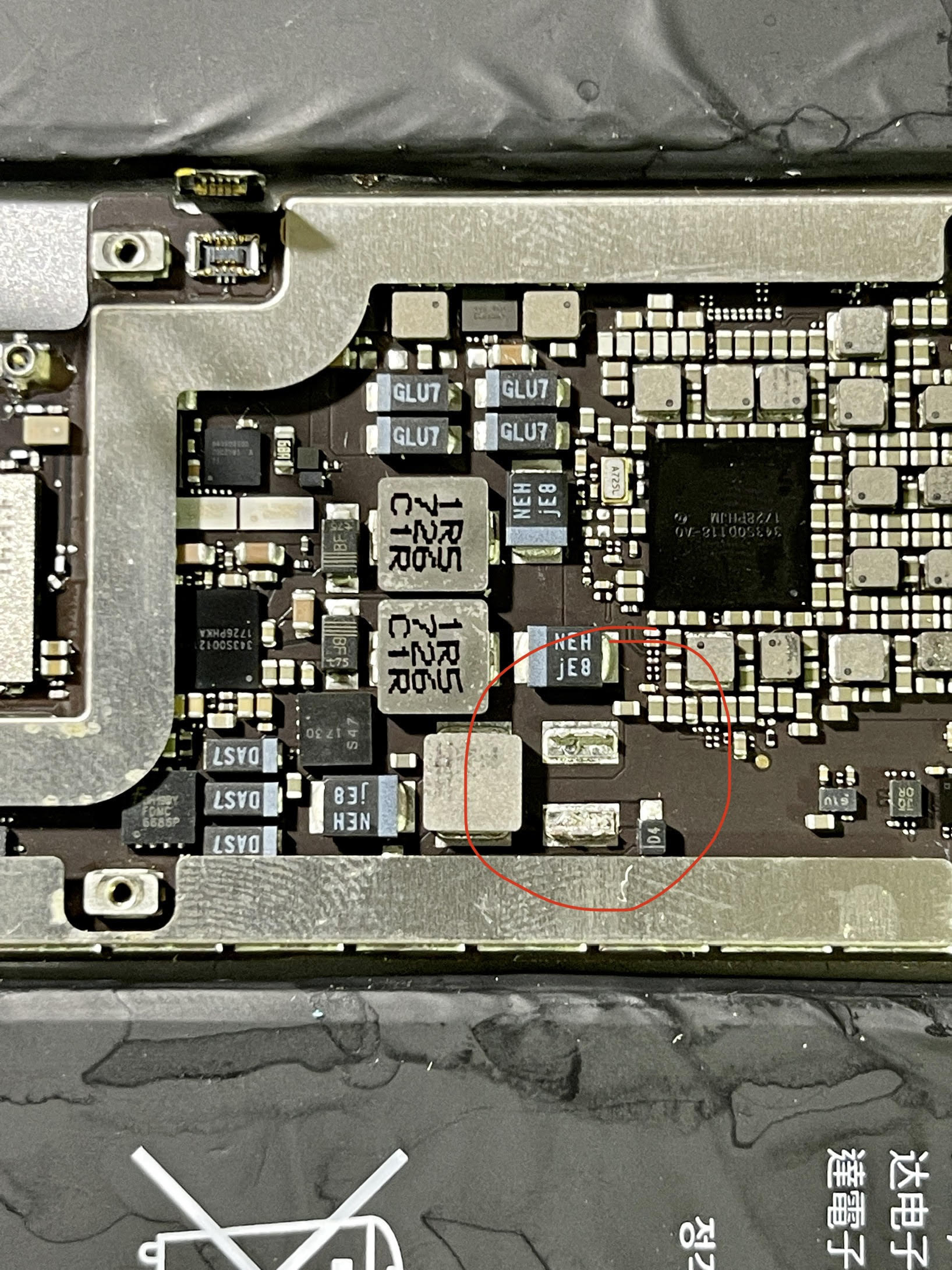

                      Manged to get a hold of an iPad Pro 11" 4th Gen however it does not charge and upon opening it looks like someone has tried to replace the port and knocked a component off but I cannot find a schematic or boardview for this model so was wondering if anyone could help identify what I think is a missing pad and capacitor? Looks like whoever was in here last tried to put it back on with hot air and melted the plastics too......
