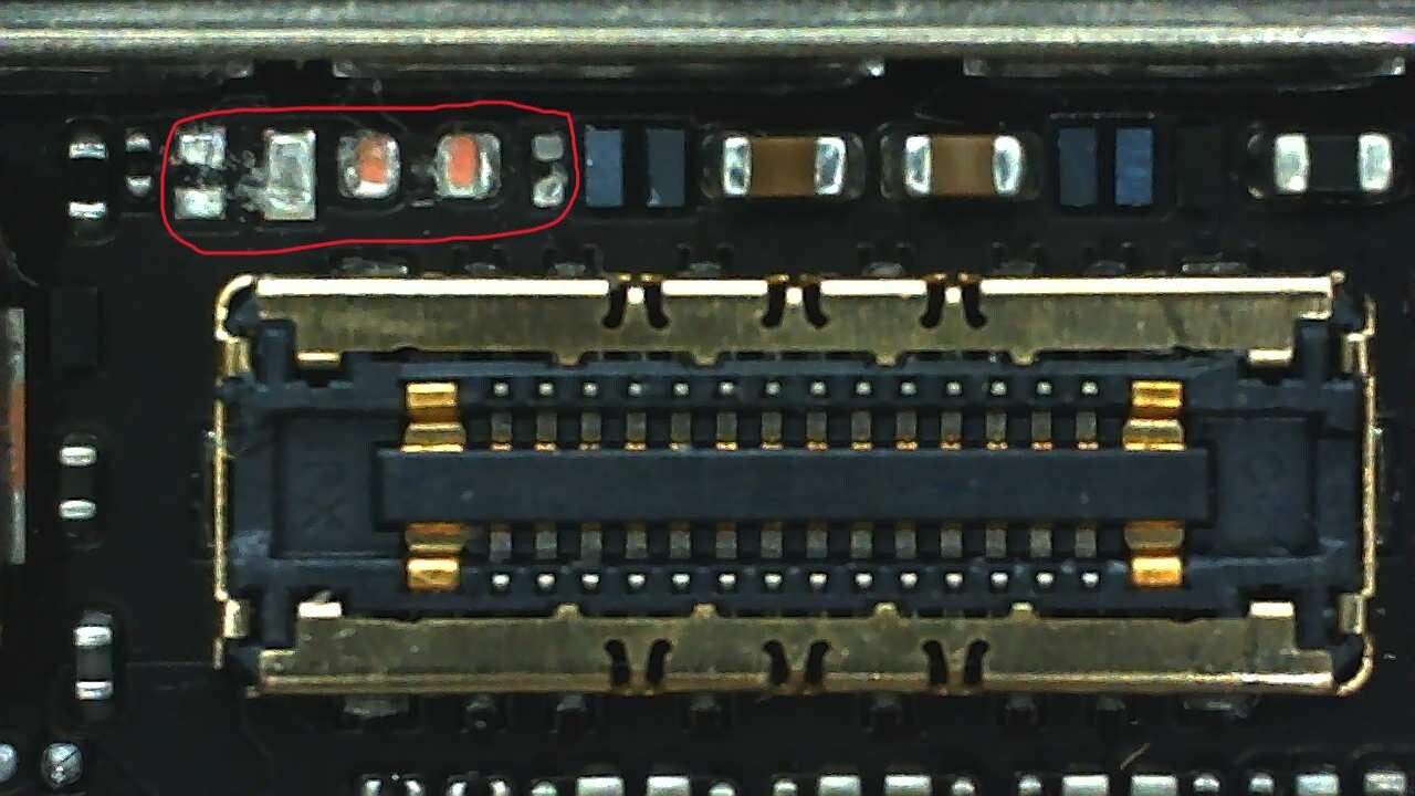

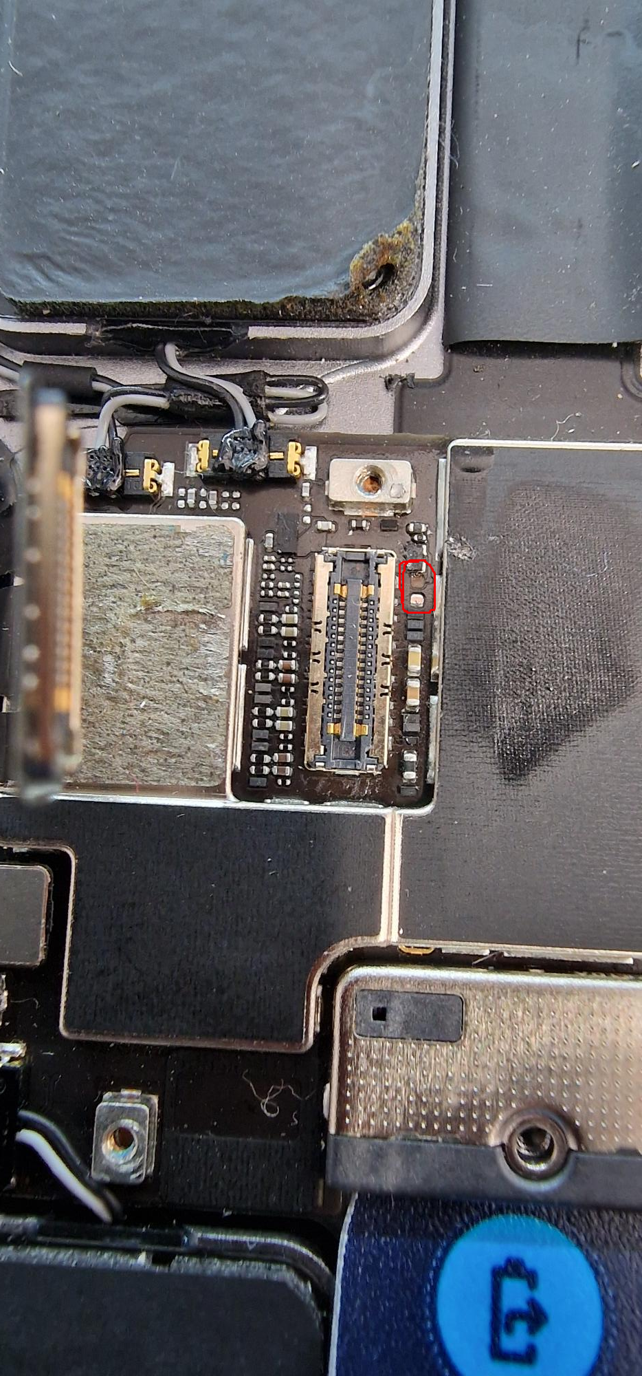

    iPad Pro 11-inch (4th Generation) A2759 - Missing component
    Manged to get a hold of an iPad Pro 11" 4th Gen however it does not charge and upon opening it looks like someone has tried to replace the port and knocked a component off but I cannot find a schematic or boardview for this model so was wondering if anyone could help identify what I think is a missing pad and capacitor? Looks like whoever was in here last tried to put it back on with hot air and melted the plastics too...
  • mon2
    • Dec 2019
    • 14660

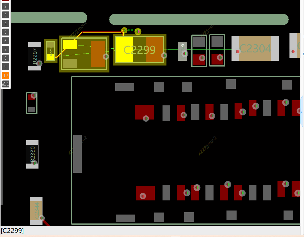

    Appears to be a capacitor from the bv file in my database but not sure of its value.

    • tccyo22
      • Oct 2019
      • 73
      Thanks, figured it might be. Just gotta find the value now, unfortunately don't have another one of these to check or pinch one from.

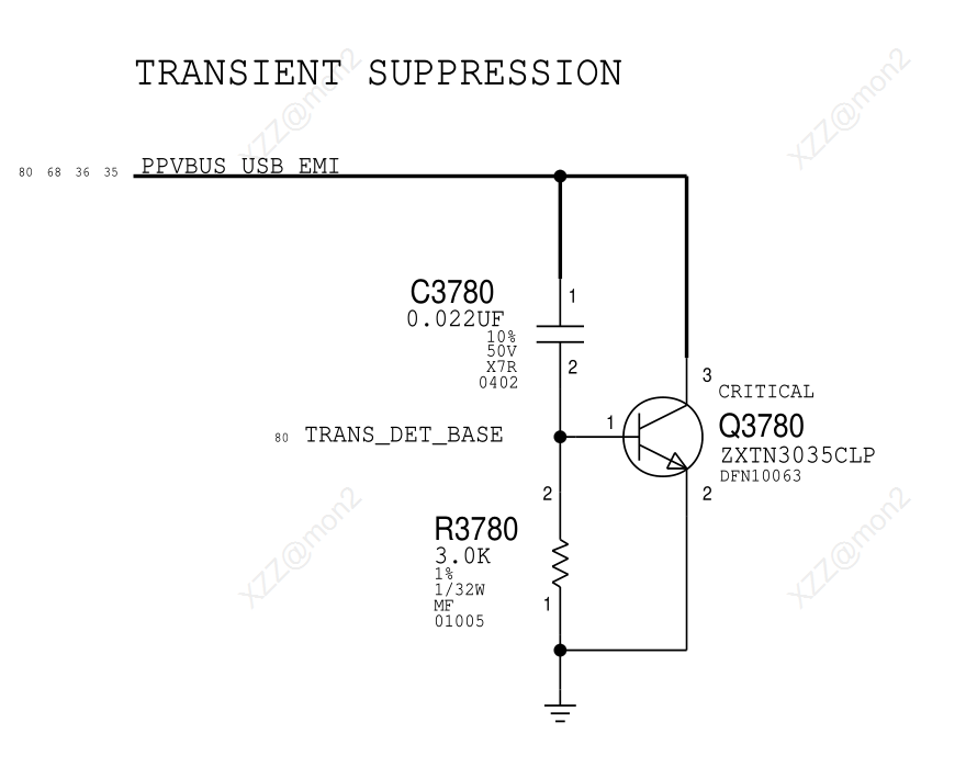

      • mon2
        • Dec 2019
        • 14660

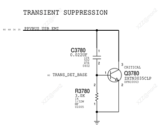

        Review other iPad schematics and boardview files to compare.

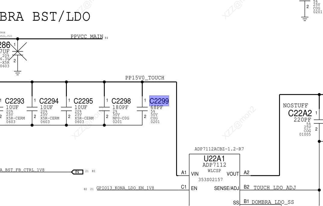

        • mon2
          • Dec 2019

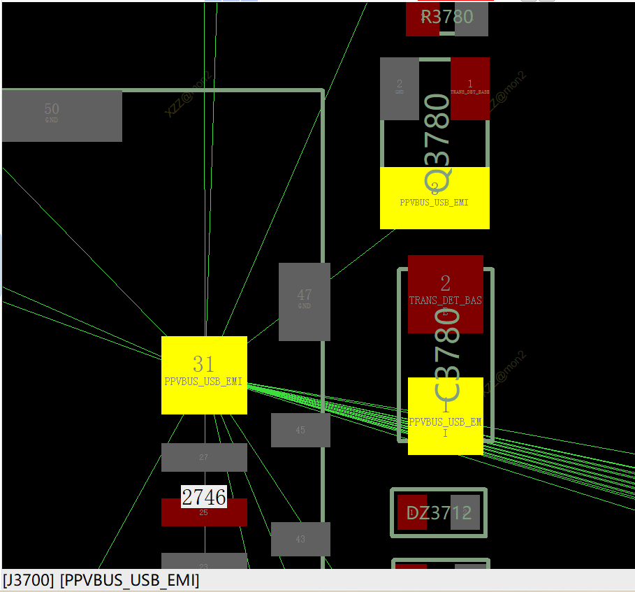

          • 14660
          Found it. Same parts; same reference; same location on another ipad with schematics.
          PS: Unless there is trace break, this part will not be missed if not replaced.
          Click image for larger version  Name:	same1.png Views:	0 Size:	30.6 KB ID:	3580050
          Click image for larger version  Name:	same2.png Views:	0 Size:	83.8 KB ID:	3580051

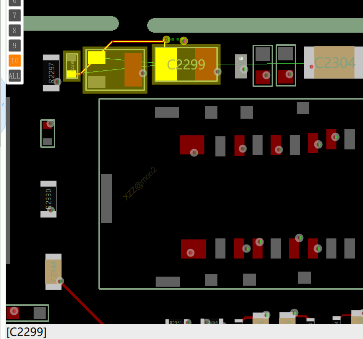

          • tccyo22
            • Oct 2019
            • 73
            Thank you so much for sharing this. The yellow pad is missing as well so I'm going to assume where that trace to the left isn't connected to somewhere that the line draws to the right towards what is most probably U22A1 (also very likely under the shield unless i can connect a wire somewhere else). I've got the iPad switched on and it seems to be mostly working aside from the lack of charging which is expected if a trace is missing
            • ElektroMatze
              • Oct 2025
              • 2
              • Deutschland
              I hope someone can help me too.
              It is also an ipad pro 11 4th generation A2759
              I received an iPad from a repair shop, and while replacing the charging port, they tore off the components shown in the picture. :-(
              What are these missing components?
              Can anyone help me with the circuit diagram and the names of the components?
              Thank you very muchClick image for larger version

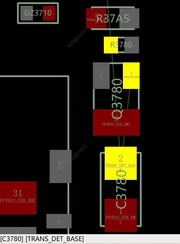

              • mon2
                • Dec 2019
                • 14660
                Looks the same as above pic. Review other iPads for the same region. Otherwise can review once at the office. Currently on the very lengthy return flight from Asia with an anticipated landing time of 2-3 days.
