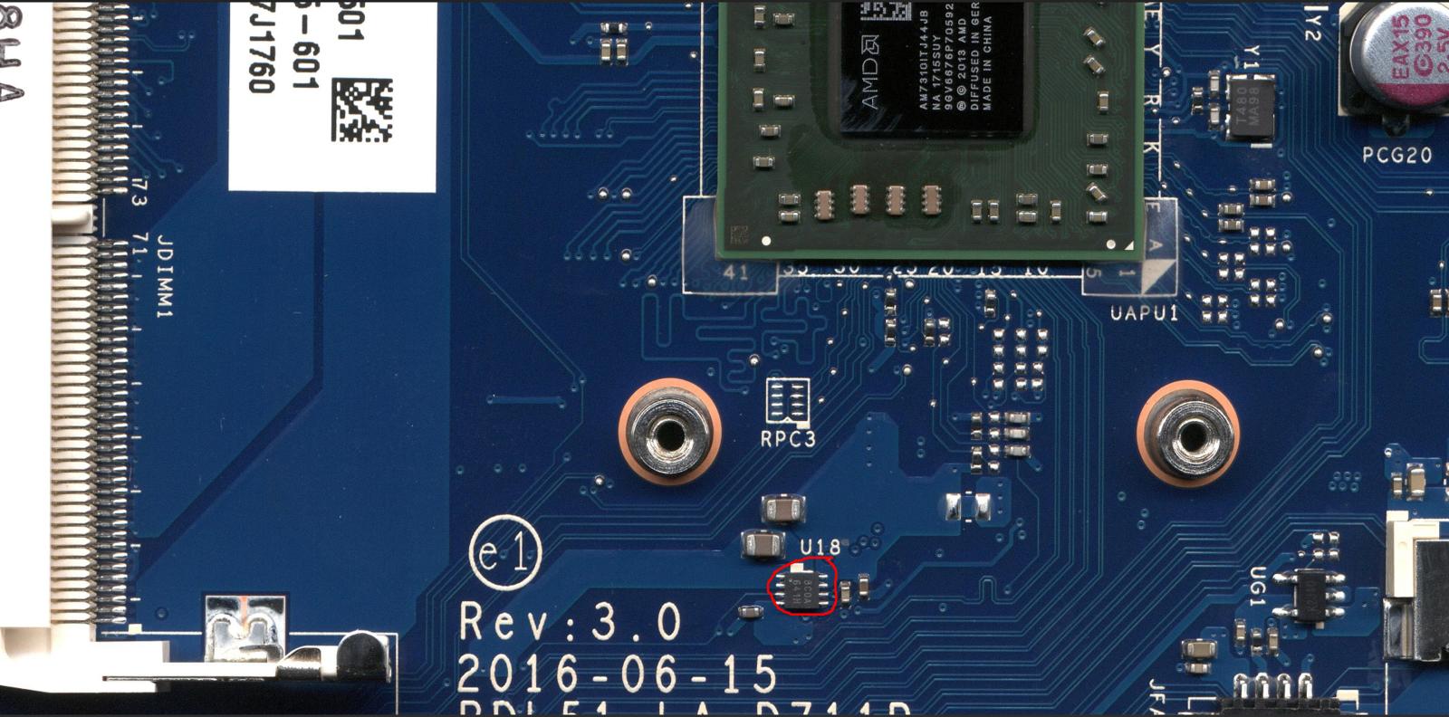

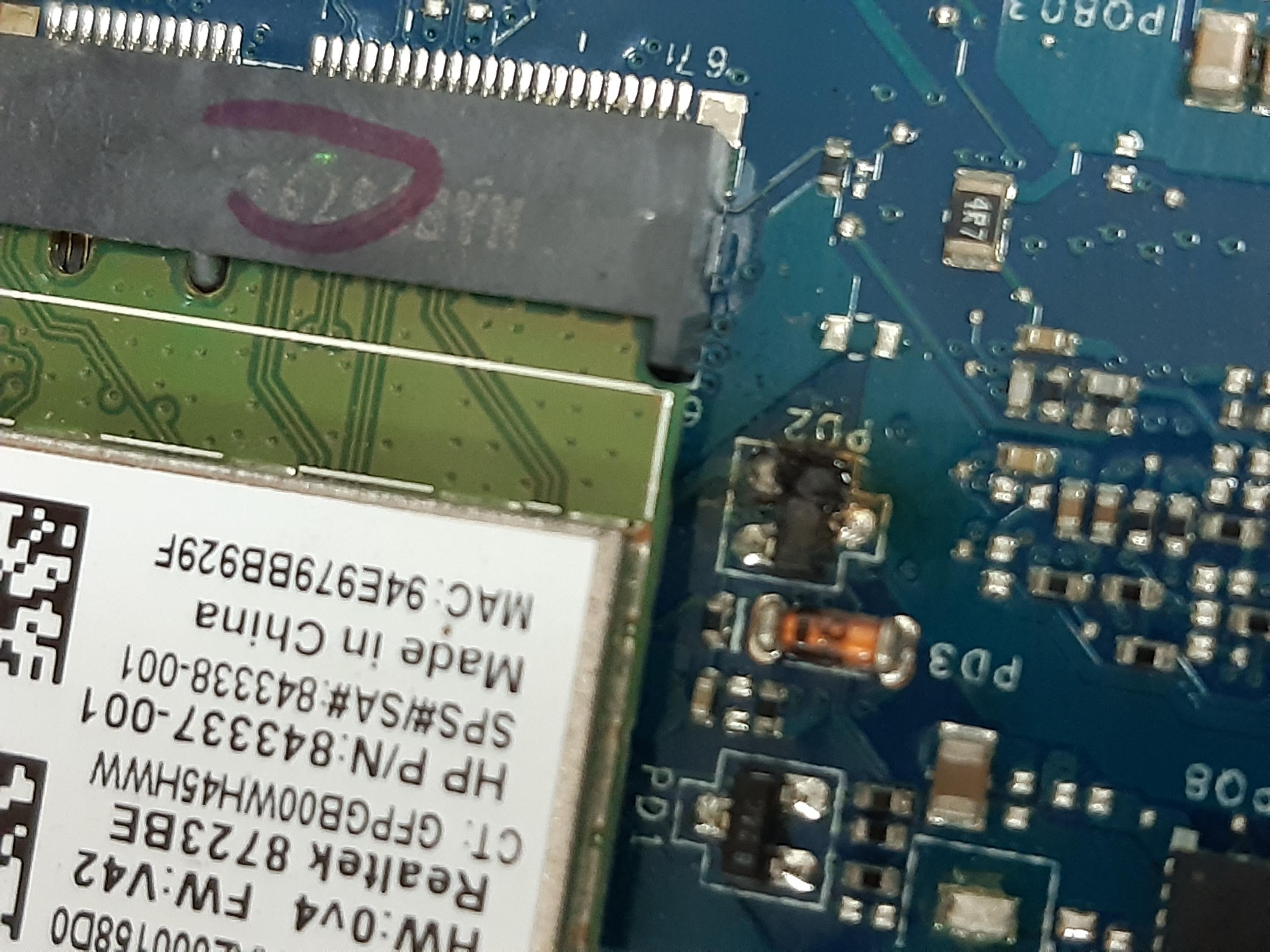

            Re: Hp LA-D711P motherboard Schematics
            Hi guys. you need to know what kind of element
            burned out.
            La-d711p rev:3.0
            • Jozef11
              • Sep 2020
              • 2
              • Slovensko
              Pd1-vc06c
              pd2-vc06c
                  bdl51 la-d711p rev 3.0 wiring diagram, schematics etc, needed if possible please guys.. appreciated :-) wanting to locate some more info on an ic located at pu2.
                  • mcplslg123
                    • Jun 2015
                    • 7262
                    • india
                    PU2 is RT8243AZQW

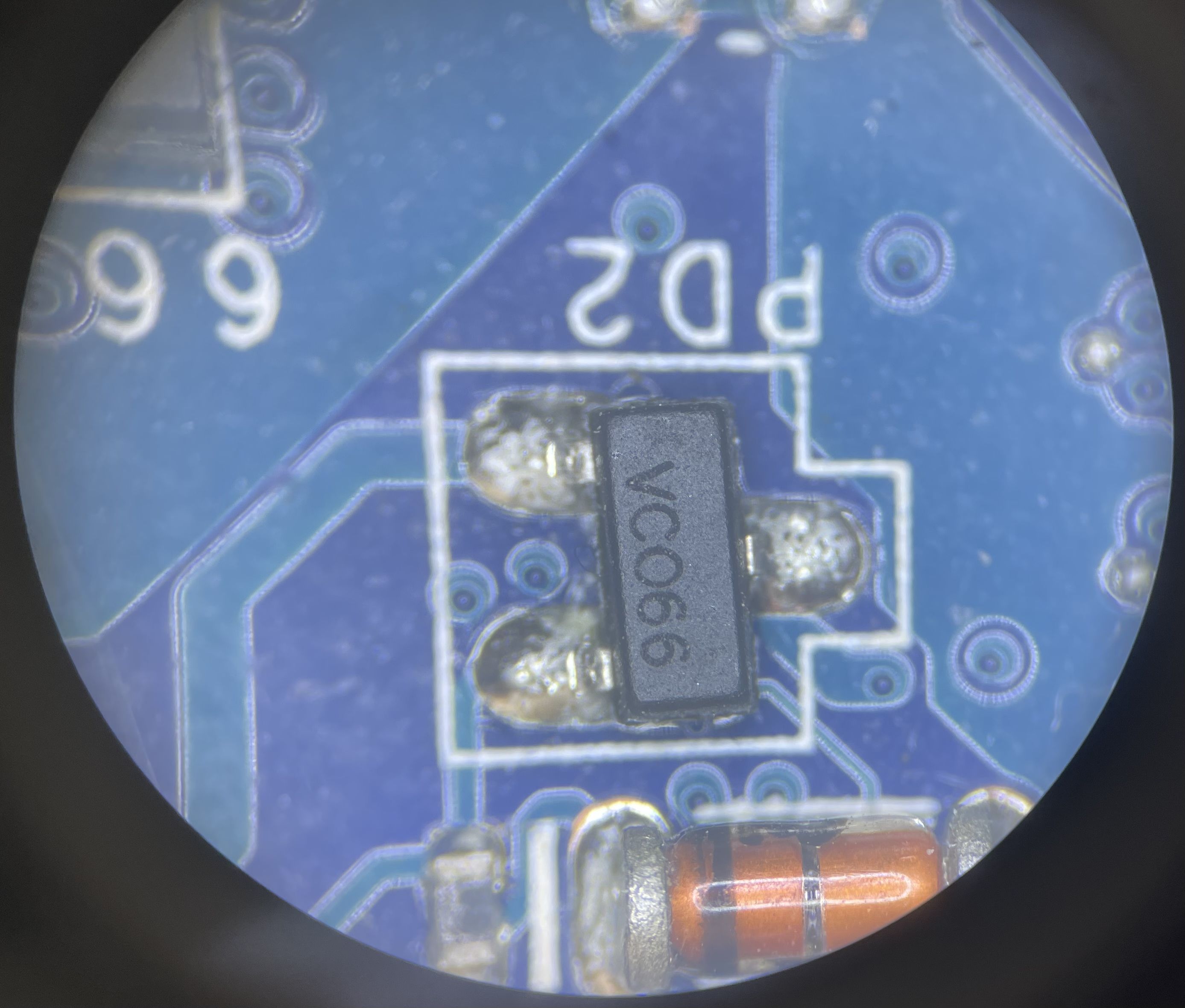

                          • kurt Brown
                            • Jul 2015
                            • 3
                            • belize
                            VC064 is the number printed on this part... its a dual diode
                              • skynet83
                                • Feb 2021
                                • 2
                                • Россия
                                This
                                  • 21841
                                  Originally posted by skynet83
                                  This
                                  AOZ1336DI
