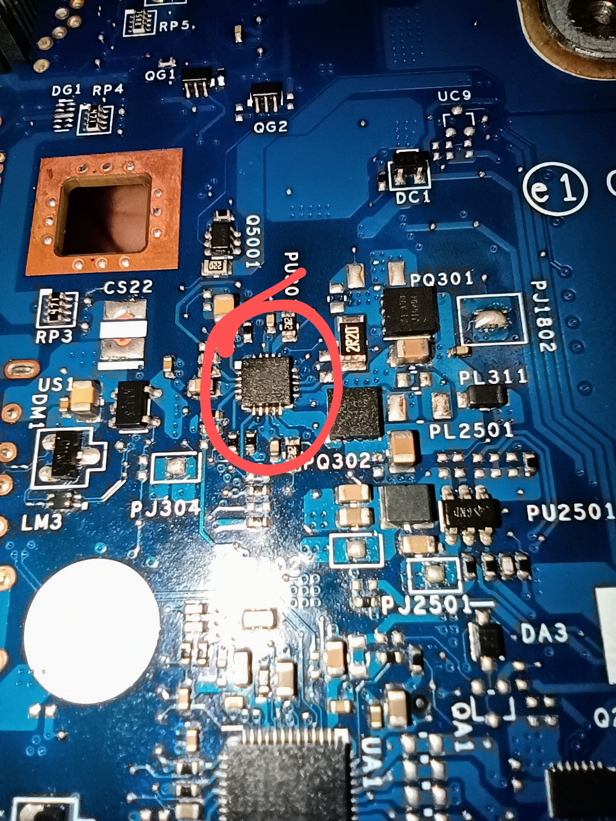

                                  Hp 15 bs015nia - LA-E791P
                                  Hello everyone 👋, can someone please help me the schematic (motherboard view) of the CL50 E791 HP 15 bs015nia? There's this ic 1275c that gets very hot

                                        Re: Hp 15 bs015nia - LA-E791P
                                        That IC itself might not be bad , it generates both 3.3v/5V PWM and LDOs , the components it supplies to might be bad, Most probably the KB9022 on the +3V rail.
