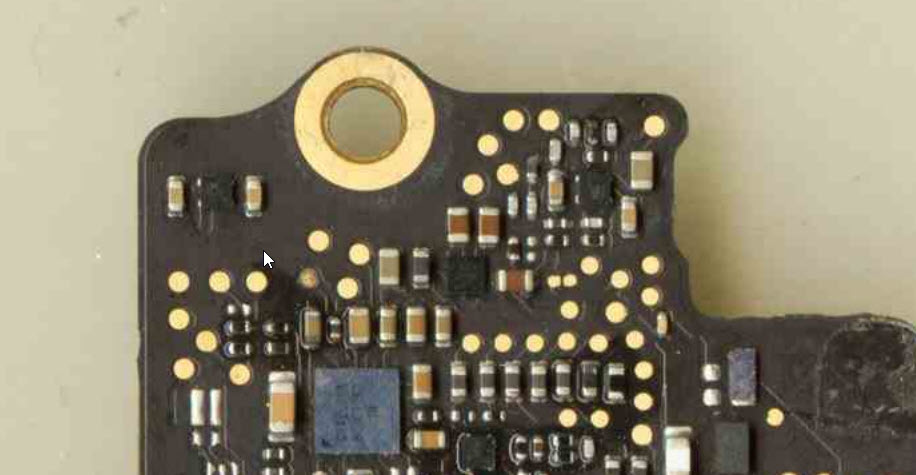

                  • ekkakon
                    • Mar 2025
                    • 2
                    #29
                    Originally posted by gizaha
                    Re: 820-00928-a Schematic needed
                    Thanks for the files but 820-00928-A is different than the boardview posted here.
                    You can check here https://logi.wiki/index.php/MacBook_..._composite.jpg
                    in the upper right corner, there is an extra capacitor next to c4912.
                    The specific extra capacitor is shorted on mine.
                    I do confirm this schematic is not matching A1707 820-00928-A board.
                    Already found few "missing" components. 🀣 Most obvious one is U5700 which clearly is not soldered on my 00928-A board.
