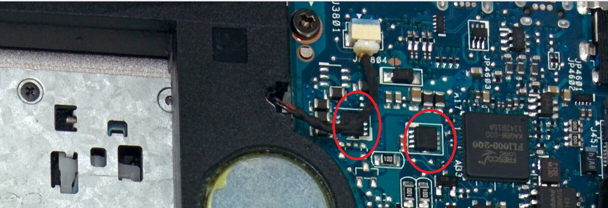

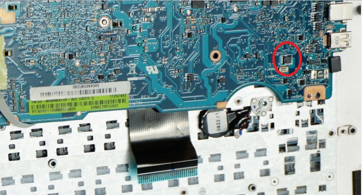

    hi plz i need reference for these mosfet
    ( n channel or P channel)
    motherboard Asus reference
    UX31E main board rev 3.2

    What are the part numbers on top of the mosfets

      Re: i find the reference mosfet
      have u the schematic ?
          No i don`t. I can`t find one for free, so unless someone else uploads one you`ll have to pay . ********************************
            Use UX31A2 schematics. Boardview of UX31E available at sualaptop365.
              how i can open this file .fz
                Use OpenBoardView with FZ key (you can grab it from the IRC channel topic) or use PCBRepairTool (which is a pain to use).
