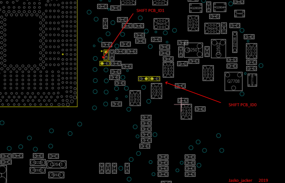

                    Do you have any instructions on how to disable RAM directly for X751LD rev. 2.0? Thank you, I found only for X751MD

                      I have a lot of documentation about how to disable... This board use two signal to manage the ram onboard , PCB_ID1 and PCB_ID0 as on X751MD you can try to swich the resistors.
                      Report if it works with the original resistors place
