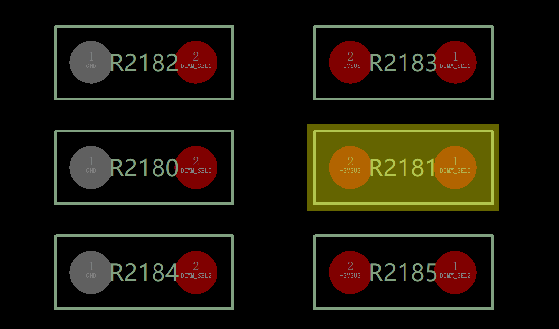

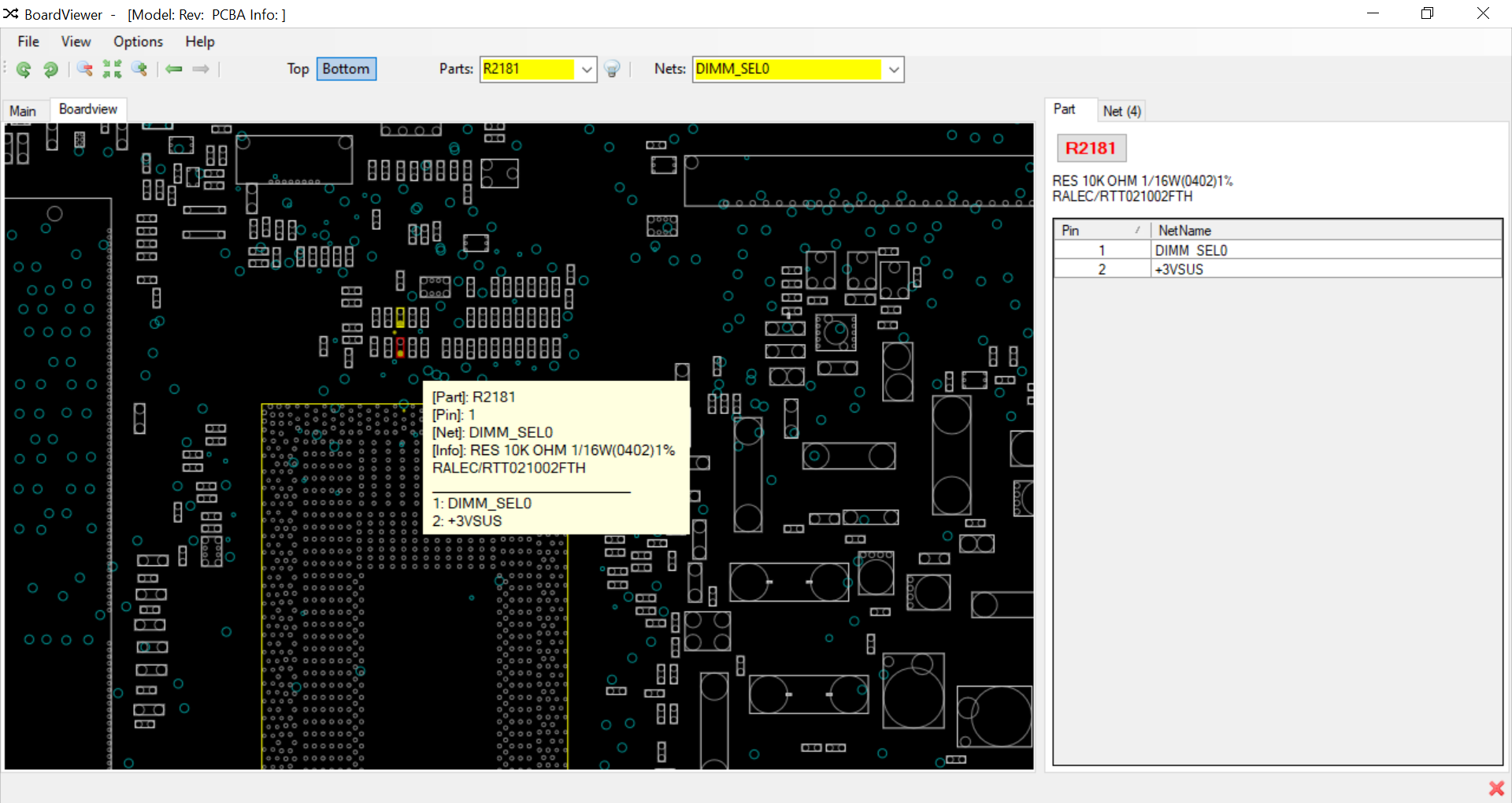

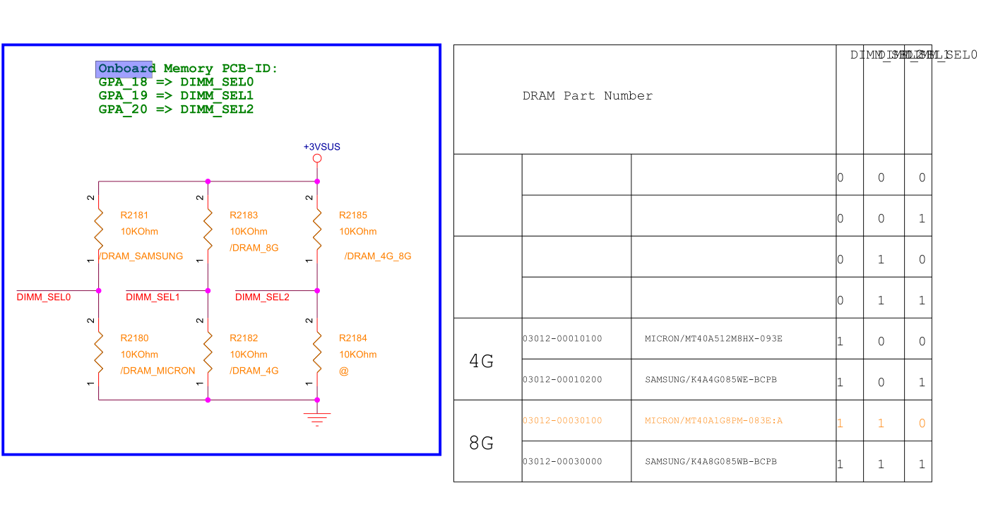

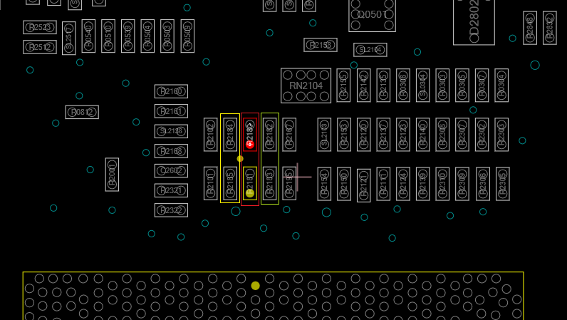

                Just swap the 10 ohm resistor's position!

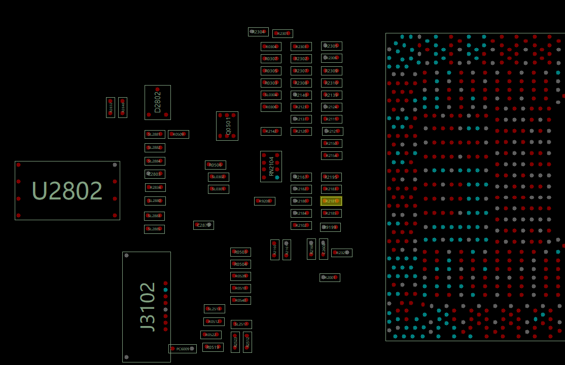

                                      See attached. Is this what you are requesting ?
