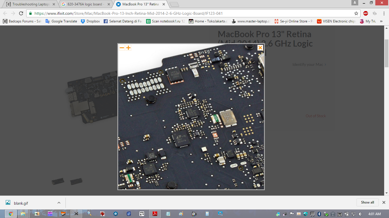

    Hello
    does anyone have the schematics and board files for a Late 2013 Macbook Pro 13".
    It is a A1502 with 16gb of ram and an i5.
    There is some corrosion around the battery charger circuit. The board does not turn on neither does the charger LED turn on.

    Re: Schematics and Board file for a Macbook Pro Late 2013 - Water damage
    Try identifying the board's part number as in 820-xxxx something maybe we can help you that way!
      Should this be on the board?
        Look here, might be suit for your board

          Thanks! But I am still not sure which board I have do you know how to find out?
          A1502 820-3476-A seems to be correct. But I have a 16GB Ram Version and different CPU I wouldn't think they have different layouts for this... But maybe there are different board revisions? Anyway if anyone knows how to find out for sure would be nice.
          But according to A1502 820-3476-A I am missing R7102 and C7150 from the board. There is not even any residue. It looks like there was something but those 2 are completely wiped off the board. Everything around U7100 was corroded - but that was the only spot.
                    Try look here:
                    https://www.ifixit.com/Store/Mac/Mac...oard/IF123-041
                      Ah thanks. So it is indeed the 820-3476-A I guess.
                      lets order some parts then. Meanwhile I found another bad looking capactitor will replace it right away.
