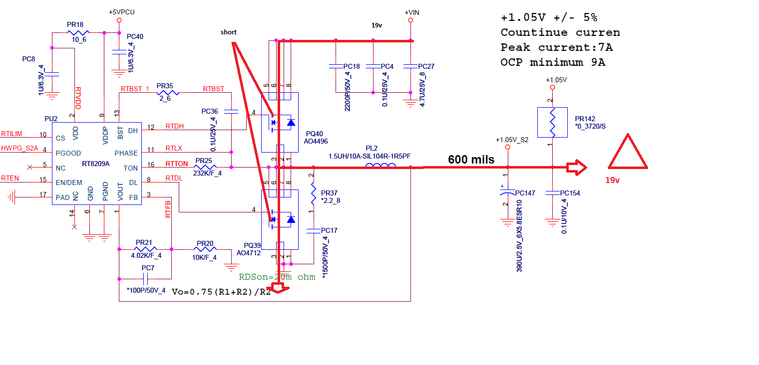

                                    • meritosari
                                      • Oct 2010
                                      • 774
                                      • Indonesia
                                      Re: hp 8460p schematic please guys
                                      Originally posted by atsio
                                      You still do not get it. Usually the drain of upper fets on voltage regulators is on the 19v rail. If the fet is open and you inject 19v on the 19v rail, 19volts end up on the source rail of the fet (whatever volt is that).
                                      do you mean like this? (see attachment)
                                      Originally posted by rievax_60
                                      Well done.
                                      Also that is why I sometimes say to not apply more than 1v test when finding a short. There might be a shorted High Side MOSFET sending the test voltage directly to CPU, NB or GPU.
                                      its nice you share what you got from your knowledge
                                      • atsio
                                        • Oct 2013
                                        • 819
                                        • Greece
                                        Yes, and even more dangerous having a half dead fet and testing it looks fine but when you apply high current-voltage dies completely.
