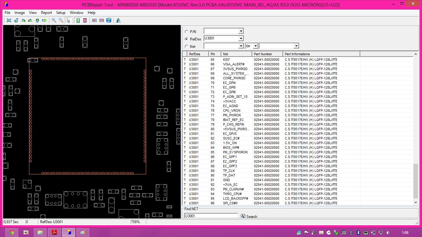

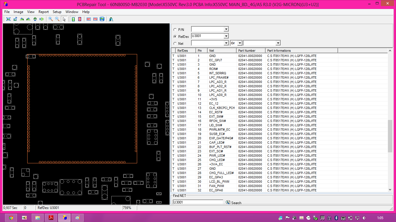

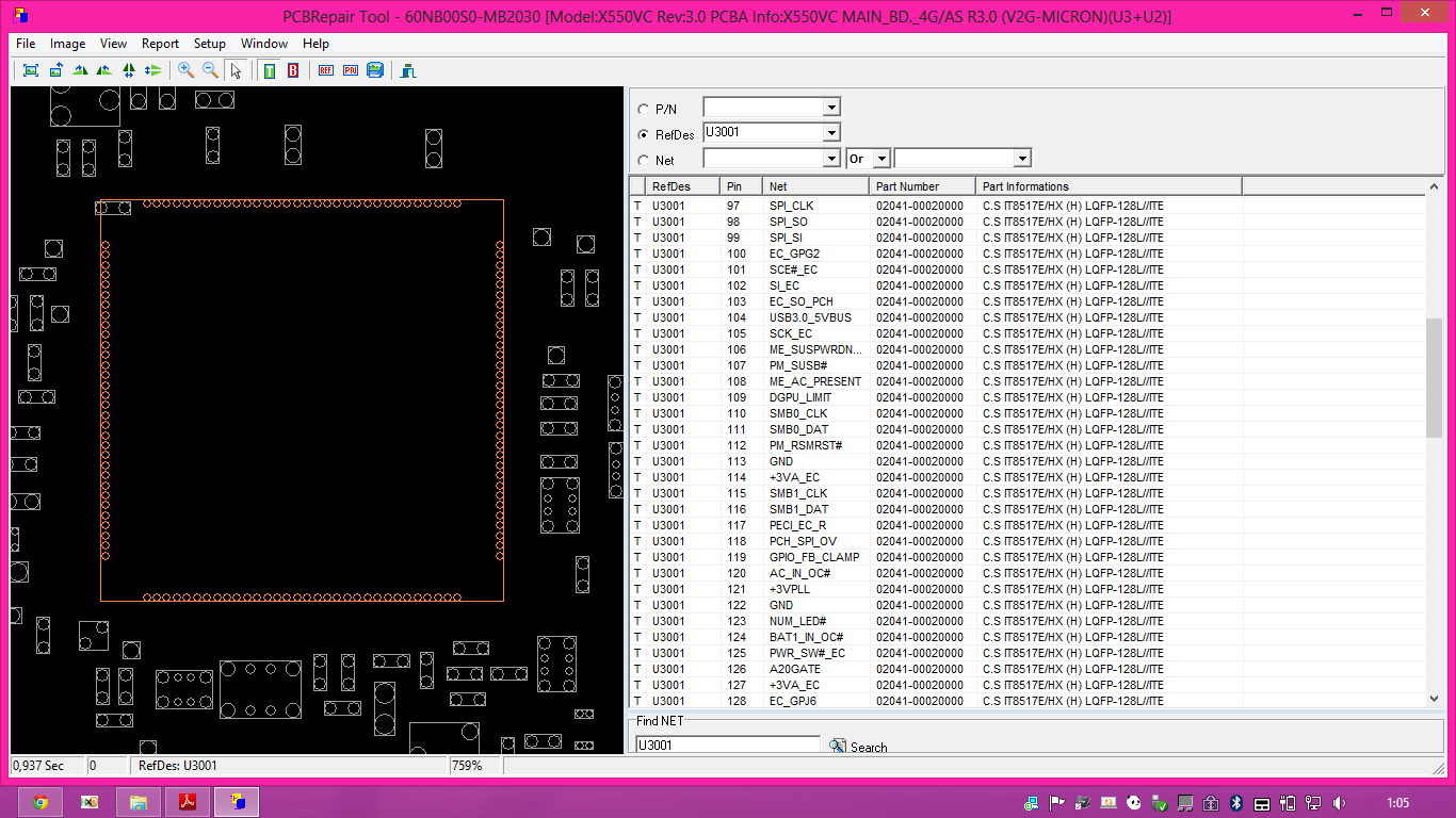

                        Re: Asus F550C schematic needed
                        can anyone had this boardview to the forum please , since there is no schematic , i need to know pinnout for IT8517E
                        thk in advance
                          screen shoot:
                            meritosari thank you , can you share the boardview ?
